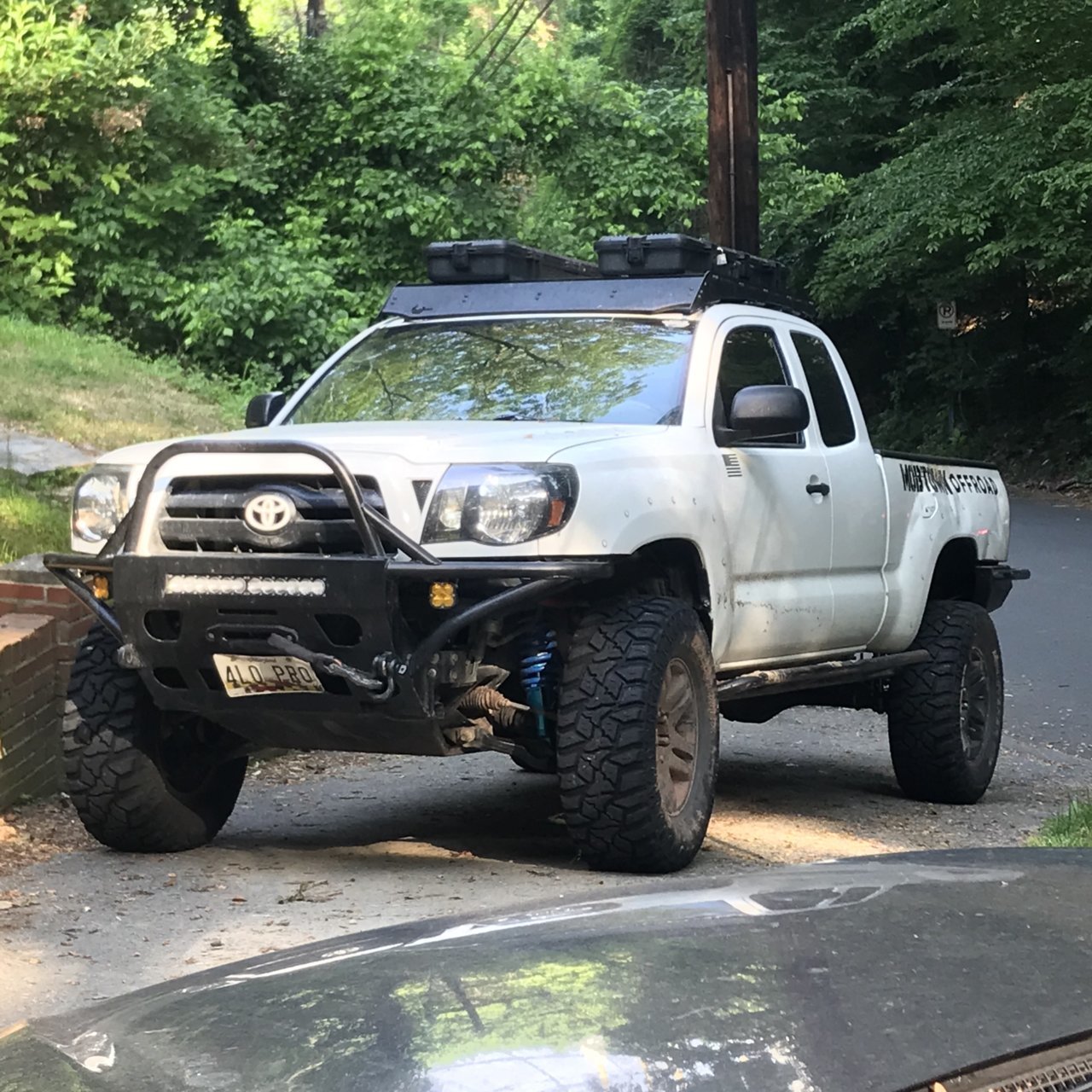

    Fiberglass fenders. But those would likely look pretty goofy without long travel.
    Attacking it with a saws-all is quick and easy, but if you take your time and cut small amounts at a time, it will look fine.
    Just a random TW pic I found:
    irayfz6 likes this.
