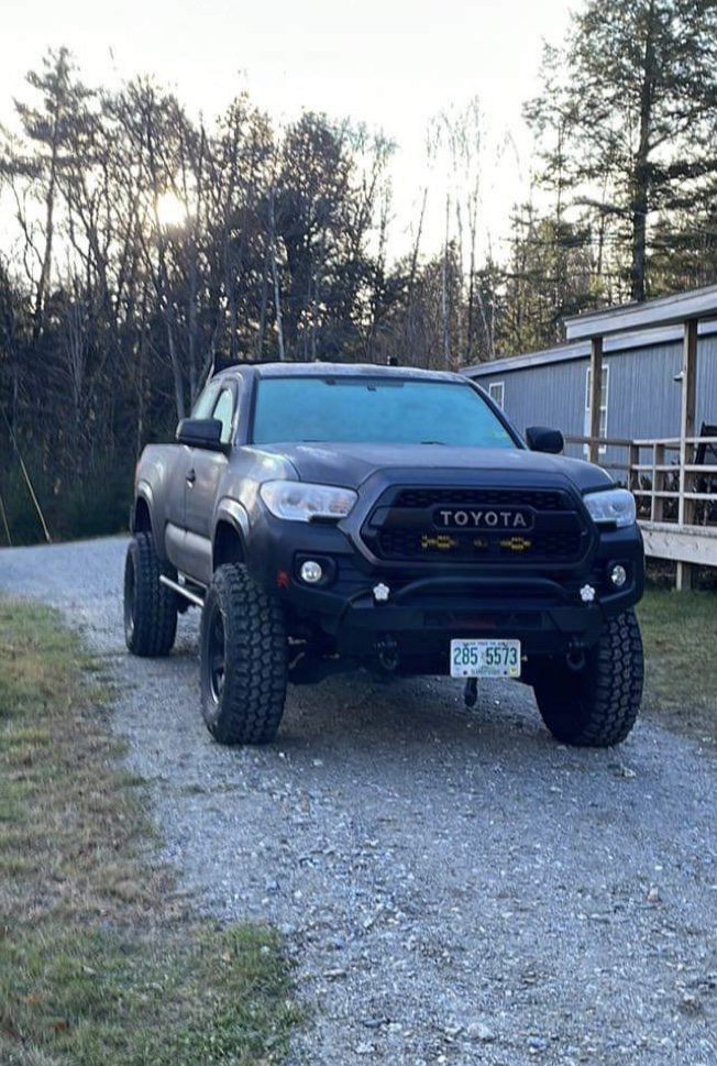

    16UTILITY4x4MT2.7
    K&N 63 series CAI, AVS Vent Visors, 16x8 Level 8 MK6 Rims, 285/75/16 MT, Eibach Pro lift, JBA UCAs, Wheelers 3leaf AAL, DV8 skidplate, Westin bedmat, Backrack, swaybar delete, Magnaflow cat-back, 9Drive throttle controller, 2LO Mod, Cali Raised Rock Sliders, Tyger rear bumper, Chinese Body Armor front bumper clone, 10K pound Winch, Smoked headlights, LED Bulbs.
    yes i do. And im on 285 75 16 , Winch, bumpers, sliders etc
    Road_Warrior likes this.

    Nice rig man this is what I’m looking for did your truck require a regear and is it alright on the highway

    Sucks on highway, i generally cruise 65 4th gear. Steep hills and on ramps i am pedal to the floor and giving it everything.Any hills kill momentum. Tolerable otherwise. I have manual tranny, stock gears, intake, exhaust, throttle controller. I am already planning out larger tires down the road after these.

    Hey I looked at the plate you’re in New Hampshire as well so I guess you know how the hills are here what lift are you running and are you rubbing at all

    Eibach, bodylift, 1/4 spacers, AAL w OL , Swaybar delete, CMC Fender trimming

    Was the cmc necessary if not doing heavy off-roading
