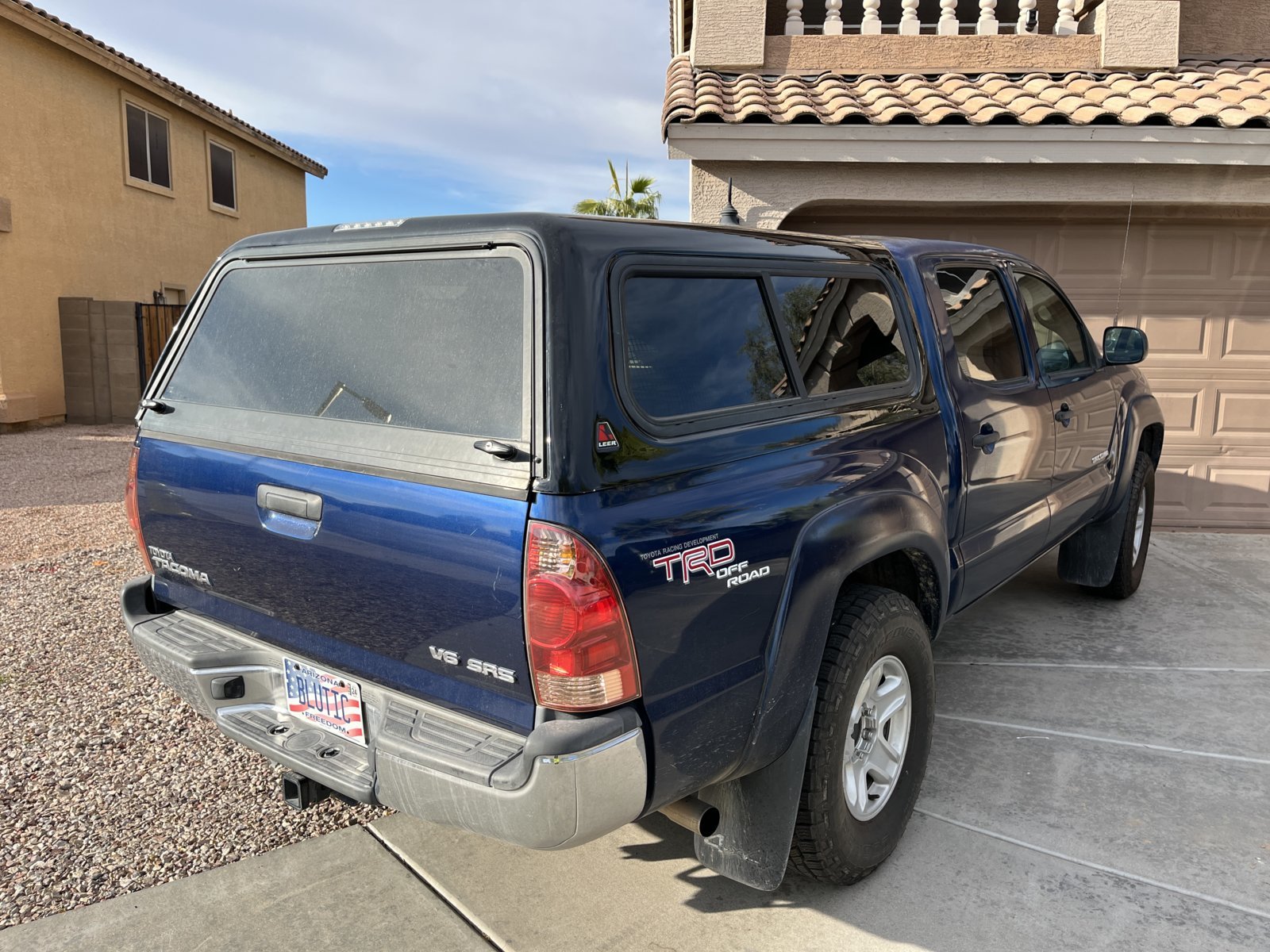

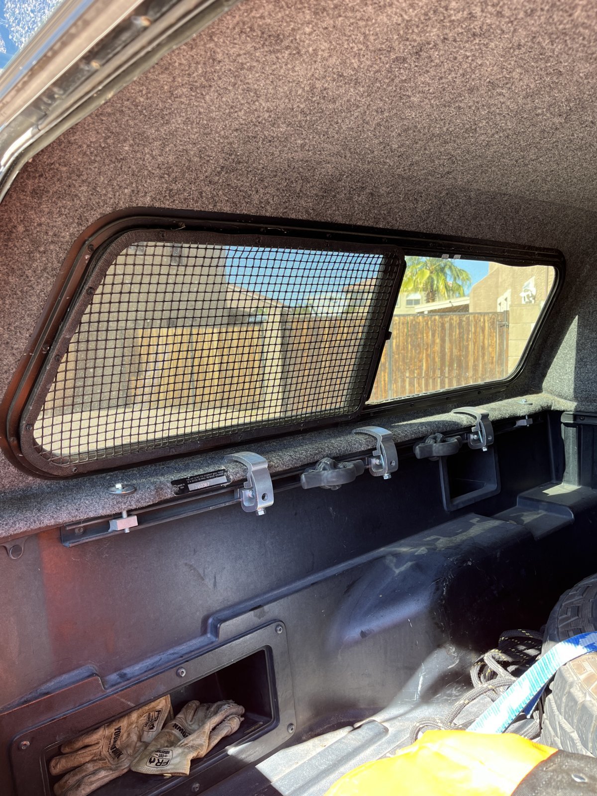

    Just bought this used Leer truck cap and have a couple questions about mounting, with this style of mounting brackets specifically. The bolts turn but never become snug. I’m afraid of tightening them to get them snug and end up breaking something. Any insight would be helpful. I have already ordered replacement locks and struts for the rear door, but I am also looking for the gasket/seal that goes around the rear door area, if anyone has information on that as well. Thank you

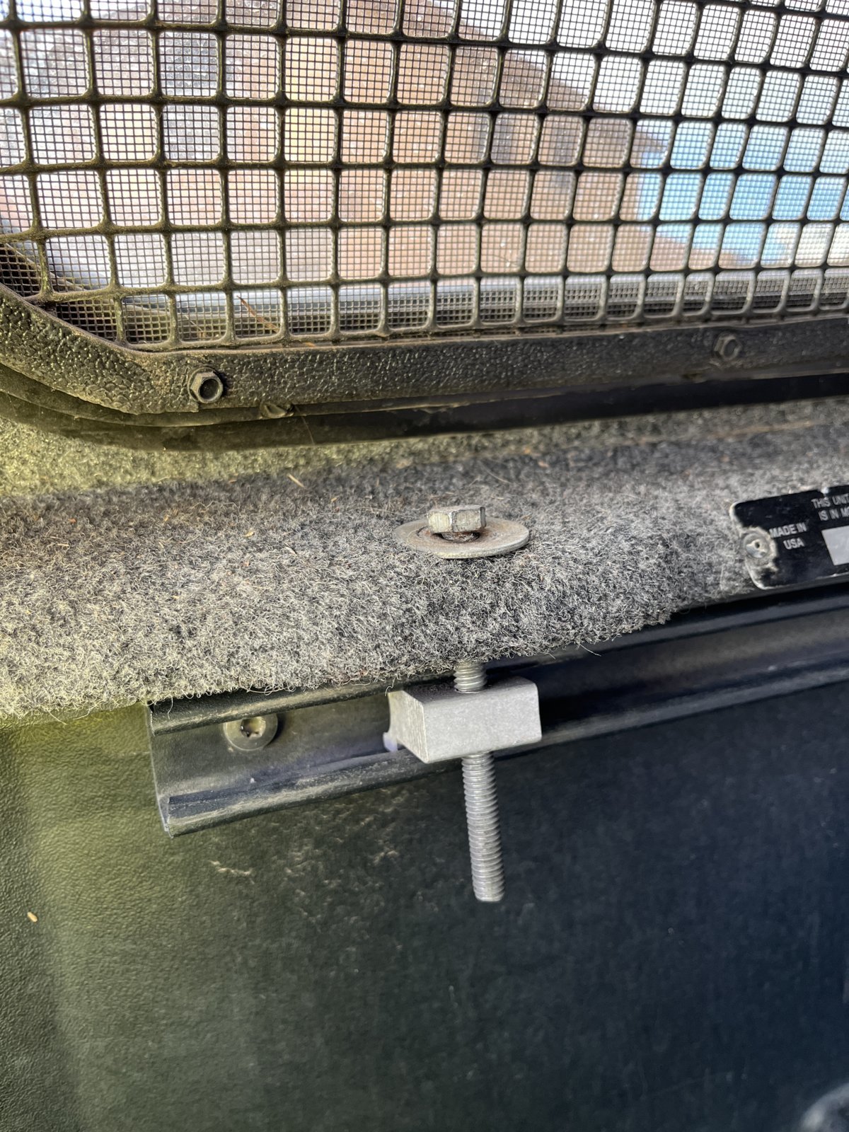

    I saw this photo in the reviews of the clamps mentioned above. The review said his cap had slid off prior lol. I think I’m going to double up on clamps just like in the photo

    It’s because they are tightening against a fibreglass flap which starts to bend at a certain torque.
    don’t overdo it or you will crack the fibreglass! I get the bolt tight enough that it won’t rattle then add another couple turns.

    That's the nature of these fiberglass caps. Tighten the bolts down just until the fiberglass starts to bend down and then stop. Check them every few months.
    Those c-clamp style ones won't fit your cap. Those are for the aluminum ones

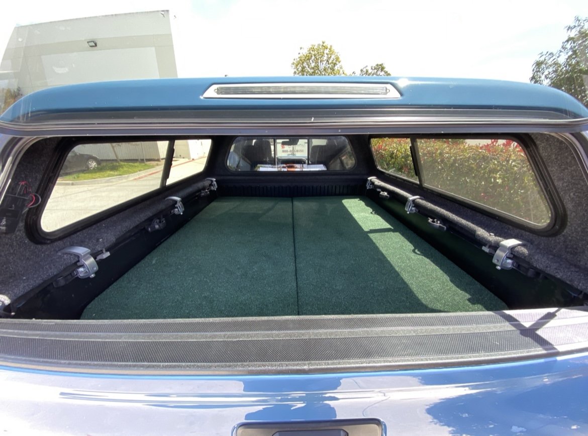

    Here's what I did on mine. I got two pairs of the C clamps -- one pair went in the middle, on the sides, and the other pair went along the front. This reinforced the four OEM bolts. The topper hasn't moved in three years.

    Those API clamps worked great. I used all 6 (3 on each side). I would have put two up front but my cap does not have enough of a lip to clamp onto. It’s probably way overkill but I’d rather have the peace of mind knowing it’s not going anywhere
