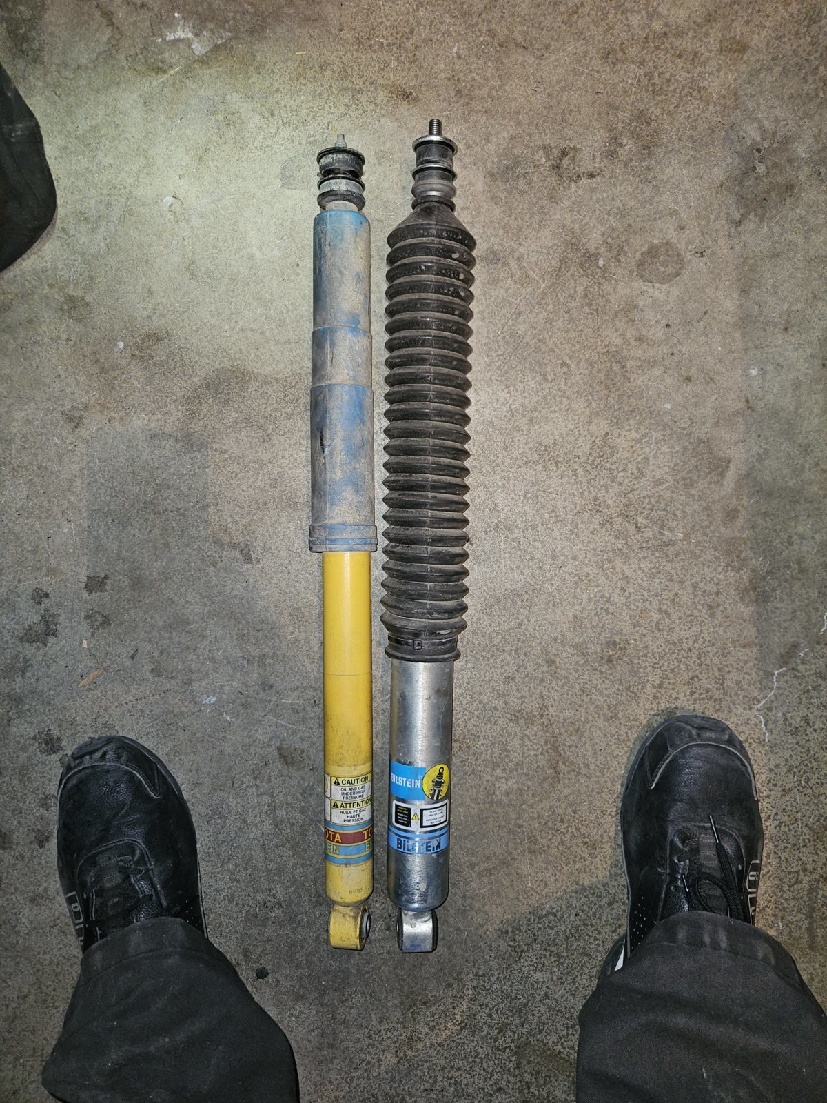

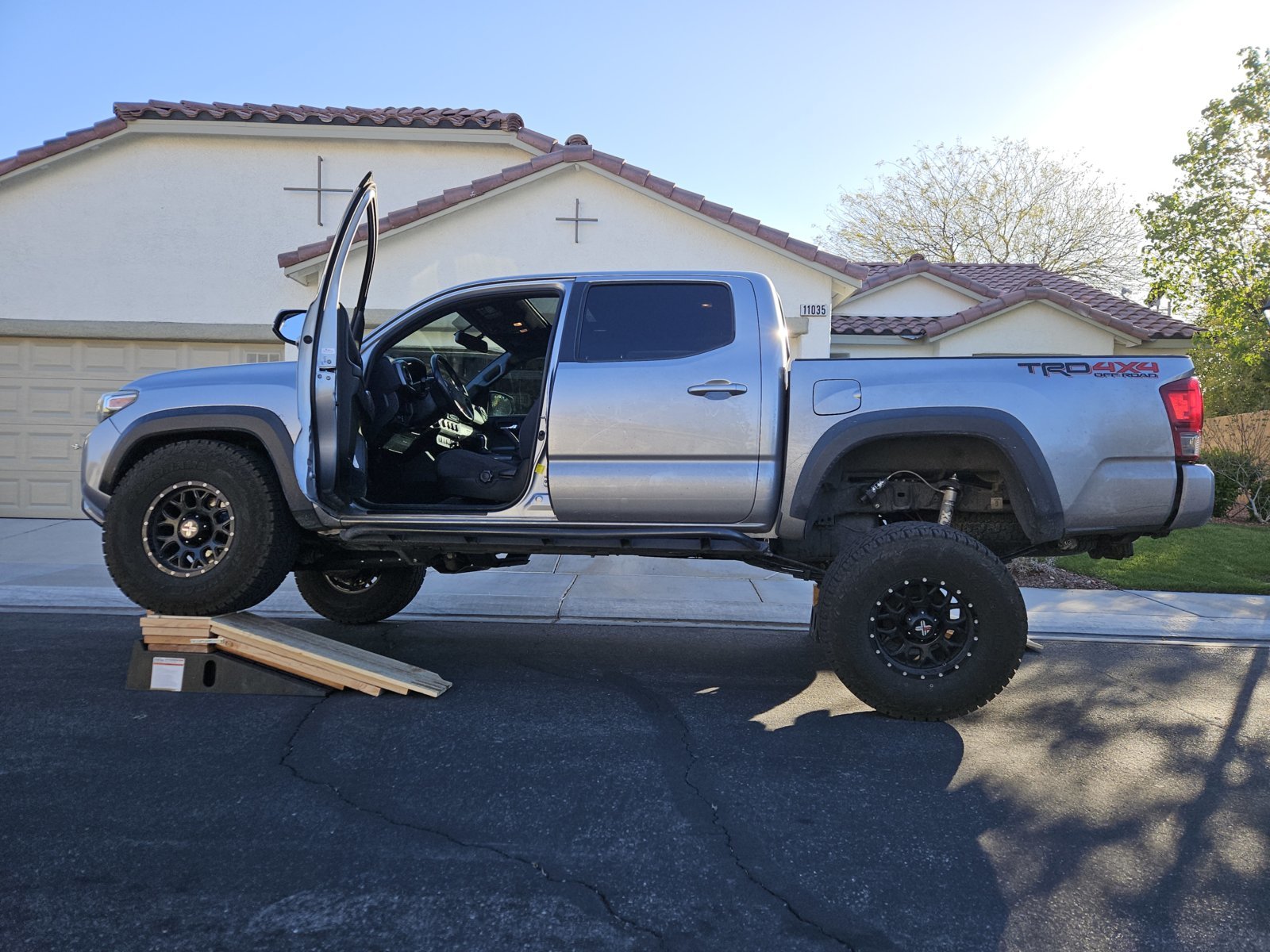

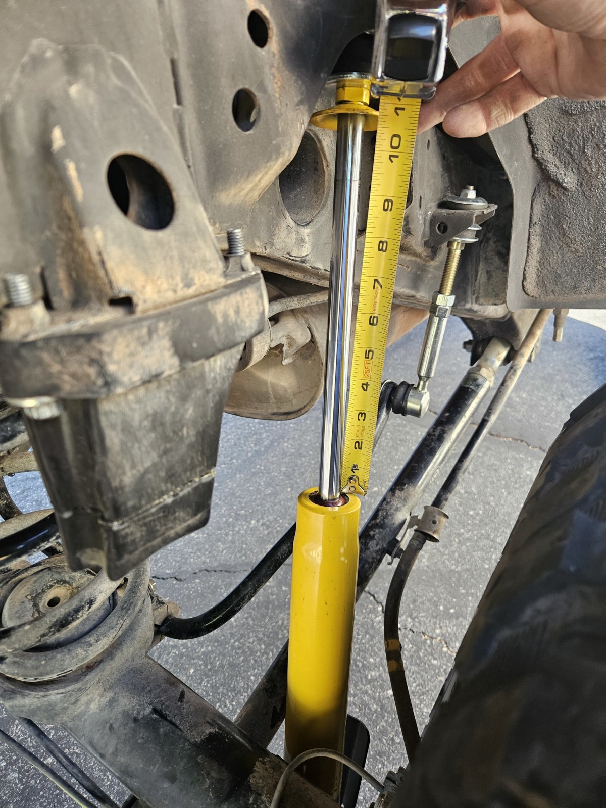

    One of the biggest assumptions without actual measuring of rear droop from jackstands, is that stock leafs cannot droop to 23" in stock configuration (no lift). When I measured my stock leafs plus 1/2" block P.S. and 1" block D.S., droop compared to fully extended 5100s, the leafs drooped 1-1.5" below the 5100 shocks at full extension.
    This led me to realize 2 things: 1. I have an 1-1.5" unused travel range without lifting, and 2. The stock bump stop length of 2.5-2
    6" prevents some potential uptravel.

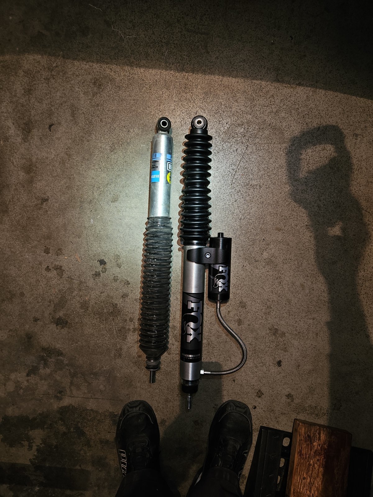

    I then bought Fox 2.0 performance reservoir shocks, which have a compressed length of 15.2" and extended length of 24.8", which were sized for 3-5" lift regardless, and bought what became about 3" hard rubber bump stops with 3/8" steel flip bracket. After experimenting with different block sizes under stock leafs to get tire tuck and maximum travel usage, I bought General Springs HD 1.5" lift leaf springs to lift the rear up as this was all I needed to minimally use all available shock travel.
    The limitations of space between the stock upper and lower shock mounts, regardless of lift, and the construction limitations of making longer shocks (longer bodies to house longer shafts, meaning longer compressed lengths, requiring longer bump stops to prevent overcompression) means an effective shock travel range of 9" low end, and 11" at top end.
    A 6" longer shock may make 2" more total travel at best. Most shock manufacturers are happy to squeeze out 1.5" more total travel for the space.
    Therfore with a longer compressed length, requiring longer bump stops, the uptravel increase is limited with longer shocks while the downtravel is extended. The ride height within that range, due to lift, is what changes.

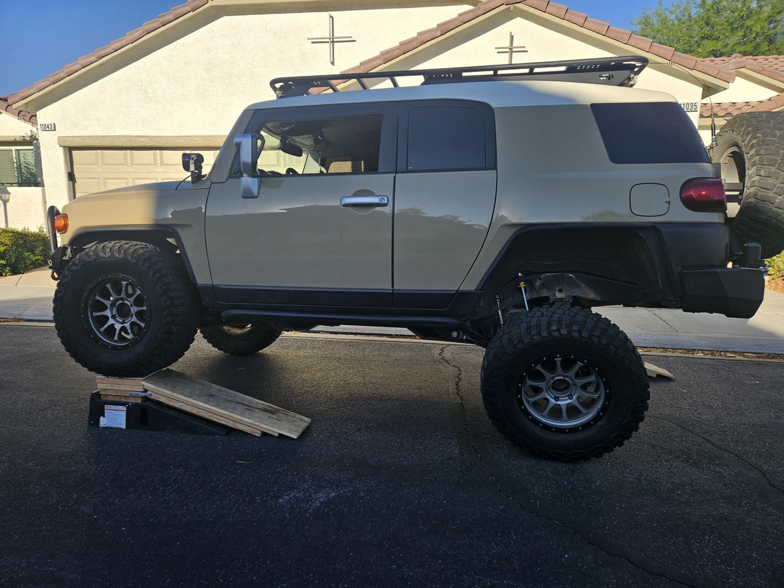

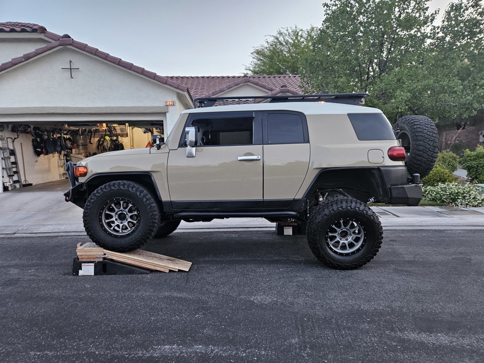

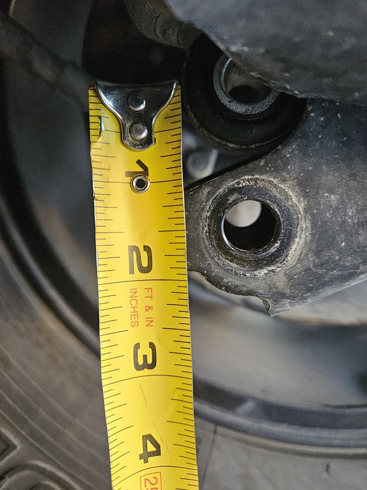

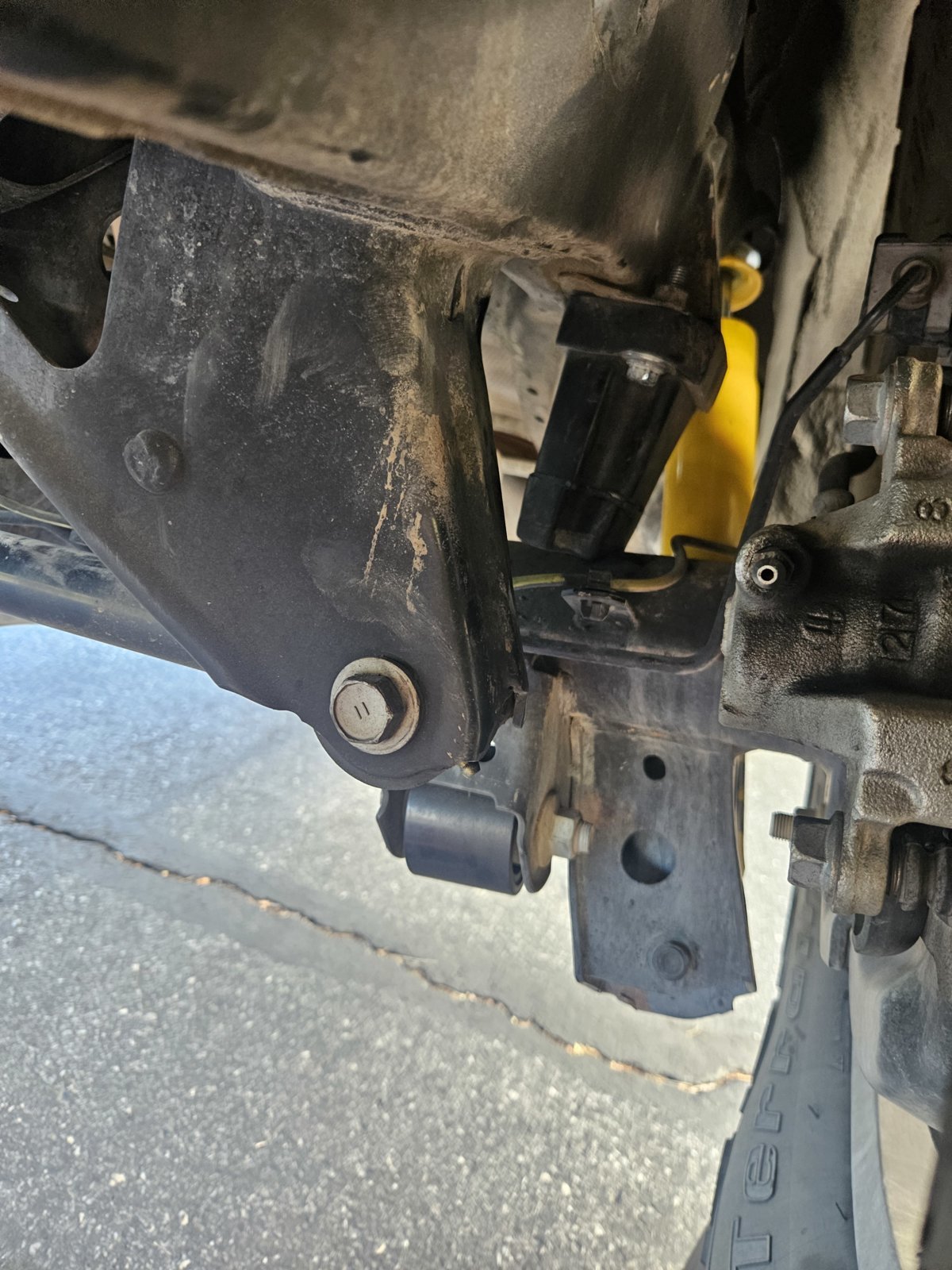

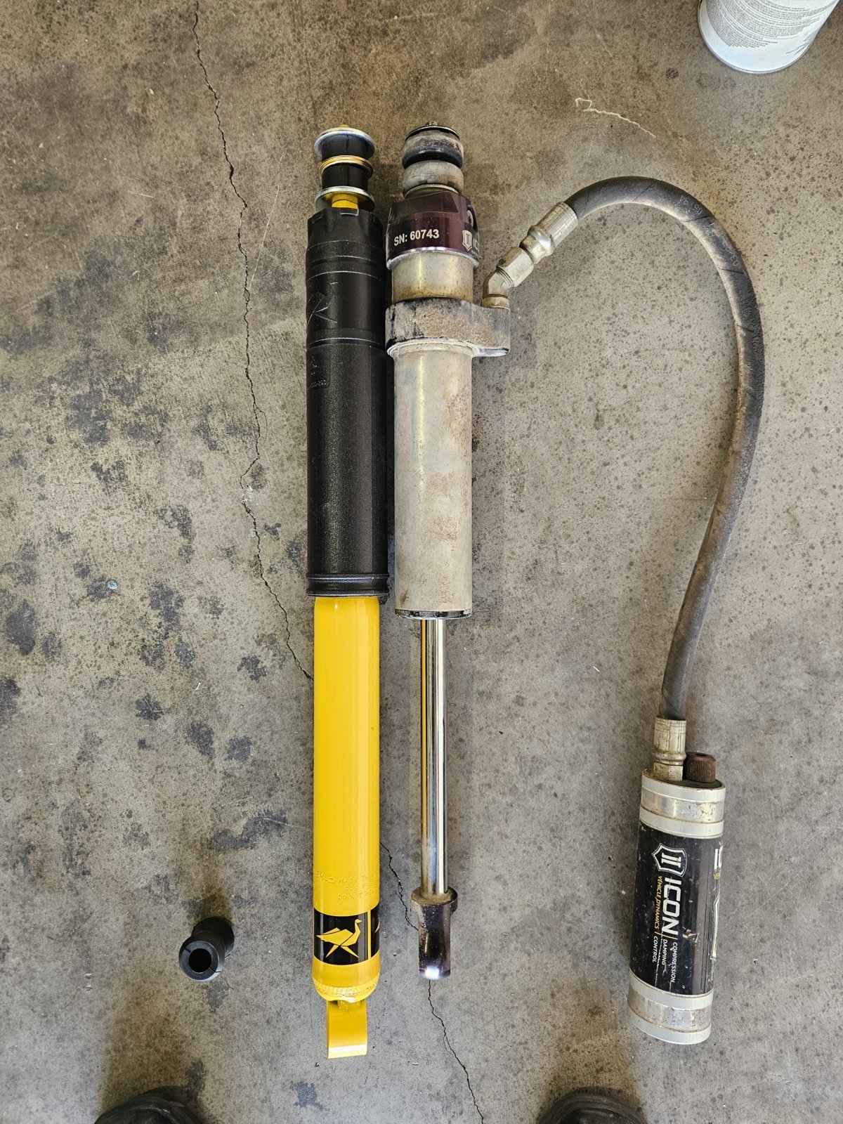

    Here is the same longer shocks concept, fitted onto my FJ Cruiser this week, 26.5" extended length, 15.2" compressed length OME shocks. The old Icon shocks are approximately 14.8" compressed length and 24.8" extended. The 3" rear lift springs, weighted down by bumper and gate mounted spare tire, still keep over 5" uptravel of the available 11.3" shock travel on the new shocks. The remaining available travel goes toward downtravel.
    Raising more or lowering the rear lift would change the ride point within the travel range and division between up and down travel.
    Before longer shocks, no bump stop contact even with 4.25" compressible bump stops:
    After longer shocks, allowing more rear droop and axle tilt. The bump stops are now touching but not compressed on these 12.75" cross axle ramps:
