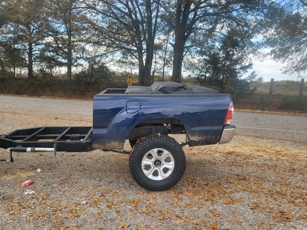

    Chances are you'll need spacers to clear the wheel/tire. I know I did on my utility trailer. I added a set of stock Jeep steel wheels with my old BFG's. I bought a set of 1.5" spacers and threw them on.
    I'm not sure if they make a hub to convert the 5x4.5 trailer to a 6 lug Toyota pattern. You can also look at Compact Camping Concepts for a custom axle. I bought one for my Tacoma bed camp trailer. It was right at $200 shipped from OR to AL. It has the Toyota hub and the same WMS as my Tacoma.

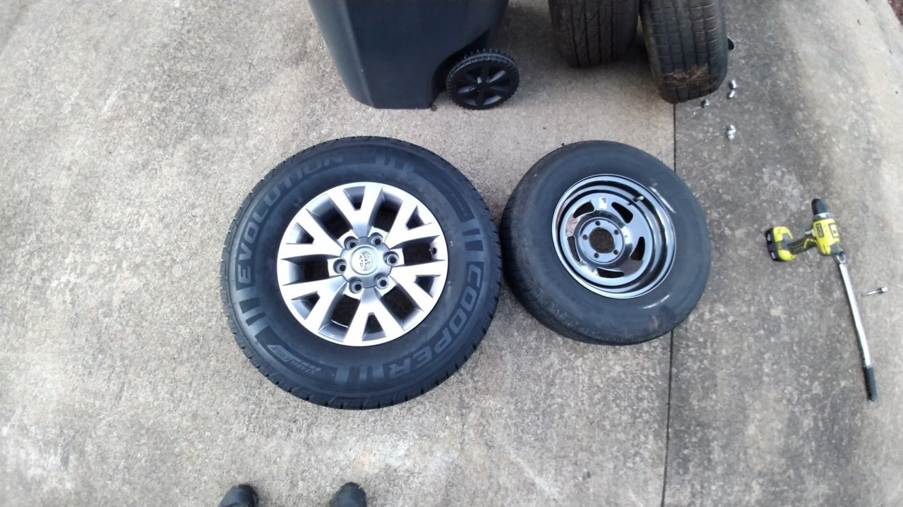

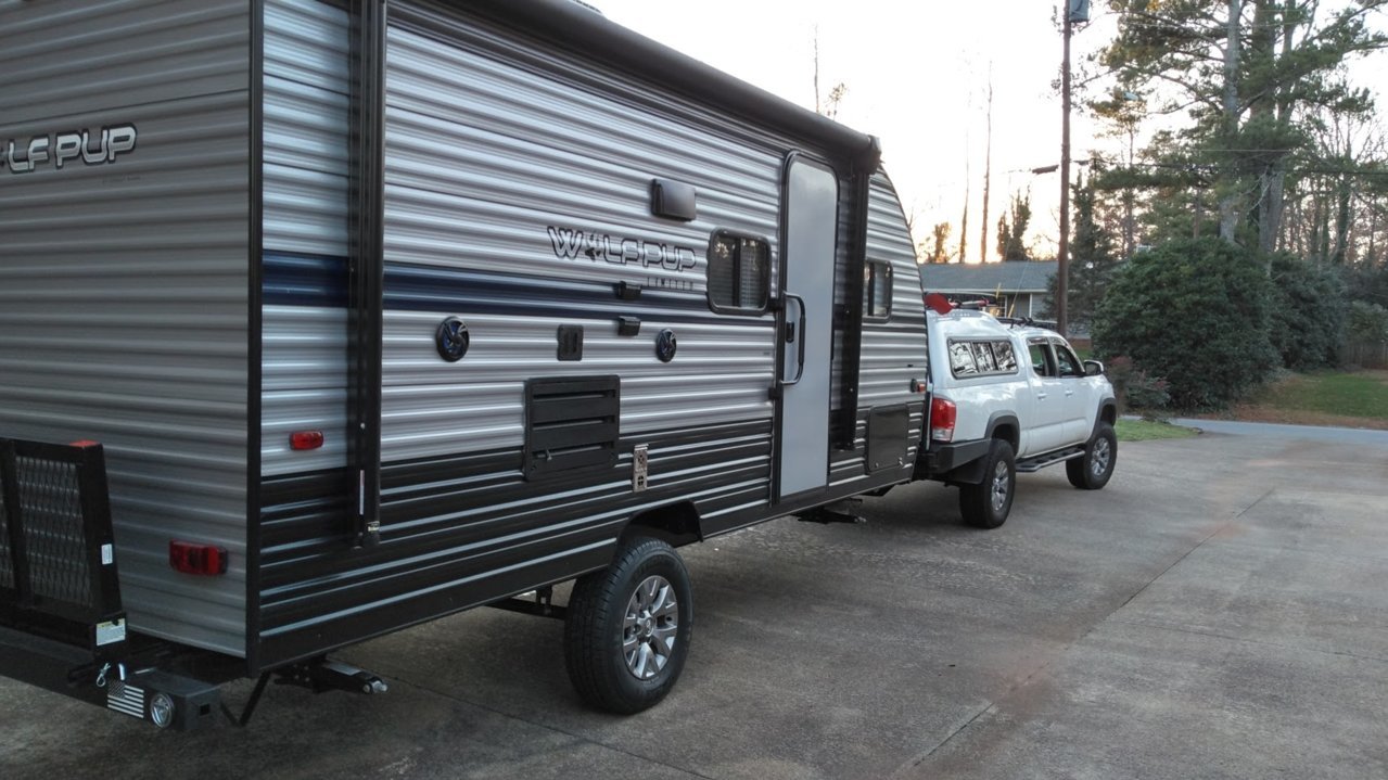

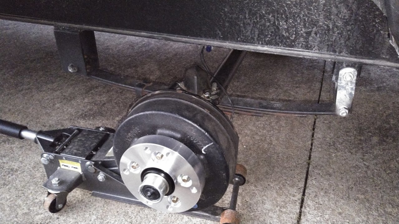

    Easy. I did exactly that for my travel trailer. It's great because I now have 2 spares between the truck and trailer. I also did a spring over axle swap for more clearance.
    https://www.amazon.com/gp/product/B008M9WFDQ is the adapter spacer I used, with red loctite and tightening to the correct lug specs. Like gixxerphil said, you need a spacer to clear the backspacing. I did not notice an MPG change when I did this, but I already was getting 10-12mpg towing anyways.
    Spring over axle... I added the bumpstops on top of the axle too, they're reused Tacoma bumps.
    ~30.5s on SR5 rims next to the tiny factory wheel.
    Now the trailer rides level, rides high so it has more clearance on gravel roads or parking lots, and matches the truck.

    Here's my matching utility trailer :rofl:
