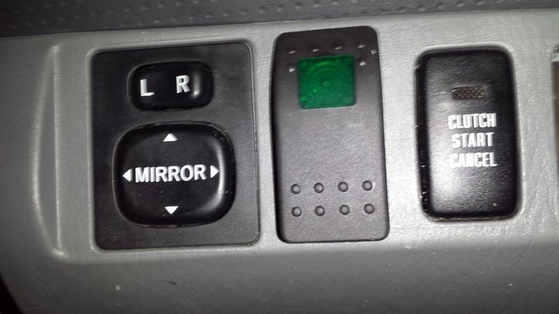

    Any switch will fit just about anywhere in the dash...all that matters is how much you want to cut

    You can fit OTRATTW switches there too. Just need to trim the bottom of the opening to the height of the switch.

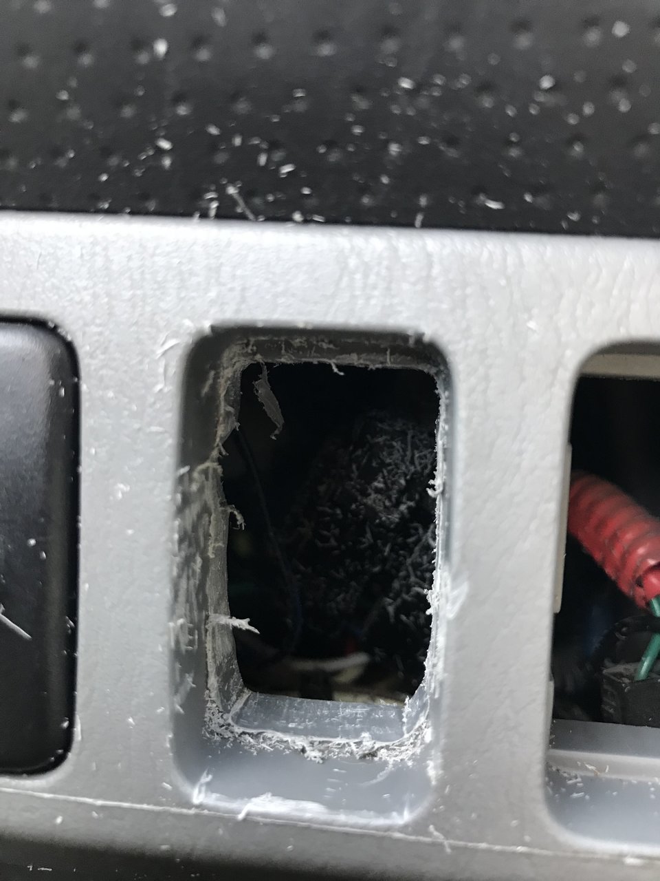

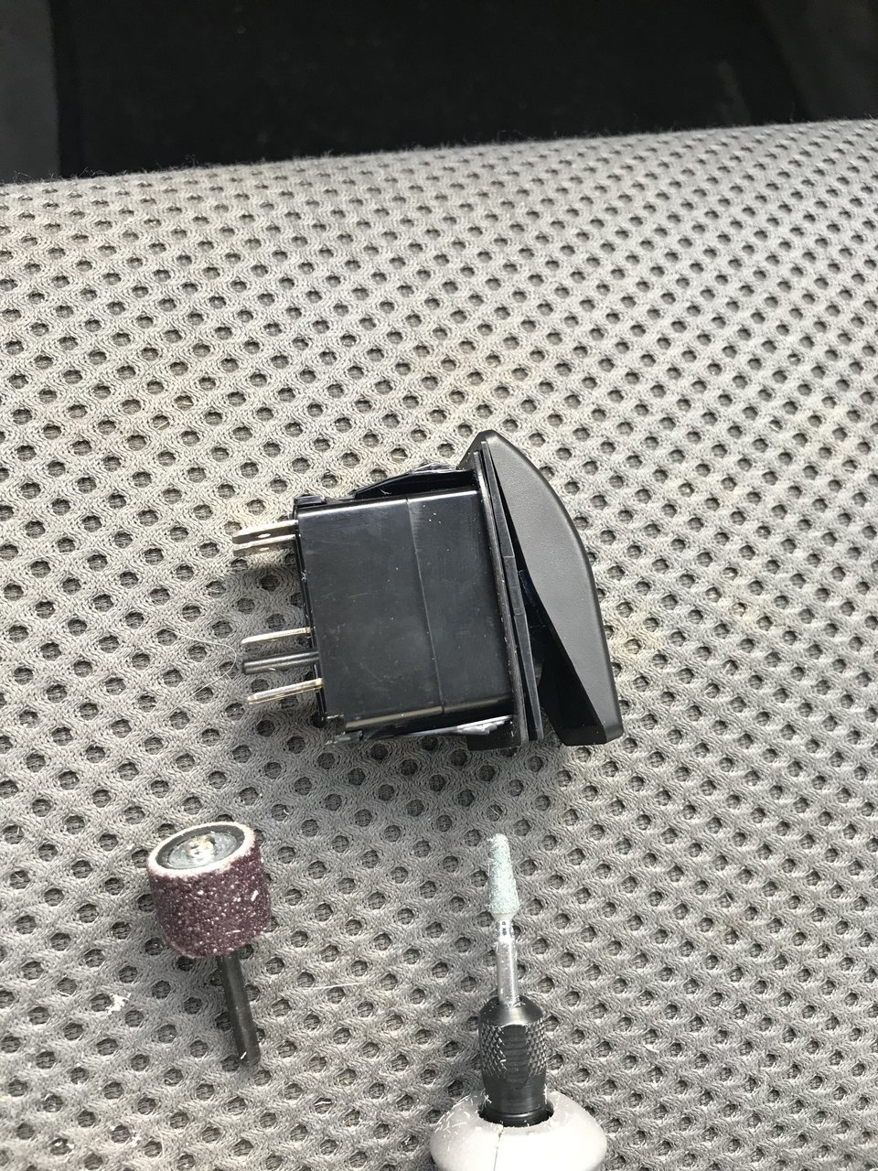

    26E3298B-5E5E-4DEC-B8FF-89A3E003DD1E.jpg 13B3F1E7-D261-4677-8C70-43BEB01EFF2B.jpg Anyone have trouble getting Carling switch to fit!? I’ve been using a Dremel and I’m having to trim the top and the bottom? Even then it only slides 3/4 way in
