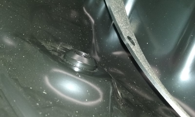

    Does anyone know what material the 5 speed auto transmission pan and drain plug are made from?
    I've stripped the plug and/or pan and was wondering if there's any chance that the plug is made from a softer material. Obviously I'll look at both threads when I drain the pan, but I haven't got that far yet. I'm wondering what I'm in for.
    Be warned: this happened during my second drain and fill maintenance. As far as I know, no one has touched this bolt other than me and the person that installed it in the transmission at the factory. I don't remember having any issues the first time around. I torqued to the value in the service manual the first time (29 ftlb). In hindsight, this seems way too high and was probably when the damage was done. Fast forward to this weekend and the bolt threads in, but will not tighten past finger tight.
    I've been doing all of my own maintenance since I was 16 and have never had an issue like this. Going forward I will never torque this plug again. I will go by feel just like I do on the engine oil pan. I've never had an issue doing that.

    I did the same thing, the pan has a round nut soldered on and it spins when too much torque applied. Good thing is it doesn't leak when spinning. I too used 21 ft lbs.
    I bought a new pan, drain plug and gasket. This time I used the same washer as the engine oil drain plug on both drain and overflow and torqued to 12 ft lbs. No leaks or problems since. I did look at the pan every day for a few weeks and that was last July.
    I got the pan and plug at Lakeland Toyota overstock for about $87. Fel-Pro TOS 18736 Gasket from Amazon for $14

    @fla_sun Thanks for the info. It's helpful to know what's on the other side of the pan.
    I got two quotes today and it looks like I'm out about $175 for this mistake if I get all OEM parts and Toyota WS fluid. On the plus side, I'll have done two drain and fills back to back so I'll have a higher percentage of new fluid in it than I otherwise would.
    Update: I removed the plug and drained the pan tonight. It was a PITA to get the plug out. There was a lot of resistance backing it out and the nut on the inside was obviously loose. I could feel it wobbling and going up and down. I had to pull down with vise grips while turning to get it out. There was one thread left on the plug. The rest is smooth. I can't believe that I managed to strip it this bad.
