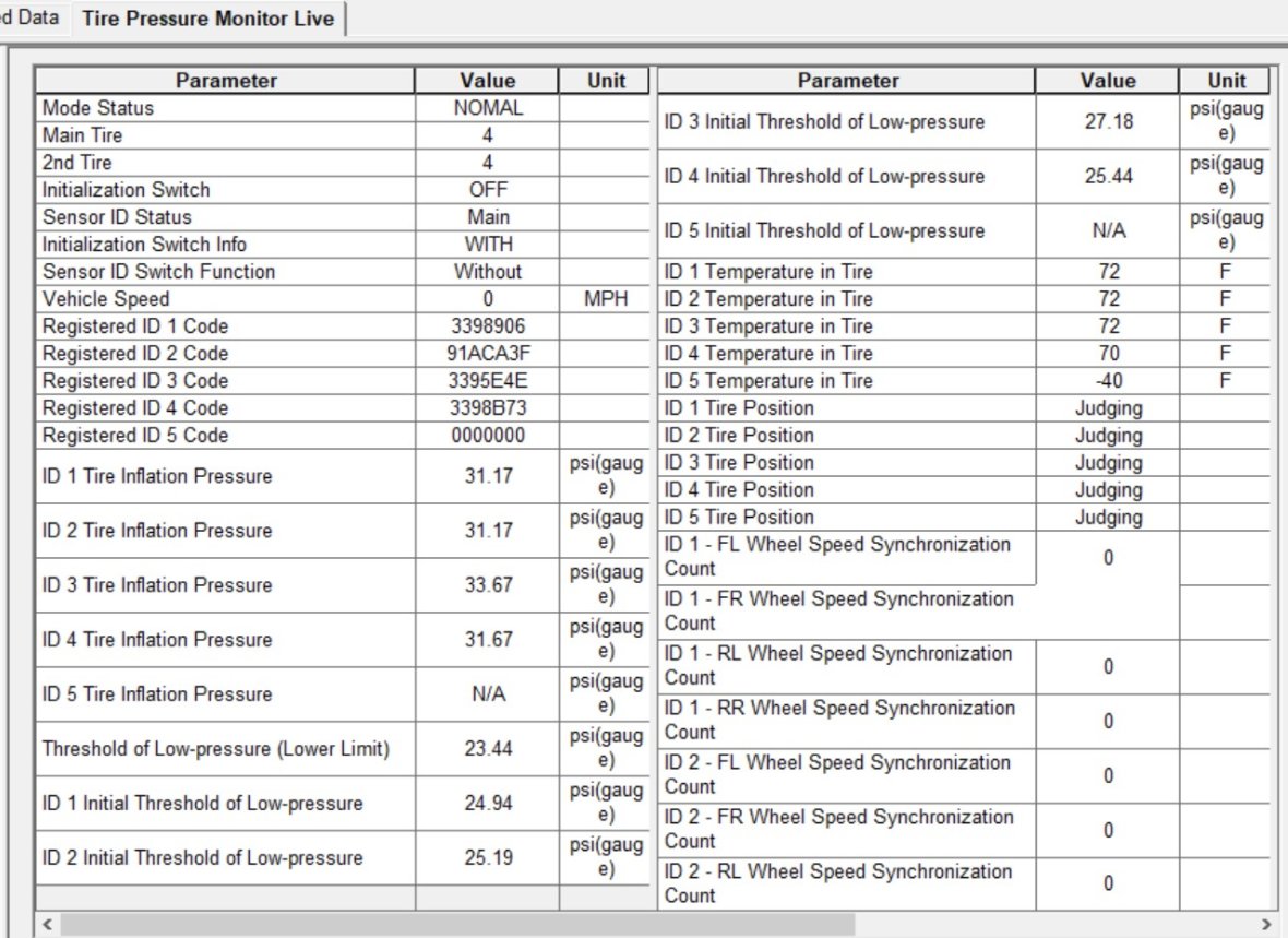

    I was playing around in tecstream last night and it looks like there are 5 spots for tire sensors but not sure how to set it.
    Has anyone had success or is the 5th slot completely unusable? 2019 TRD OR

    Do you have a 5th TPMS that you can register into Techstream? Also, do the Mode status, Main Tire, and/or 2nd Tire values need to be set differently?

    Based on what I have heard, My guess is that the software has 5 slots but the truck only has 4.

    I'd read the same thing in other threads from those who've tried. I think the 2nd gens had five slots, and the software is universal to all Toyotas, but the truck itself can only remember four at a time. Basically if you really wanted to do it right, after every tire rotation you would need to go in and reprogram the truck to learn the new wheel, and forget the one that moved to the spare.
