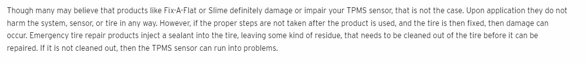

    So Fix a flat is TPMS sensor safe temporarily but not for like say years ?? You have link for that paragraph?

    That one came from an aftermarket TPMS website, who has no stake in Fix-a-flat or selling you tires.
    https://www.redi-sensor.com/emergency-flat-tire-repair-products-and-tpms/
    The reality is that it is highly labor intensive to clean, and yes it does need to be cleaned. It can't live in there for years. It does interact with the compounds in the tire.
    Crap dude, just take it to the shop. Or sit here and don't. I'm not the tire police.

    I visited the site you gave it appears it is saying that Fix a flat gak does not harm the tire but could i guess cog up the TPMS sensor if it is not cleaned out of there eventually. Of course none of that matters if you end up getting a new tire installed as thats the perfect time to install a new TPMS anyway but in the case of getting a new plug installed inside out by the shop then concern for your TMPS may be important at least thats what i took from the paragraph.
