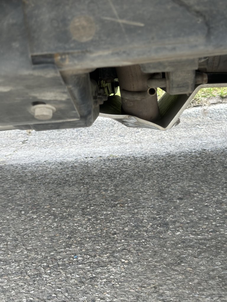

    Can someone please suggest some ways to restore the shape back to normal?
    My exhaust rubs against the bent plate and makes an annoying rattle.
    Let my novice friend drive my truck on a mildly rocky road since there weren't any large obstacles. Of course, she drove a little off the road and clipped a big rock. :rofl:
    Thanks!

    I would just remove it and hit it with a sledgehammer from above.

    Best way to fix this:
    1. Remove skidplate.
    2. Reroute your exhaust.
    3. Install a flush skidplate.

    Use the spreader attachment (upper left corner of the picture below) between the skid plate edge and the frame: https://www.amazon.com/VEVOR-Porta-Power-Kit-Hydraulic/dp/B0BYHWJD9C/

    Like most people have said earlier, take it off, and beat it with a sledge. Or try to stick it in a vice and bend it that way.
