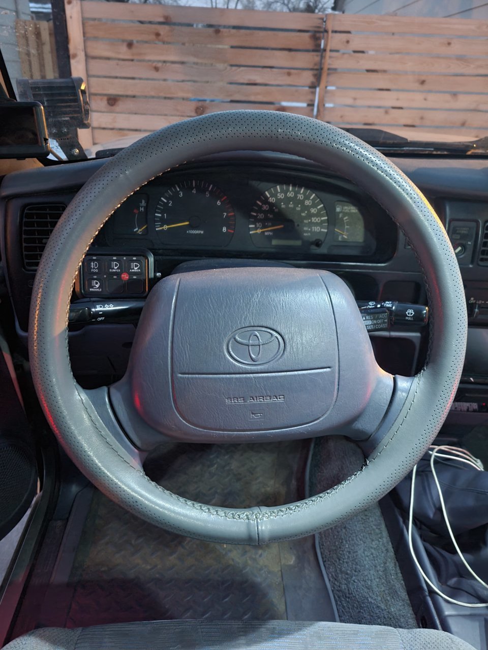

    2000 Tacoma SR5 V6 TRD
    I cut the steering wheel cover about 8" across on the very top of the wheel (where mine was loose), opened it up, dampened the metal underneath the covered, added some Gorilla glue, and taped it closed with painter's tape. The glue bubbled through the cut in spots, but I cut away the high spots after cure, then I put this $14 steering wheel cover from Amazon on. It takes a bit of patience to stitch it up (maybe an hour worth of work), but the final product is great! That job was one of the first things when I bought my truck a year and a half ago. It has held up great and a huge improvement over the loose cover (and way better than a $700 wheel replacement).
    Universal Car Steering Wheel Cover Leather Breathable Design 15 Inch Diameter Cowhide Steering Handlebar Wrap Fit Most Car SUV Gray https://www.amazon.com/dp/B07JHV9WCZ

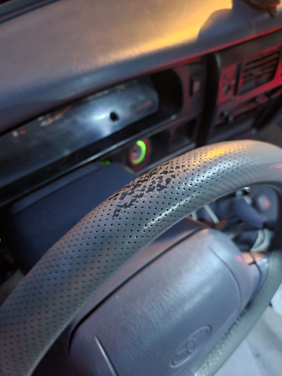

    Several reviews complain and provide photos of color failure in fairly short periods of time. Could be product, could be something on their hands. I mean leather is dyed, so something inexpensive like this is certainly subject to problems. How is yours holding up? My steering wheel is solid, but the top section is starting to surface peel.

    After about a year I've noticed on the very top (most common resting point for my hand/wrist) has exposed some black underneath the gray coating. Hasn't bothered me enough to take it off and pay for an actual leather wrap, but I'm sure they're out there if you want to spend a bit more. Here's mine for reference (notice the black showing through on the very top not seen looking straight on, or any other angles really):20230126_173557.jpg 20230126_173608.jpg
