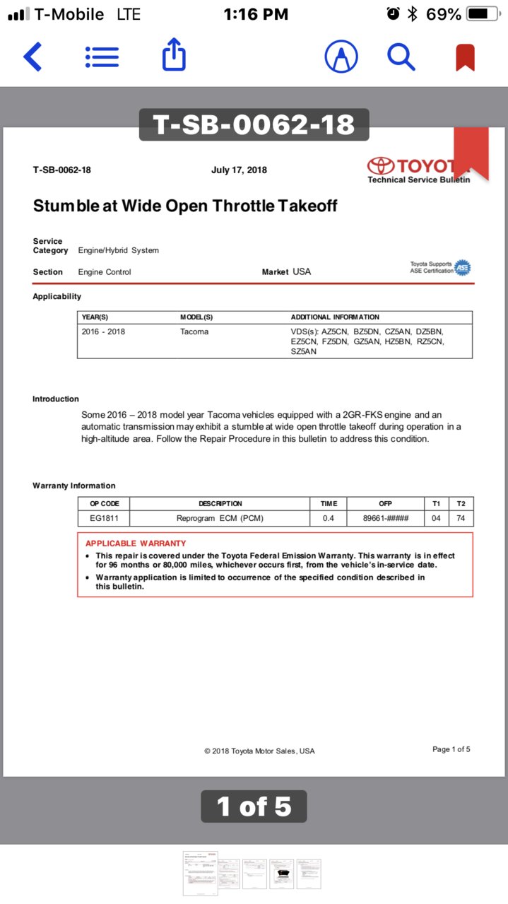

    San Diego
    2018 DCSB OR
    Just drop my 18 off at the dealer. They said they will do the update without beating the piss out of my truck. No test drive just update. I hooked up a hidden camera so I know what happened. Let’s wait and see!!

    #25
    petr321
    petr321 Well-Known Member
    Apr 29, 2017
    #217666
    175
    Petr
    San Diego
    2018 DCSB OR
    Tsb 0068-18
    MOC221_ likes this.

  7. Aug 3, 2018 at 1:16 PM
    #27
    petr321
    Apr 29, 2017
    #217666
    175
    Petr
    San Diego
    2018 DCSB OR
    Tsb0062 -18
  8. Aug 3, 2018 at 1:17 PM

  9. Aug 3, 2018 at 1:17 PM
    #29
    petr321
    Apr 29, 2017
    #217666
    175
    Petr
    San Diego
    2018 DCSB OR
    Here it is
