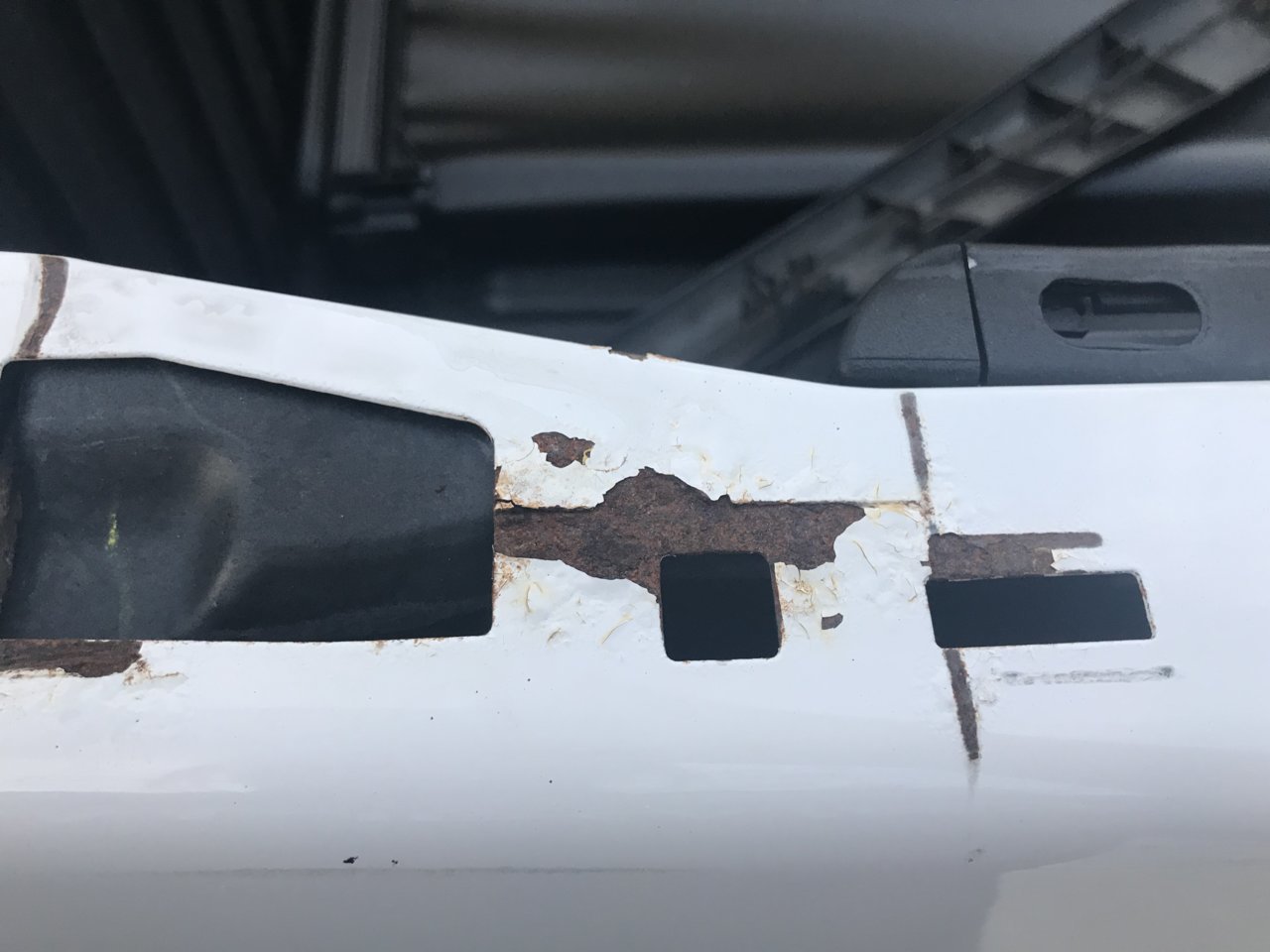

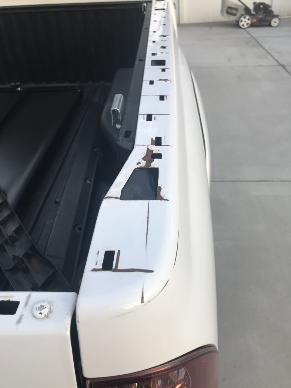

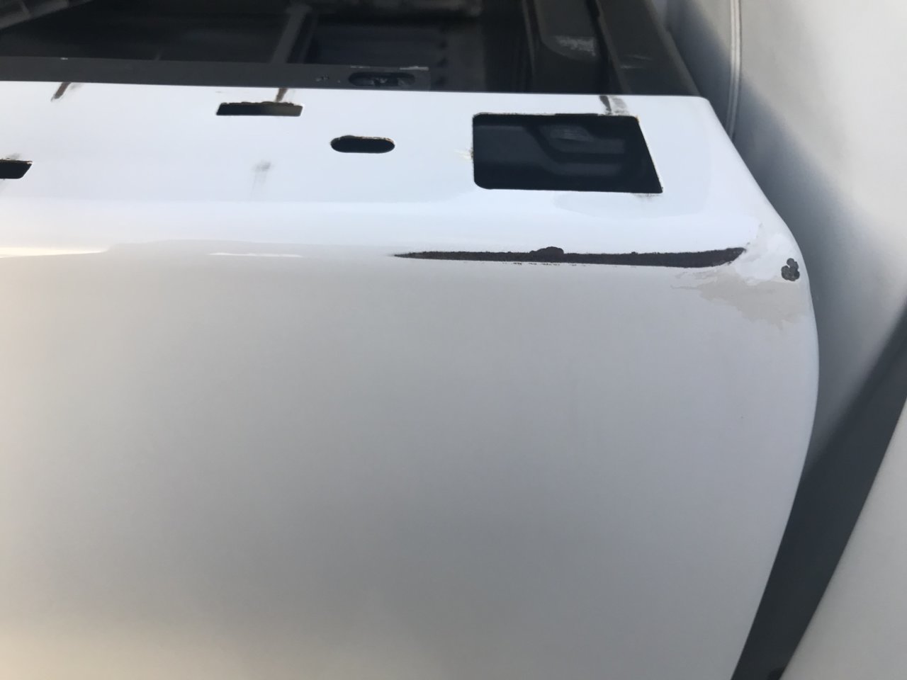

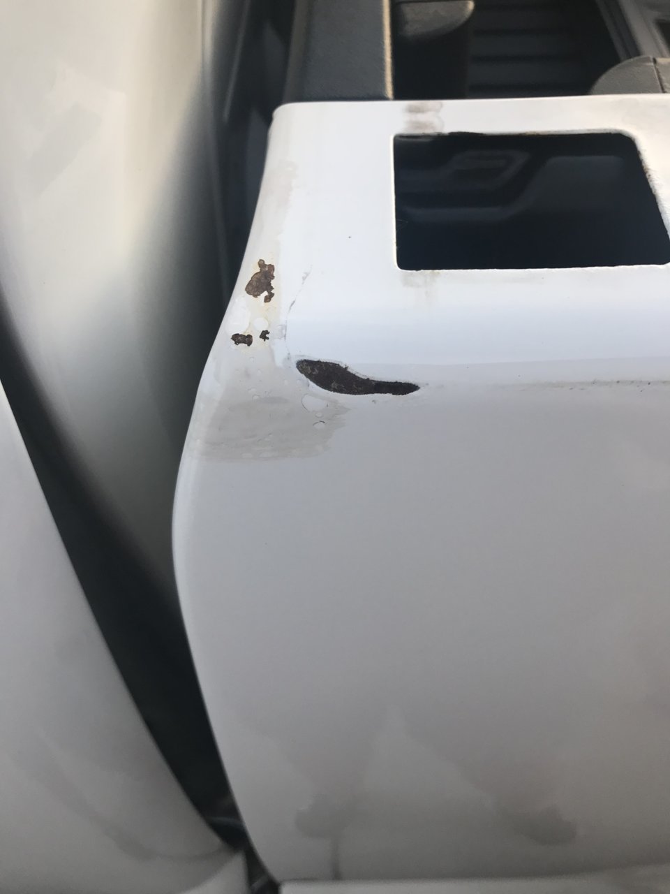

    I've got a nice surprise taking off my bed rail caps. Any ideas on how to fix this before it gets worse?

    Mask bed sides well to just under rail cap, sand off all rust, treat with Rust Mort or similar, prime and paint.... even with a brush and Rustoleum as long as it won't show,reinstall rail caps.Was there a cap on that truck at some time? It looks like somebody already tried to touch it up. I wouldn't wait too long, that rust is beyond the surface rust stage already. What year is the truck?

    That last pic looks pretty bad . Knock off all the rust scales and probably going to get pin holes or worse . The good thing is it will be hidden with plastic trim. Rust encapsulating paint would be best .
