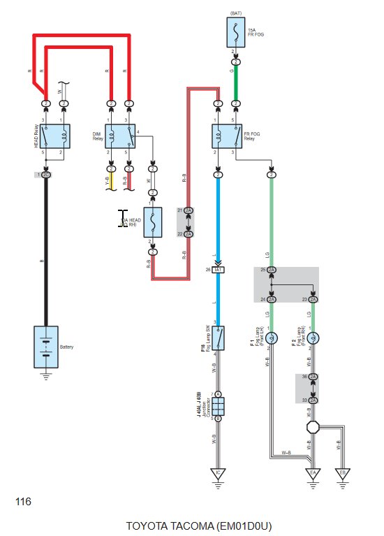

    Anyone have a diagram of where the fog light relay is? Currently I have power to the light bulb plug and to one of the 4 pins on the switch. I'm thinking it could be the relay? Any other relay on the truck to test with this? Any tips is appreciated thanks

    So you are saying you have power to the plug that the bulb plugs into?
    If so, I’d be checking your gorunds.

    If you have voltage at the bulb connectors (plug) the problem isn't the power side of the circuit. Poor ground connection or your bulbs are not inserted correctly all the way. Or you have defective bulbs...

    Thanks for the help. Found out the switch was bad. The clip that slides forward when you press the button to be on is broken inside. Easy fix with gorilla glue
