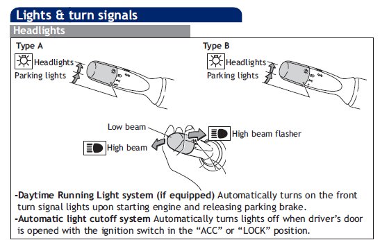

    Does your 2012 have a DRL setting on the light stalk?..Guess not...since they come on as stated below. So the switch you do is to turn ON the TAIL (Parking/Illumination) circuit. So you may have that towing ground issue.
