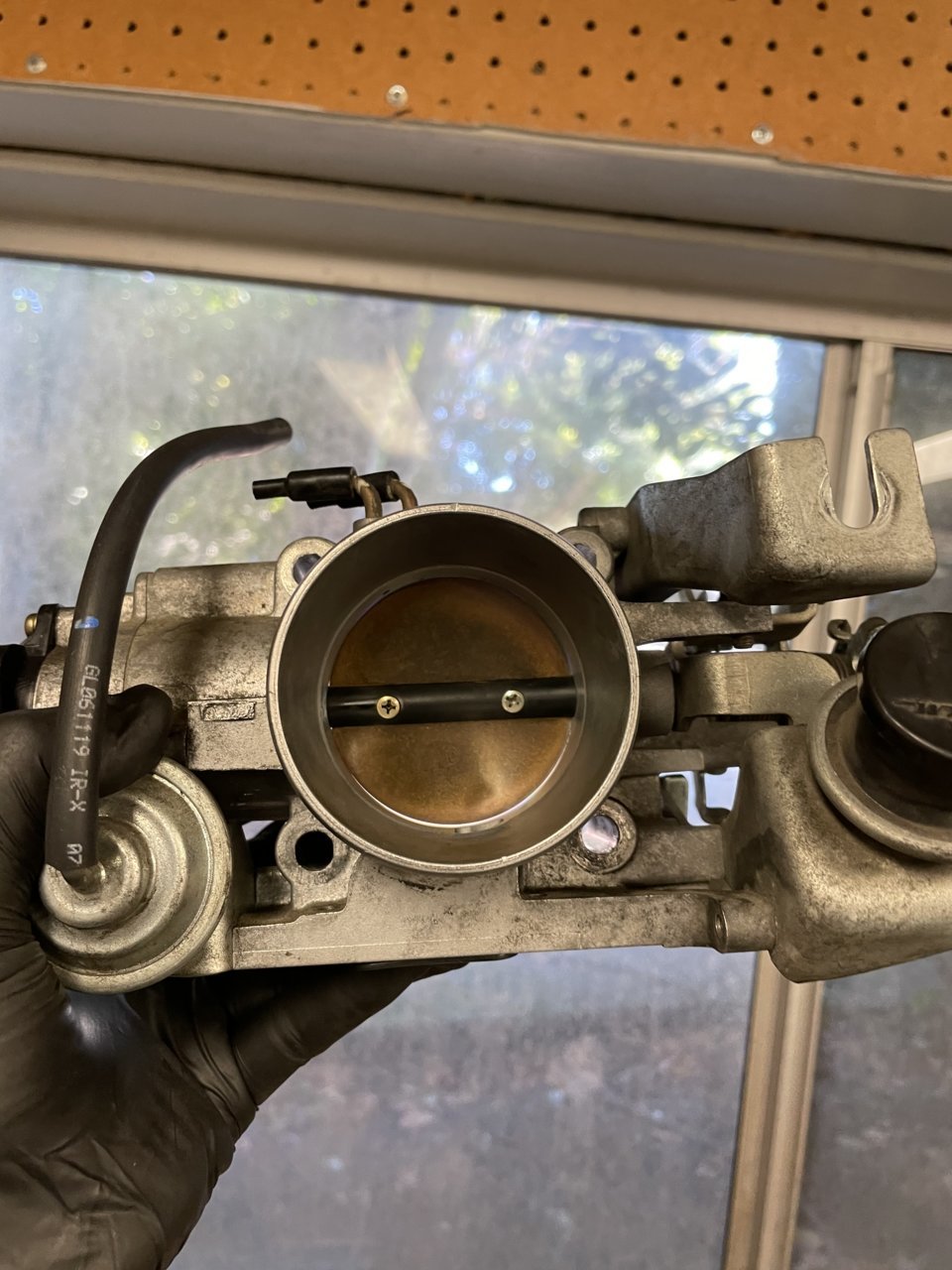

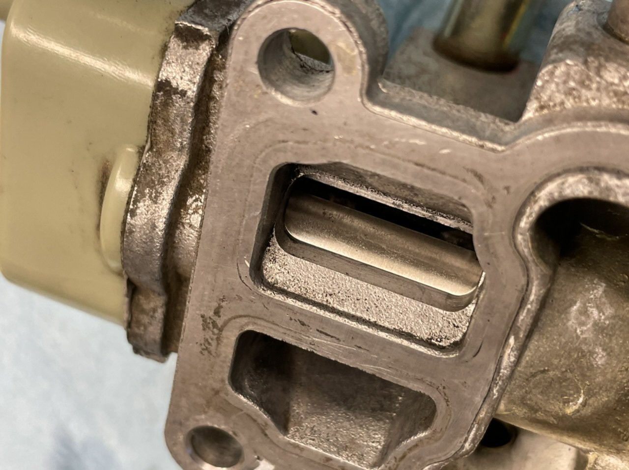

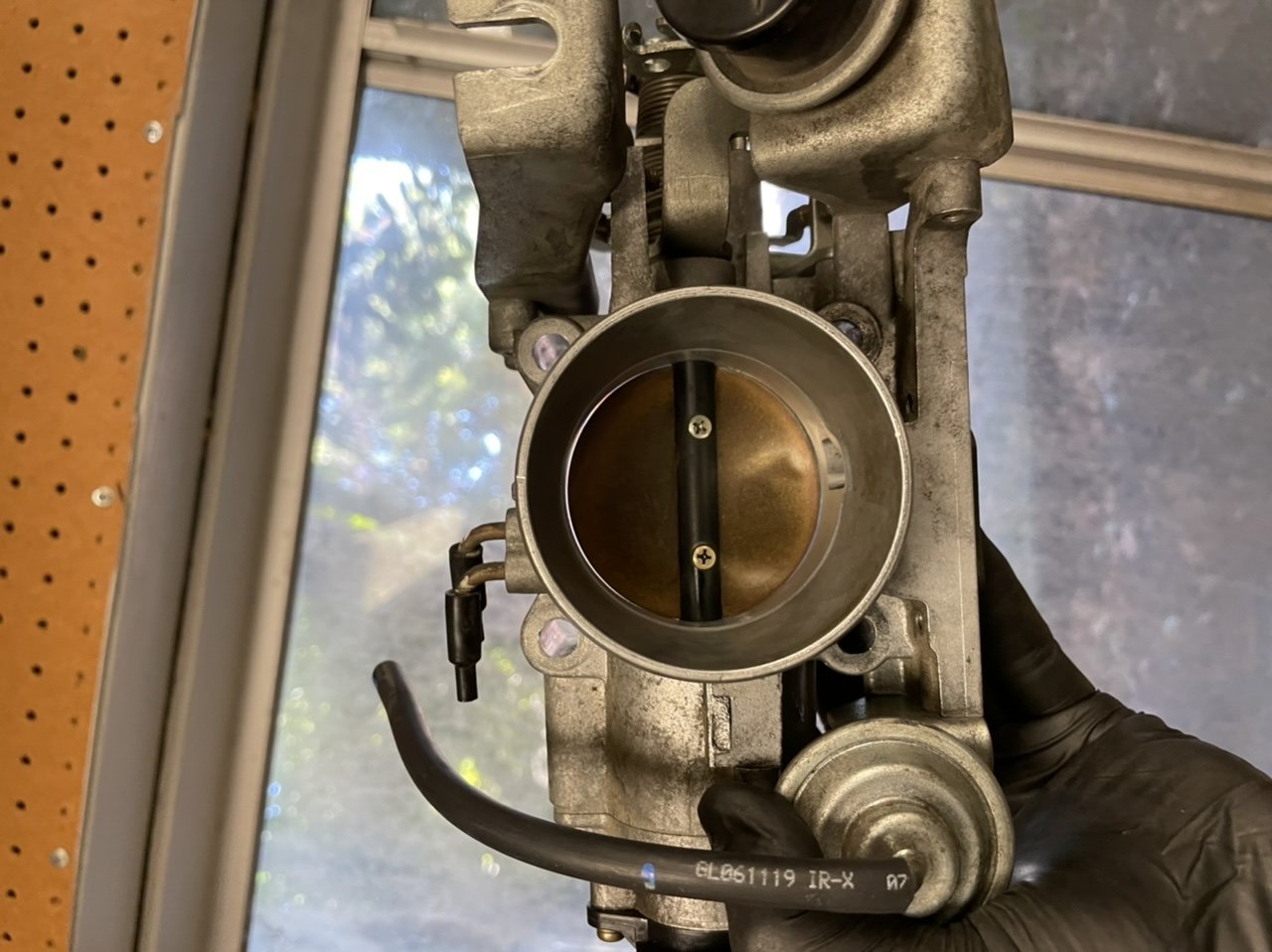

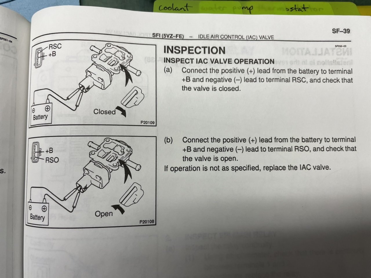

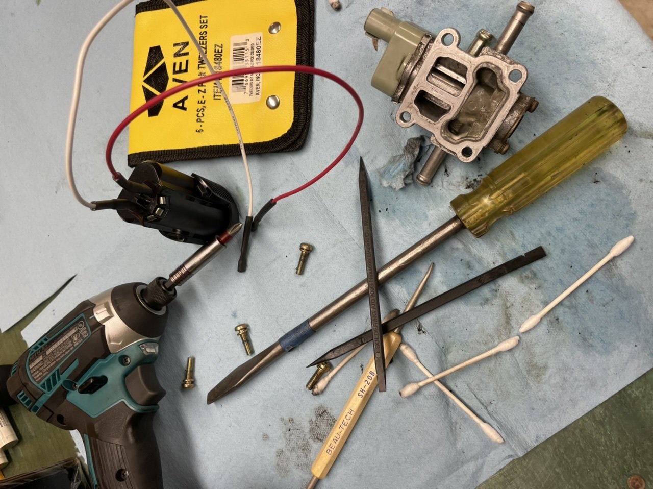

    It was the IAC. Resistance tested fine and it even showed some values in tech stream which looked sane.
    got the IAC off the truck and hooked it up to a 12v (power tool) battery per the FSM. The IAC would not open or close.
    I suspect when I did a half ass job of cleaning it I created a paste of carbon. Once it dried I suspect the carbon paste glued the metal part of the IAC that opens and closes. I cleaned the part and it would open but not close. I had to clean it a lot more and then it would close a little. Even more cleaning and now it closes the correct amount (which I believe is mostly but not all closed). One tip if you go this route is hook up the battery to help it close, then use one a tip to rotate it closed, and use another q tip to wipe it. I was a little nervous to destroy the motor but I didn’t have much to lose since mine was a brick if I couldn’t fix it. After I got it moving nicely I sprayed some cleaner and actuated the motor both ways a million times.
    Lesson learned, if it works, maybe don’t touch it (unless you don’t mind getting a replacement). And if it doesn’t work, the metal part that moves has to be shiny metal, no carbon allowed at all.
    Honestly I’m surprised mine worked before I cleaned it with so much gunk.

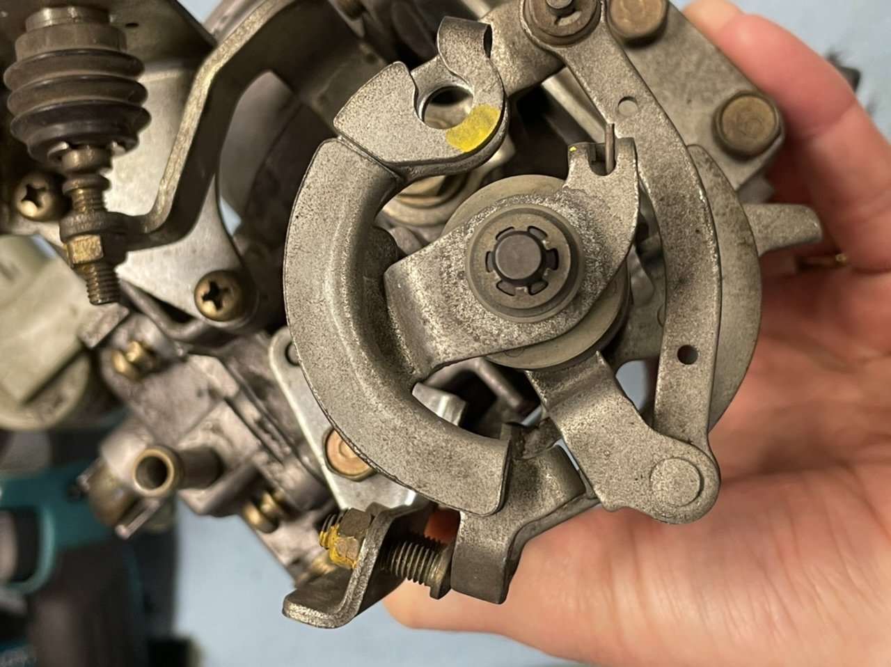

    Also I can see daylight on my throttle body. It seems like it may need to be adjusted to be able to rotate closed just a hair more closed. I’m going to leave my throttle body as-is since I suspect the IAC was the cause of my problem given it was totally stuck.
    the pics show after cleaning the IAC. I think I cleaned the throttle body a little more maybe after the pic, can’t recall.
    I’ll confirm the fix worked later this week. I want to get a gasket for the IAC since mine is looking a little tired. I have to wait for that part.

    Great job! We knew you could do it! Hey, you need to tighten up that plate though while you have it out. Move the throttle stop so it’s just fully shut under its own spring pressure.

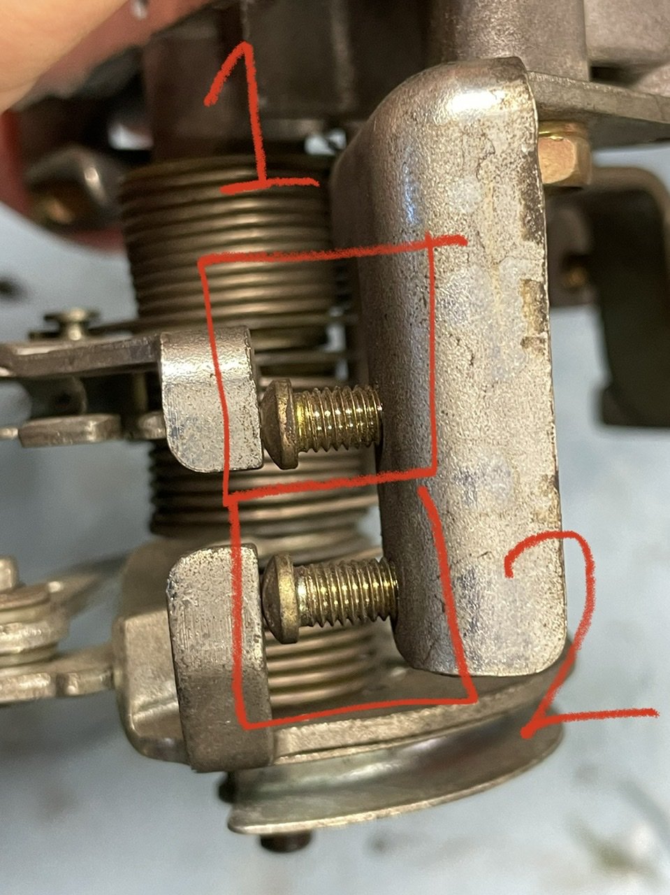

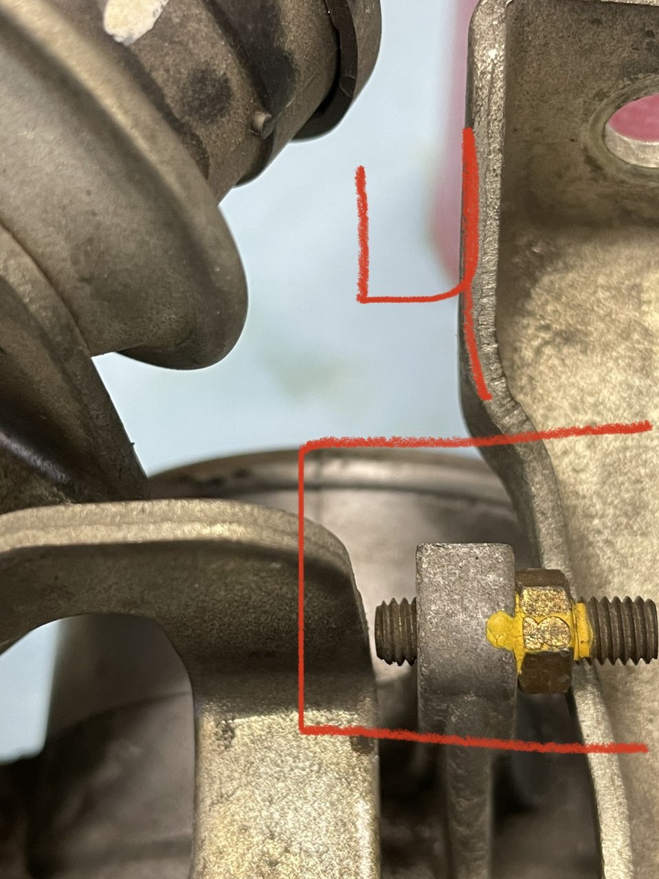

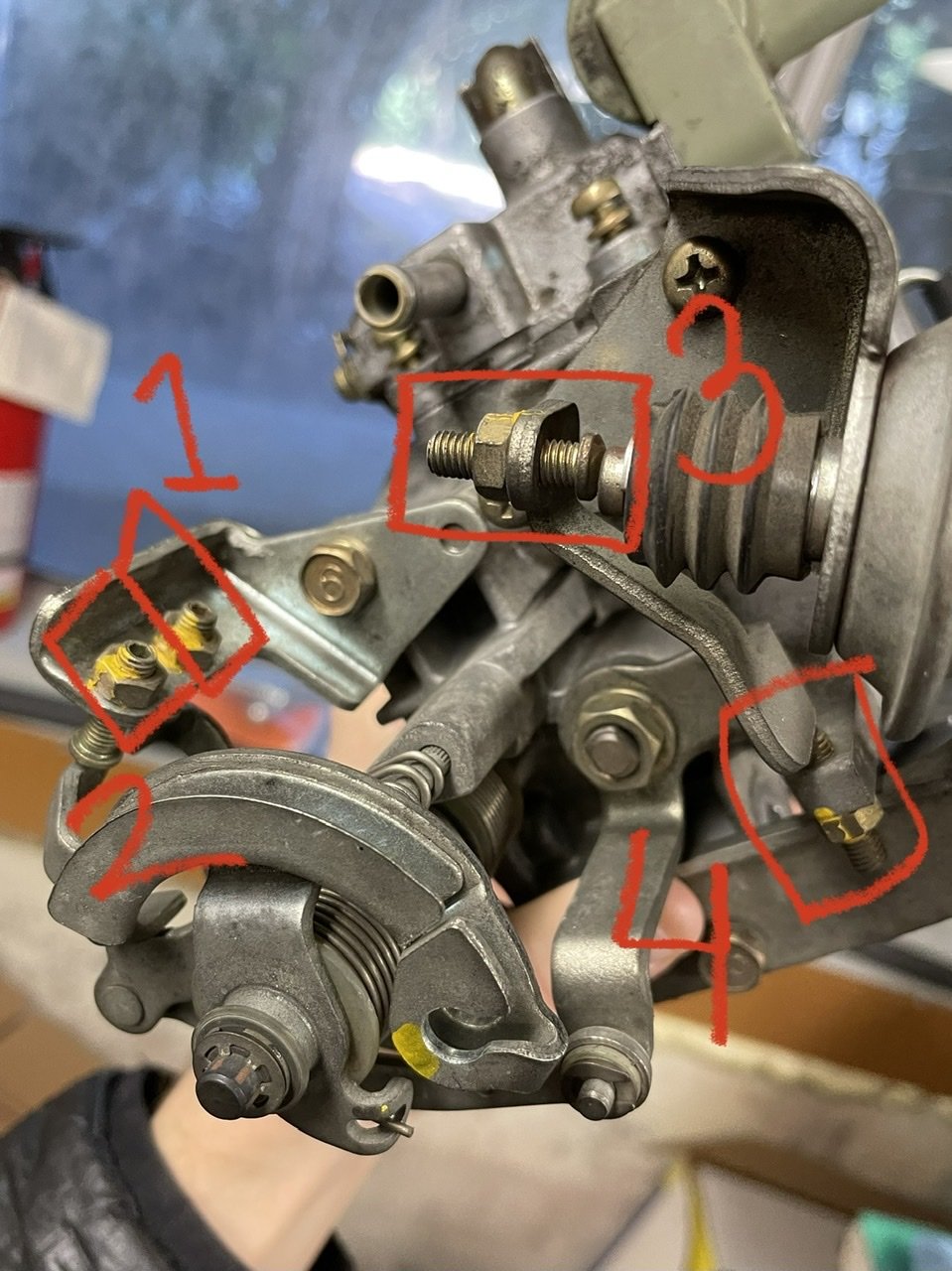

    Thanks! Which screw should I adjust? It seems like a lot of the screws are set at a position where there’s free play in the assembly (either free play at the screw or in the linkage)

    If it's working I would leave the throttle adjustment alone unless it becomes a problem.

    Mines a 2.7.... one of those is physically holding that plate open right now (that’s not wear) perhaps one with a molested paint mark because that plate should be shut thus why you have an iac circuit.
