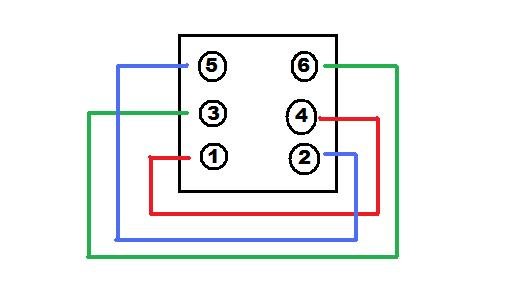

    I wanted to come back to the websites where I posted my rough idle problem as a courtesy to those that helped me and to those that might have a similar issue.
    So after purchasing items that I didn't need in trying to fix this problem (another MAFS, 2nd set of new plug wires, 2nd set of new spark plugs, fuel filter, 3 bottles of fuel injector cleaner, thread chaser, 1 vacuum hose, and other stuff) It looks like the culprit was either the No.1 Ignition Coil Pack, or it's boot.
    I bought the used ICP on ebay for $25/$5 shipping. When I got it and went to install, I pulled the suspect: ICP No.1 (suspect because No.1 ICP was providing the spark for plug No.4, the plug that had been boppin around loose in it's chamber for a while along with loose plug boot.) When I pulled the boot just for curiosity sake on the original No.1 ICP, I noticed the thin coil/spring inside the boot was very "jittery". It wasn't on the used replacement ICP. I also had already noticed the pin on the ICP where plug wire connects was very oxidized compared to No.3 ICP, which was clean.
    At any rate, I've been driving it around for the past week and noticed the rough idle dramatically, yet not immediately, subside. I really wouldn't complain about my idle now, other than so far, once in a while, it does idle a little rough, kind of like a small vibration while stopped in traffic. It's only about 15% of the time though, and could be either the ECU re-learning or just the natural engine wear. I do notice that my STFT1 and LTFT1 are showing larger numbers. STFT1 as low as -6% and up to +5%. LTFT1 ranging from 0% to +9% while driving. The last bottle of LUCAS is probably just exiting the fuel system as I just filled up 2 days ago after being near empty with LUCAS in the tank.
    There's been one occasion since changing the ICP where the idle/rpm's did drop to a noticeable shake, but not crazy harsh. Still, it caught my attention. Hasn't happened since. Could be adjusting, even though I purged/discharged the ECU system again.
    Anyway, hopefully this is behind me. My next to do's will be changing the original timing belt, water pump, thermostat, and belts. :wink

    since there is still a little "something something" there pull the other two coil packs and inspect very very carefully for any sign of "anything" and that might be where that little "something" still exists.
    glad I came across this post as I have an unexplained "random" rough idle on mine as well after doing most of the common things you did on yours.
    I just bought a new set of plug wires but haven't installed them yet but after reading this thread, I will be looking hard at the coil pack condition when I do.

    Yeah, earlier in this thread I mention the other coil packs, and why this particular coil pack was suspect, although based on the clues I gave, this coil pack wasn't picked out as the possible cause in this thread. Lot's of other good advice which is why we come to these forums, but sometimes we find the obvious on our own by sheer trial and error/re-try.
    I suspected the coil packs from the beginning, but because I thought they'd be expensive to replace, I focused on all the other things I mention that I tried. That was dumb, and not dumb at the same time. It "could of" been one of the things I tried, but as we see, it looks like it was none of those things (hopefully :| ). Wasn't until I realized that used parts can be good that I decided to look for a used coil and found they go for about $20 to $25 bucks on ebay for oem.
    I'll probably throw in my original MAFS back in since it actually looked cleaner than the used replacement I installed (which didn't make a difference anyway).
    The correct way to check the coil pack is to measure it's resistance as compared to factory specs and/or put the engine on an oscilloscope and run tests for individual measurements/performance including ignition components like the coil packs. I didn't have the means to do either.
