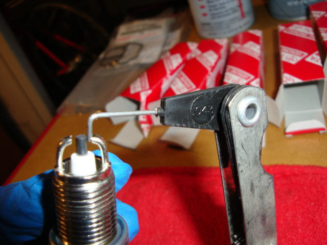

    these are the type I bought http://www.ebay.com/itm/6-PCS-TOYOT...NGS-K16TR11-/141721201644?hash=item20ff3debec
    denso k16tr11 and they come gapped at both prongs .043 from center electrode and it is impossible to gap them with a feeler gage, you have to use a wire gap tool like pictured below to check the gap because the prong has a curve to it to follow the shape of the center electrode. I rechecked all gaps to be sure but they were all spot on right out of the box on the denso but the ngk set I bought the first time, I had one plug with one prongs gap that was off

    Each gap should be .043" checked with a wire gauge because the electrode is curved. A blade can not measure a curved gap and if used will show a much smaller gap.
    The person on the phone at NGK was wrong, there is no "adding" the gaps. Additionally the spark fires across one of the gaps until it erodes to the point that the other gap is an easier path. Back and forth thru the life of the plug.
    Both plugs for a given coil fire with opposite polarity (they are in series), one from center to ground and the other from ground to center. After some time the "wear" will look different.
    Both the Denso and NGK plugs are pre-gapped, sometimes perfect sometimes not. NGKs have been known to sometimes come pre-gapped with the incorrect gap (smaller).
    I have bought and installed at least 100 Densos, 7 sets in my truck alone and they were all .043" aside from one here and there slightly off.
    And of course everyone knows that the 3.4 came from the factory with 3 Densos on one side and 3 NGKs on the other.
    Stolen pic.

    Well there you go. I, as well as many other people, were unaware of using the wire gauge to fit in the groove of the electrode to get the proper distance measurement! I guess you guys knew that when I mentioned using the blade gauge. Therefore, since I didn't gap my dealer plugs, I can somewhat assume that they are gapped properly. I'm glad to have learned something new today.
    It's funny, I even went back to the dealer to show the guy at the counter the "weird" .025 gap with my blade gauges, and he had no explanation. Apparently, even they all don't know, and they're the dealer! Where were you guys at the beginning of this thread!!! Haha!
