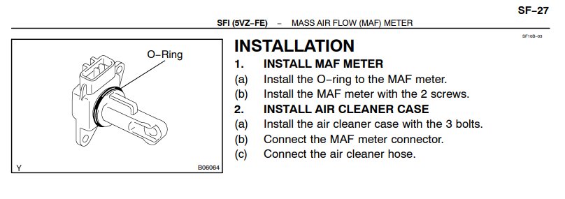

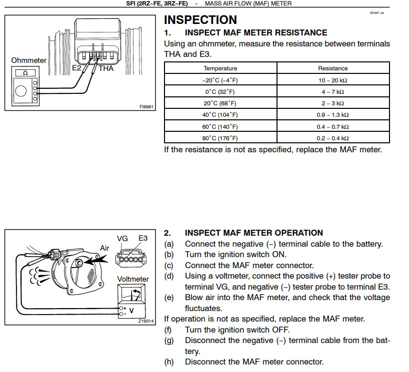

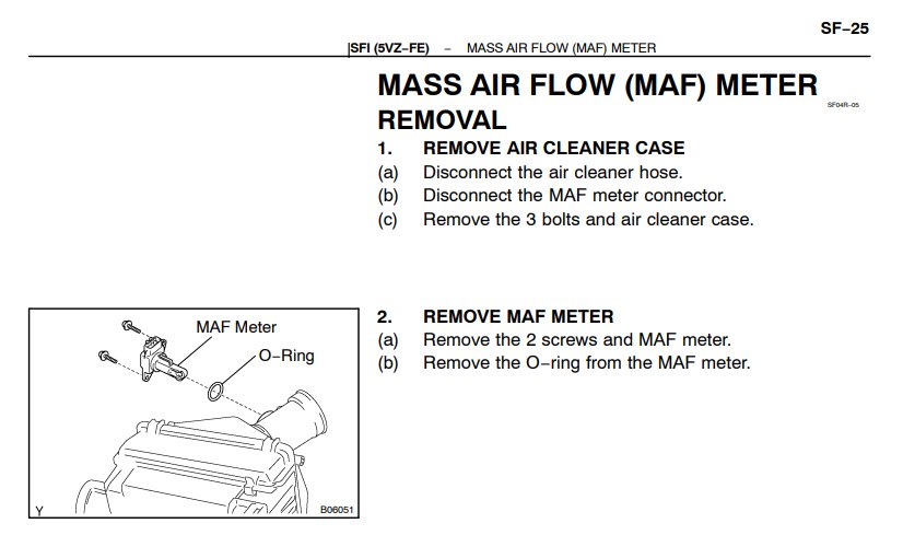

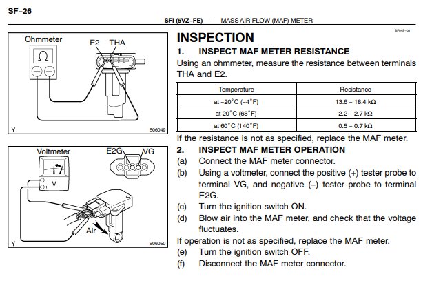

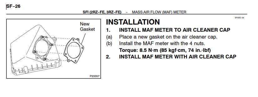

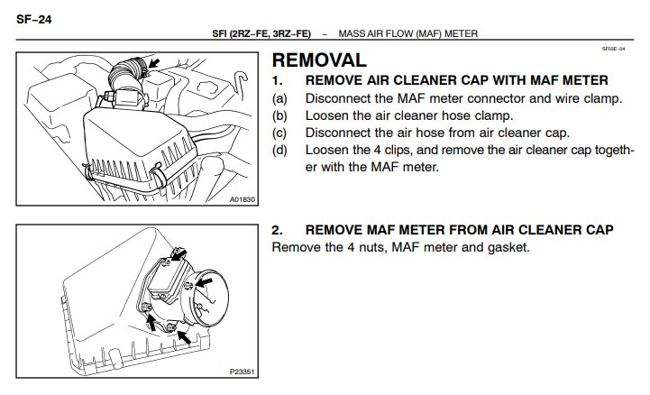

    If you do it yourself, I would just bite the bullet and pay for an OEM toyota sensor. 1st gen just does not play nice with aftermarket sensors. Also be sure to not jostle it around when installing. That filament is very fragile.
    Since you did not specify engine size, I'm including removal, testing and install steps for both 4 and 6 cyl engines. Also including a YT vid on cleaning at the end of this post.
    Removal for a 6cyl:
    Install for a 6cyl:
    Removal for a 4cyl:
    Install on a 4cyl:
    If you want to make sure, here is the test process for both 6 and 4 cyl MAFs:
    6cyl:
    4cyl:

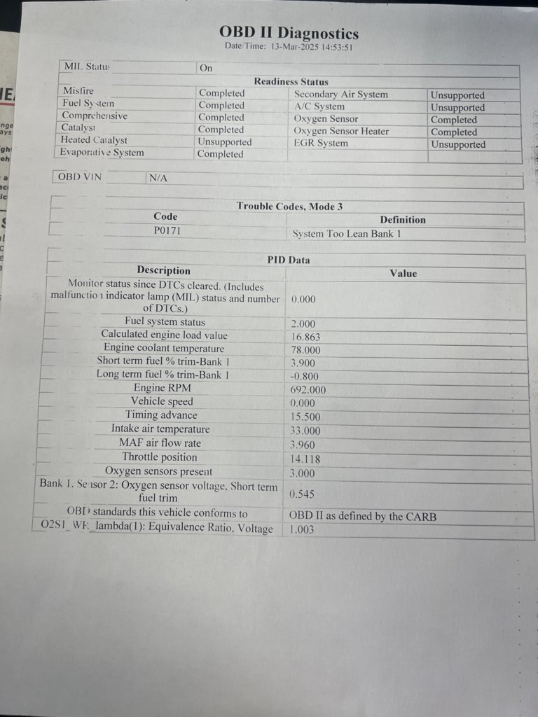

    I cleaned it and checked to make sure it didn’t need replacing. Engine light is back on. I do have this sheet of diagnostics I got from the emissions tester at my job and I don’t know if it means anything. Anyone know if any of this will help me?

    Is my input a take it to the bank diagnosis, no, but it appears to me that your MAF is over reporting air flow. The rule of thumb is 1 gram of air per second. 1 g/sec. Assuming she is a 3.4 so 3.2 to 3.6 is "acceptable". If she is a 4 cylinder then you are WAY off. Looking at the fuel trims and other readings, they are spot on.
    This is one of those diagnosis's that techs just hate, It is bad, kind of, not bad enough to make a call but just bad enough to pop a code. If it was in my stall I would say put a MAF in it "just to compare". You can spend a lot of time and $ diagnosing, the part is more expensive than the labor. If you choose to put a MAF in it, get it from the dealer even though Amazon and EBay say factory part, most of the time they are counterfit.

    was it 33 degrees outside when that test sheet done?

    No, it’s currently 70F, 21C. Engine wasn’t “hot” as it had sat for about 40 minutes but I thought maybe it was the engine bay temperature in Celsius?
