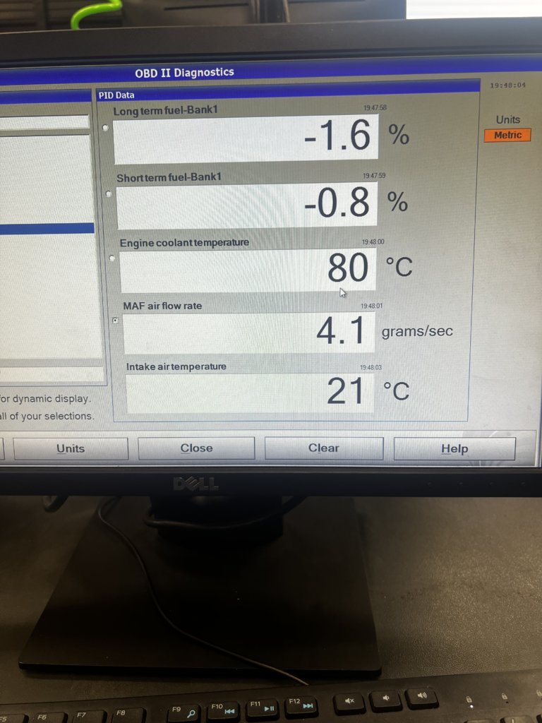

    After looking back at the coolant temperature and noticing it was 78 degrees, I'm assuming that all the temperatures are in F. If so, the reading of 33F is severely off. Is that a MAF issue?

    I was incorrect again. The temps were in C. This picture was taken after cleaning the temp sensor with MAF

    The light went off after cleaning the MAF better. I missed the 2 sensors inside the thing.
