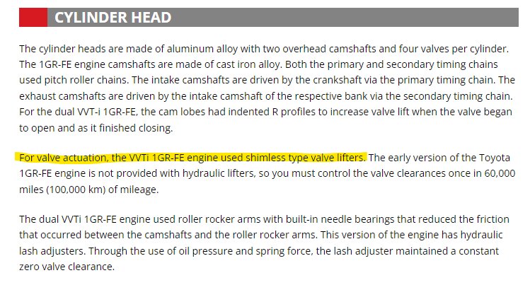

    2nd gen Tacomas specifically 2010's were VVTi 1GR-FE not Dual VVTi 1GR-FE.
    Toyota started production of the dual VVTi 1GR-FE engine in 2009, but I don't think it made it into Tacomas until the 2012 model year.
    Meaning the vast majority of 2nd gen Tacomas with "6 bangers" have lifters that could potentially get sticky.
    But thanks for the unnecessary an irrelevant feedback.
    Regardless of the exact cause, the solution remains the same and the issue was resolved.
    https://www.engine-specs.net/toyota/1gr-fe.html
