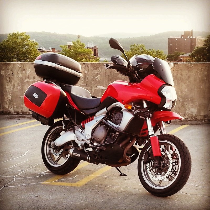

    I have a motorcycle that I have done a lot of painting for.
    I painted all the cases fenders and some other parts. Unfortunately I have finger prints in the clear in many spots. The paint may be dry, but it still quite soft for a while. I find up to a week.
