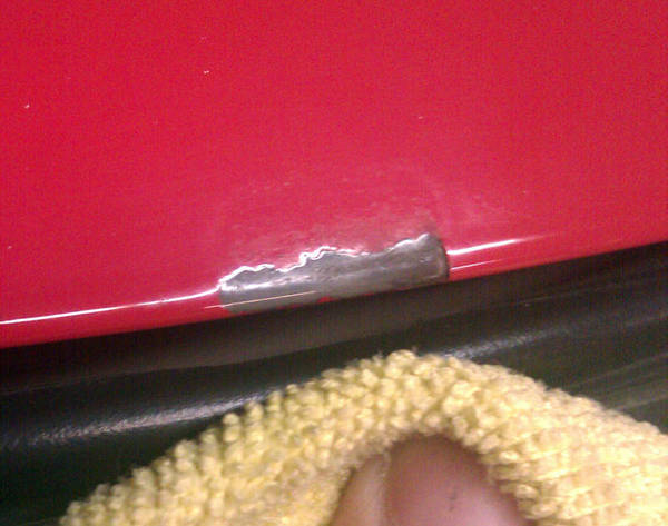

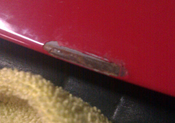

    You make a valid point. Just removed it, and.. not as bad as i thought! But still i need to fix it, down to the metal on the corner.
    There are only 2 spots! i thought 3 or 4. And most of the rust i saw, was the actual metal brackets rusting, not the hood. Looks way better removed too :D
    Here are the closest shots i could get for you.
    [​IMG] No mustache!

    Pic #2 looks like there is rust under the paint that has not come off yet.
    IMO that repair is beyond a DIY project unless you have some serious paint equipment and painting experience.

    That hood is starting to rust up pretty bad... In your second pic, you can see all the "scabbing" above the bare metal. That's all paint that's just ready to flake off because of the rust below it.
    Honestly man, take it to a shop. It's 5 minutes to pop off a hood, they can have it sanded, and painted up in a couple days, and it won't break the bank. And it will be DONE RIGHT!
    If you choose to do this yourself, you've got to do what the shop would do... That's strip off all the scabbing paint, remove all the rust, fill rusty dimples with fiberglass, sand, etc... Your repair area will end up nearly 4" wide by the end of it all. There's NO WAY you can touch up that big an area, and have it look half-decent.
    If you want to half-ass it, you could remove the scabbing, take a wire-wheel, or purple 3M sanding disc, and remove all the rust. Then hit the bare metal with an epoxy primer, or etch primer. Sand it a bit (use 500 grit) then touch it up. It will look like absolute shit, but at least the rust has stopped.
    Those are really your 2 options. But run it by your local shop, you may be surprised how inexpensive it would be to have such a small repair made.
