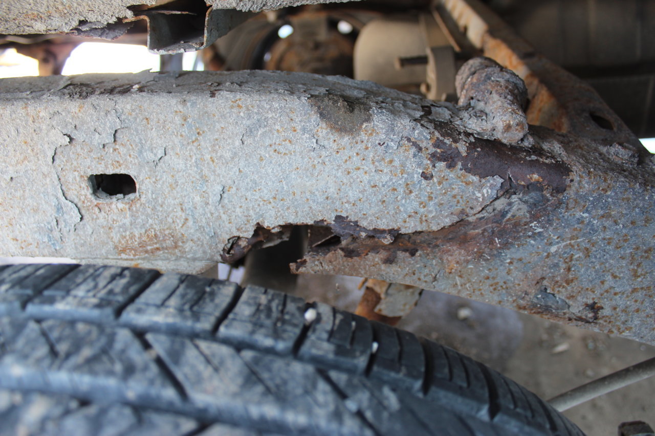

    well another one with a rusted through frame...
    what you need to do now is bang your frame throroughly with a hammer as you probably have more areas that are rusted through. This will allow you to see what sections are still good and what need repairs
    First area to check is where the leaf springs attach to the frame, right behind the cab, then by the gas tank and catalytic converter. These are usually the worst areas for rust.
    What is rotten and rusted through will have to be cut off then you can have repair patches welded in

    29,298
    J A Y

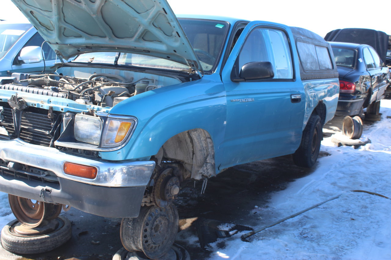

    this is a bad area too!

    Please tell me that's not a picture of your frame! If it is I would worry alot less about noises your hear from your transmission and ALOT more about getting that taken care of:eek:

    ewwww
    I'll add this to my list of critical areas
    This is behind the shock mount butress, isn't it?

    GQ7227
    GQ7227 mw survivor
    Dec 6, 2018
    #275019
    29,298
    J A Y
    yes, passenger side on that one, the ones i have checked out at the scrapyard seem to be CAKED with dirt,mud etc. behind there, which just holds moisture :notsure:
  6. Jun 14, 2020 at 1:52 PM
    #26
    GQ7227
    GQ7227 mw survivor
    Dec 6, 2018
    #275019
    29,298
    J A Y
    its not!!, just a local roasted taco of same age '96 and mileage as mine transplanted here from MI in 2000 with a dealer applied rubber frame coat per a carFax check
