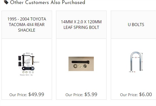

    Check with your dealer for new hardware. You can get Ubolts from an online vendor such as ToyTec, Low Range, Wheelers etc. Also, may as well replace the shocks too. I ended up destroying mine trying to get them off in the process of getting to my leafs. Rust sucks, plain and simple.

    Yes I got all new hardware for the leafs but not from general. I picked up the parts from a local shop.
    Anytime you replace the leafs you should always replace the shackles, bolts, and u bolts.

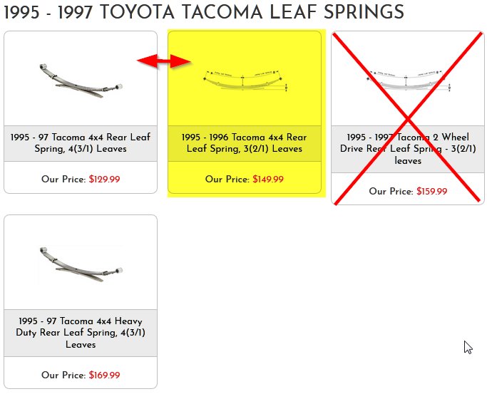

    It looks like at some point I will have to do the same and General Spring looks promising. I have 1995 4x4 and I see three different springs for my truck:
    "Rear Leaf Spring, 4(3/1) Leaves",
    "Rear Leaf Spring, 3(2/1) Leaves",
    "Heavy Duty Rear Leaf Spring, 4(3/1) Leaves"
    What is the difference? I have camper shell all the time and don want any lift (I mean keep is zero lift - you guys write that HD will give 1.5" lift), but I's like to be able to put few hundred pounds on the back without dragging its ass. I have my original springs made by Toyota in 1995 and they already look flat (with just camper shell on).
    And the quite important question, how much do they weight (shipping to Poland sucks)?

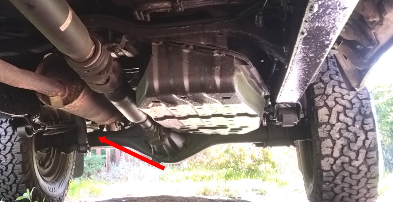

    Has anyone changed the bushing in the frame for the upper shackle bolt? Looking for advice in removing the original bushing and also wondering if there is a steel sleeve in the original bushing? Have a set of Wheelers poly bushings ready to go with my 5100’s and General HD leaf packs. The wheeler bushings don’t have a steel sleeve so assuming I’ll need to reuse the existing.

    Not sure why there are 3 and 4 leaf springs listed for the 95-97 4x4, maybe the 3 leaf is meant for the regular cab? Someone with an older truck can probably chime in here. As I alluded to earlier, though, if you put anything other than the HD springs in, and add a camper and several hundred pounds of weight, it will probably be sagging before long, and you'll regret it. If you're hauling weight around, you want the truck to have some rake when unloaded so that it sits level when loaded, otherwise you'll get the dreaded butt-dragging look that not only looks goofy, but causes adverse handling issues as well. Just my $.02, obviously, but go with the HDs, man.

    I don't know what is the difference - all three are for 4x4 by the website info.
    The main issue with HD would be if it requires different shocks from what I have which are the stock size. I do not haul stuff all the time, only camper shell. With that this is how the leaf spring looks like - practically flat.
    So the goal is to be able to load 500-600lb ocassionally on the back inside that camper and bot bottom up. Majority of driving is still empty or neglected weight inside the camper.
    The other question is how much these springs weight? More than 25lb each? General Springs does not list Poland as a destination country, but shipping to neighbor Germany still more than doubles the price. Need to figure out how to get Tacoma springs to Poland without breaking the bank.

    My 1995 Tacoma Regular Cab 4x4 had 3+1 leaf springs factory. (total of 4 leafs)
    So, what you want is the 3/1 HD springs.
