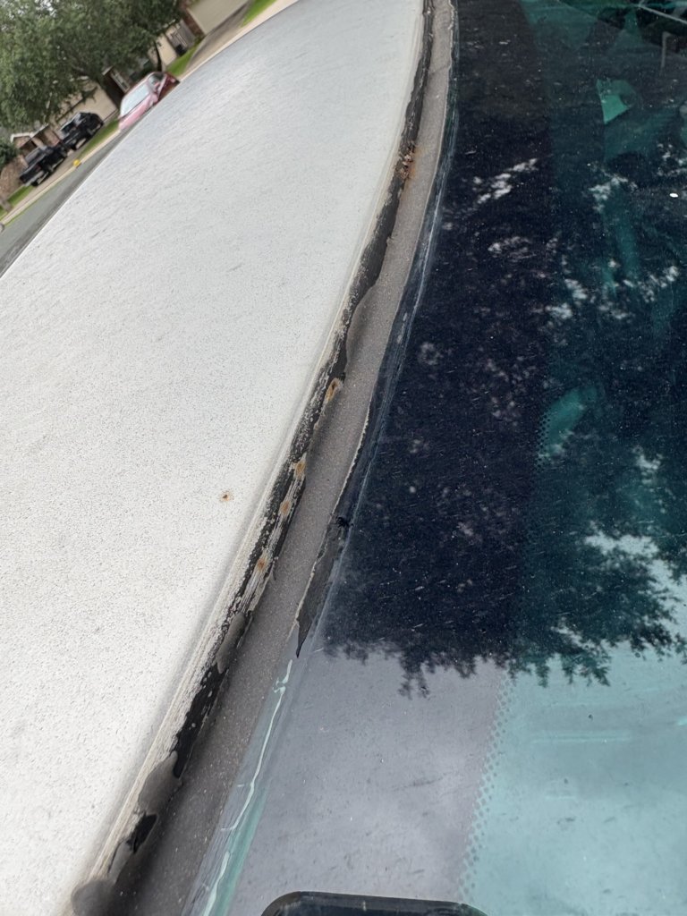

    Hi All,
    trying to fix the seal on my windshield any suggestions? I’ve attached a photo. Thanks!

    Clock Volt meter/LSPV Delete/Hyundai 16’s/FP gauge/after 9months of wrenching ZERO oil leaks
    the proper way is to remove windshield and get new mldng
    its not crazy expensive as my new windshield/mldng installed was $175 by local mobile glass vendor
    however
    this is what i did
    diff vehicle mind you
    i tried that 'mastic' too
    kept failing
    i took off the rubber mldng
    then cleaned groove and let dry
    used black 'self leveling' sealant
    good for my $2k vehicle
    lemme get a pix...........
