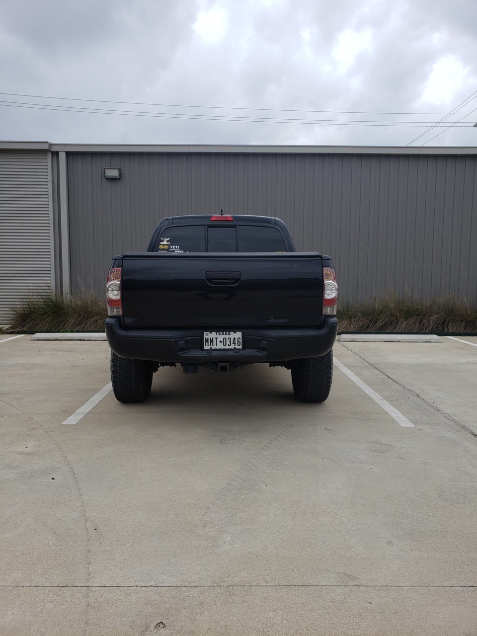

    Got a 2014 trd sport with some nice taco lean in the rear, almost an inch difference (39" from ground on back passenger side, 38" driver side rear). I got a fresh pair of 2019 trd off-road leaf springs I'm trying to buy off FB to swap in. My only problem is I think my AAL has flattened out a bit from hauling. My question is would a fresh set of springs, and that old AAL do what I need it to do to correct the lean? Anyone done this before? A 1/2" spacer plate on top the coilovers wouldn't hurt either.

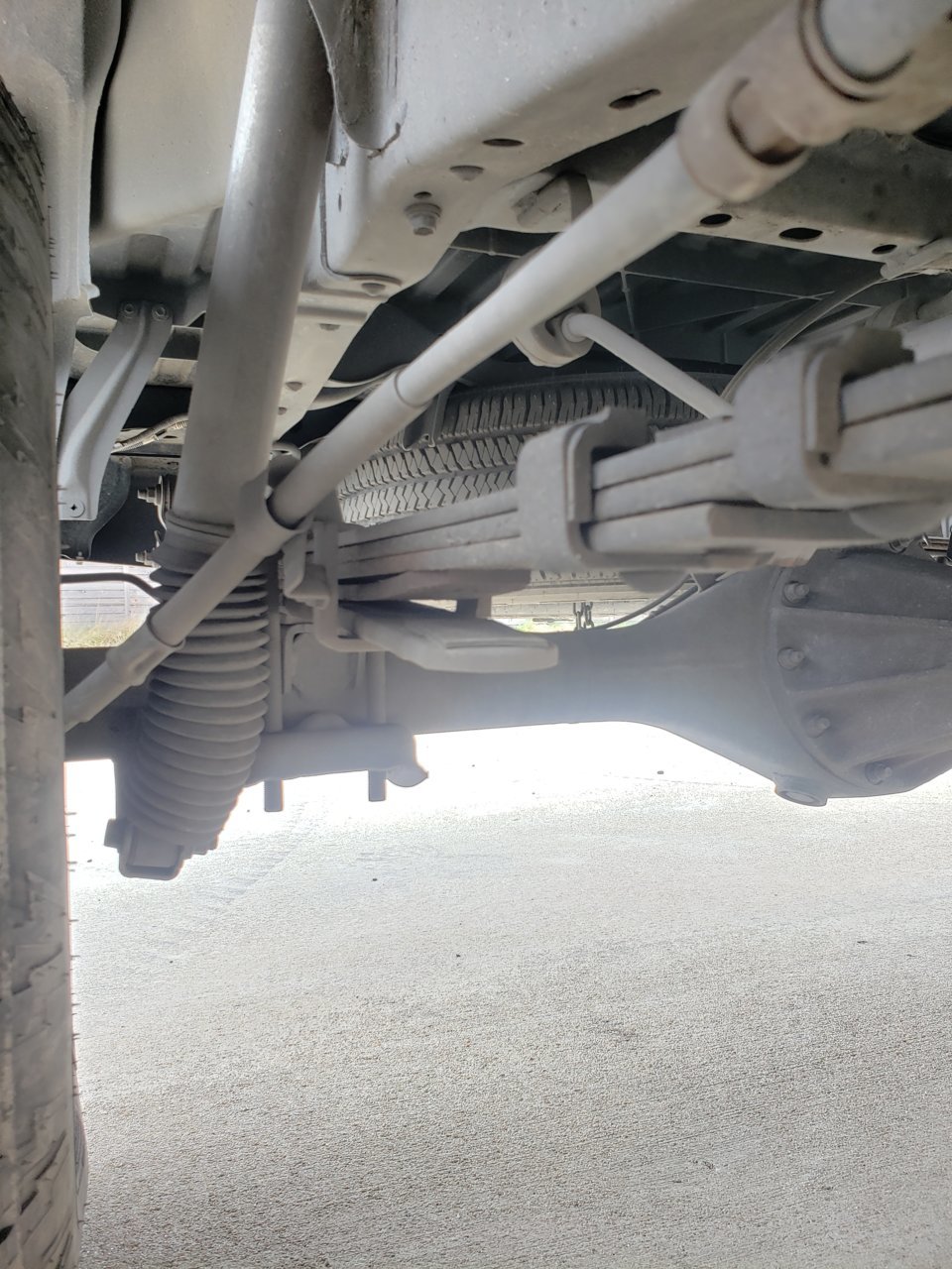

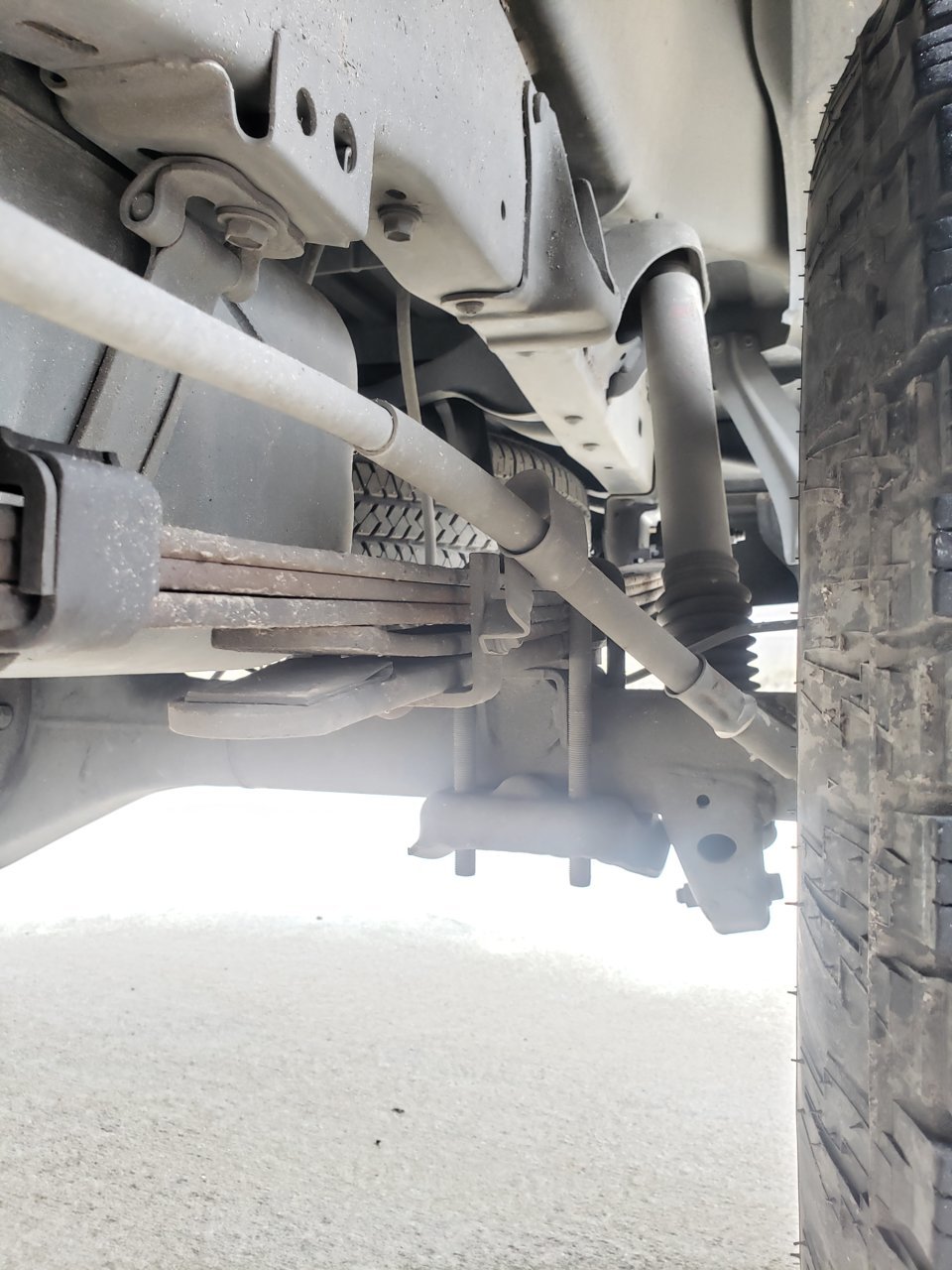

    Pics for reference
    Noticable difference in height between the AAL and stock springs

    Now I've got a full tank of gas, but there's no way that a fresh set of springs and that AAL wouldn't help fix the problem. Just need some other input before I pull the trigger on these. I'd love to get some OME springs down the road.
