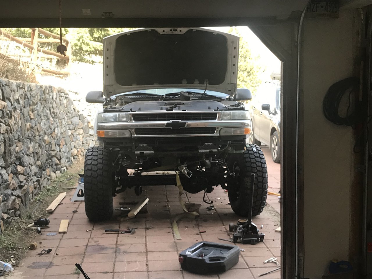

    So Toyota determined I off-roaded because of the death grinds on my diff and skids. I decided to get out of off roading a car I owe money and on.
    So I solid axle swapped a Tahoe put it on one tons and 37s
