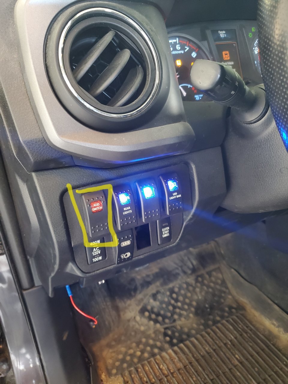

    It was a good solution and very well thought out.. but if you're anything like me, just hearing anything about electronics makes me cringe so I was talking more plug-n-play kits for sale somewhere. Otherwise, I'm fine with my ABS and trac control being off, the oversized tires have enough for me to go 70mph on the highway in a downpour
    Just as a funny told-ya-so, he did say his truck was a manual in his last paragraph of his 1st post :Da

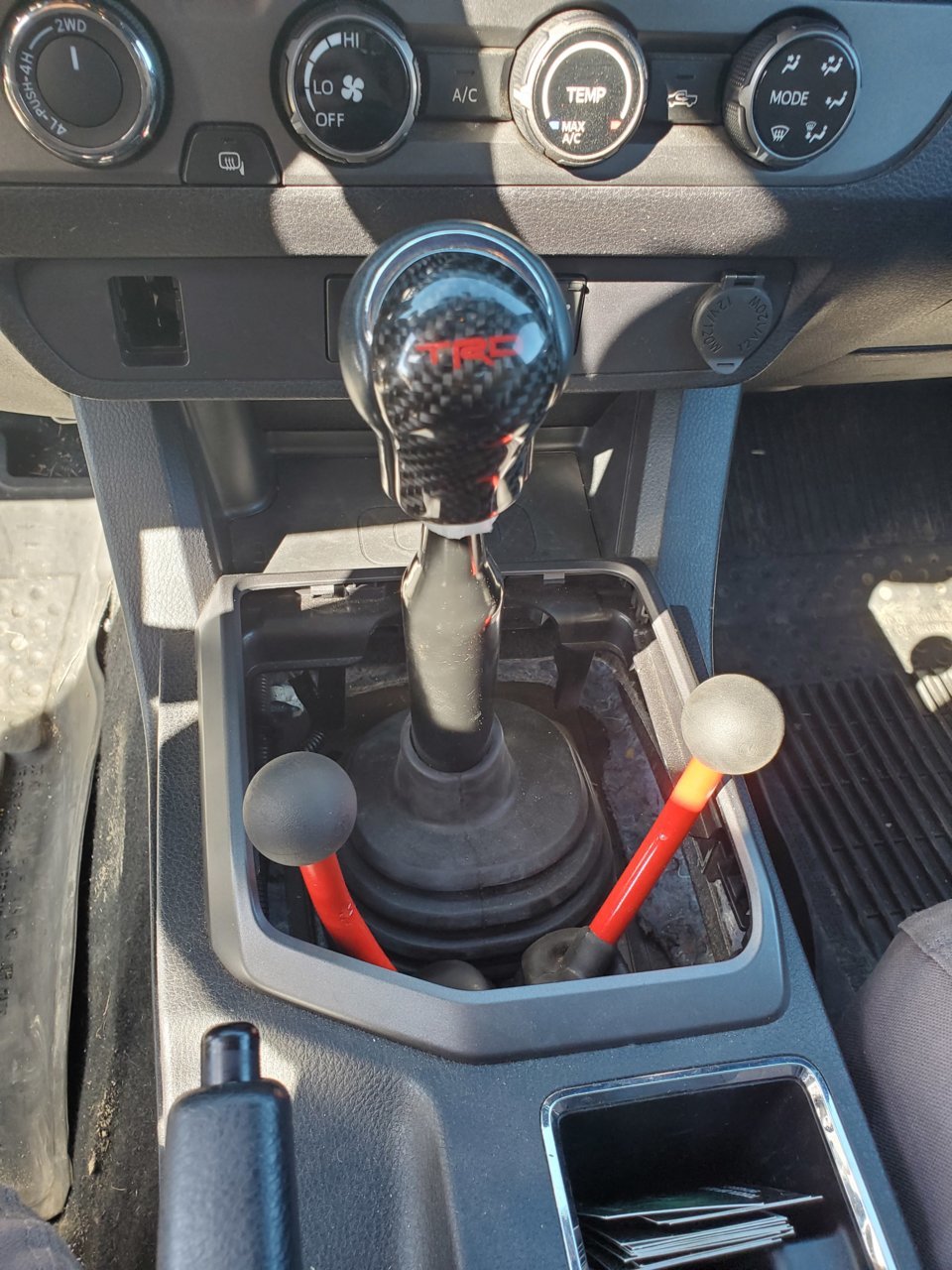

    Any issues with shifters interfering w each other?

    I know for my twin sticks, my Transmission shifter touches my Hi/N/Lo shifter when I go in Reverse but there's enough play that it's not hurting anything. It also depends on how intricate you want to make your bends for the shifters. I'm sure I could've bent it a little more but it works and looks good so I'm not concerned about it

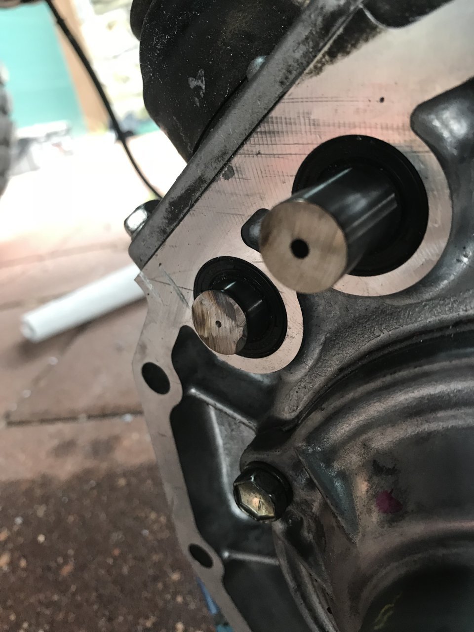

    2DF7693A-D675-49CC-AF2B-3209DC6B6BAE.jpg 7D98DE4F-0896-4023-AA96-27AF168416EA.jpg

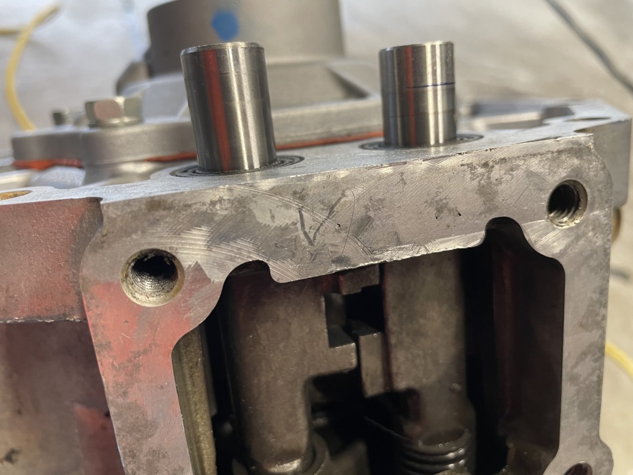

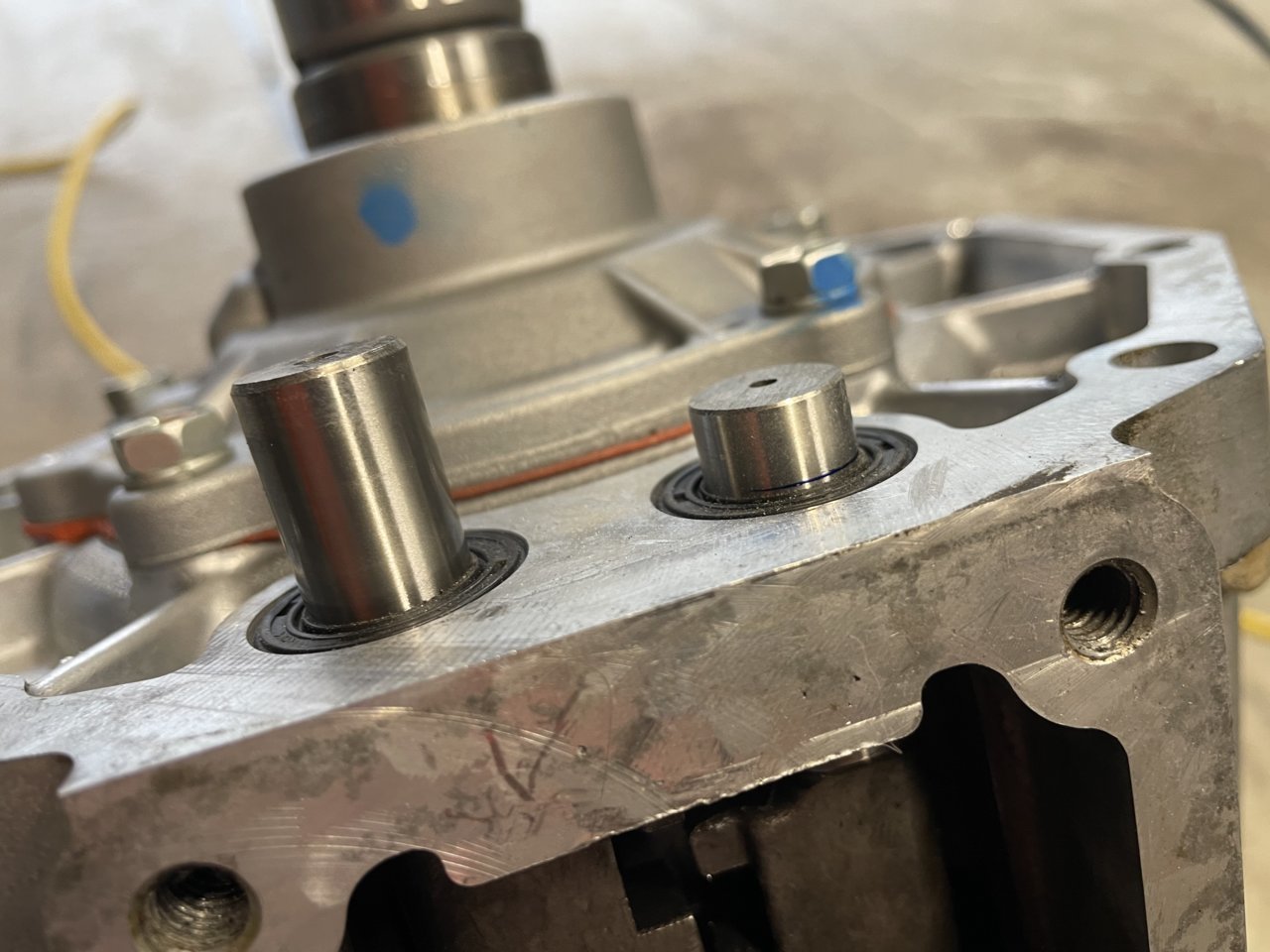

    Please note pen line on right shaft 2/4WD shaft. Is nothing stopping me from grinding almost right back to the pen line? Page 1 says grind an 1/8th off but I am not seeing why I can’t take a whole lot more off. I’ve pushed and pulled and I personally can’t see why not.
    @Dkarr13 @bravinci or others who may know. Thanks in advance

    If you're 100% sure that it is for sure in gear, I don't see why you couldn't cut it back that far... It seems odd that there's that big of a difference between our transfer cases though...

    I'm about to take this on. Just curious how much you ended up taking off of the shift rails? My 2wd/4wd shift rail (the right one in your picture) looks similar length (~22mm out) when toggled back and fourth

    Cut as much as possible to be flush with the seal in the retracted state, just don't let them go past the o-ring. You'll still need to cut inside the bell housing tho

    No you can go flush. Once you open up the FJ case, you'll see the shift rods are mechanically stopped from being slammed in any further. But there's really no order tbh. It's just
    -swap out input shaft/gear ring
    -reassemble FJ case with gasket maker (really slather it on, mine after 2 years is starting to leak a tiny bit)
    -grind down Shift rods
    -grind down clearance in tranny billet
    -reinstall case with tranny, install shift levers to ensure you cut out enough clearance
    -install higher spring tension springs to case
    You don't really need to worry about numbers, from what I've seen. Some people barely cut into the tranny billet although I had to trim a ton; I thought I was gonna break through. Its just one of those things where manufacturers cant get everything exactly perfect. But I also have the 6spd so I just bent the shift levers to come up through the gear shifter boot. Again, make sure to use a good gasket maker

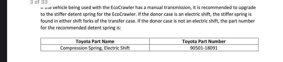

    Guy on a Facebook group page posted the build process on his eco crawler and the electric transfer cases have the stiffer Detent springs. I used the springs from my old case for the assembly. I’ll see how it goes before proceeding.
