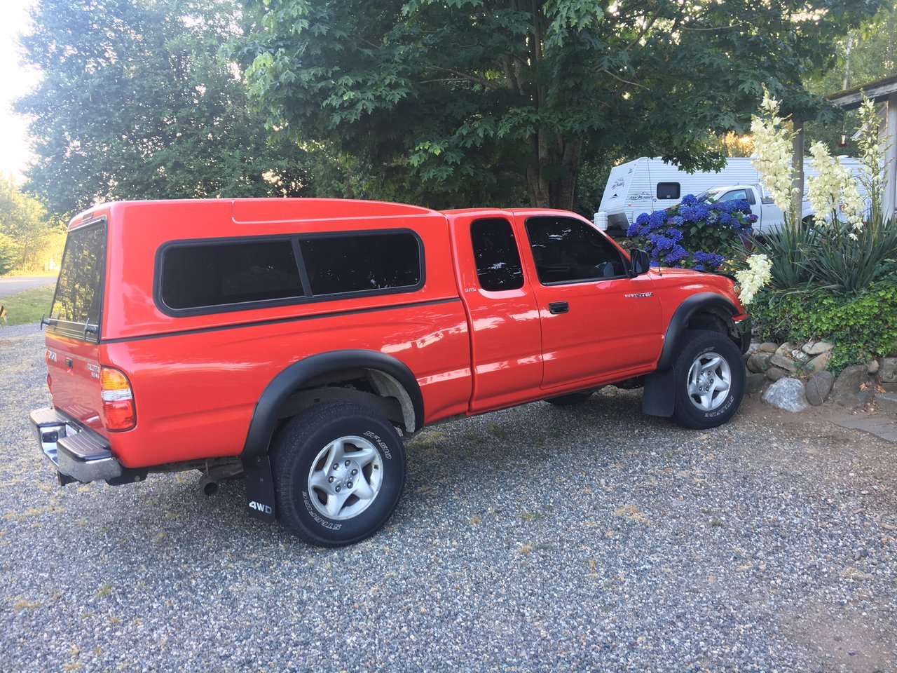

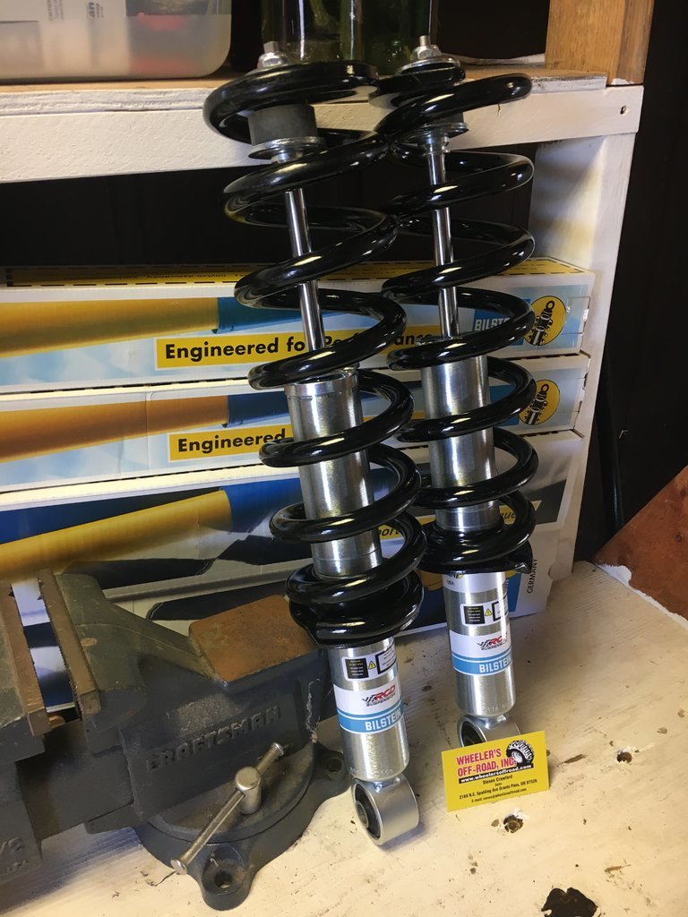

    Just in case anyone else's ever wants to know, FJ coils do work on our first gen tacomas. I put stock height FJ coils out of a 2008 on my truck with some adjustable 5100s set at 0 and they gave me about a 2" lift in the front. Front end feels about the same for stiffness as the stock coils and rides down the road good. I've only drove it about 5 miles so far but I'll post again when I've got a few hundred miles on them.

  8. Jul 13, 2017 at 4:46 PM
    01GreenTacoma
    01GreenTacoma Well-Known Member
    Jan 9, 2017
    #207086
    848
    Looks great! What did the FJ springs run you?

  10. Jul 13, 2017 at 9:11 PM
    buckmaster243
    buckmaster243 [OP] I don’t know what to do with my hands
    Sep 21, 2014
    #138821
    1,819
    Buck
    Washington
    2013 DCLB, 2023 4runner
    Thanks! The FJ springs were free, my dad put eibachs in his to level it out. I will need to get it re aligned the tires definetly have some camber to them.

  13. Jul 14, 2017 at 9:52 AM
    01GreenTacoma
    Jan 9, 2017
    #207086
    848
    Is their any way you could measure from the ground to bottom of your front fender flares? I'm curious how your FJ spring lift compares to my stock springs with 5100's set on the highest setting. My ground to bottom of fender flare Is around 38/3/8" on each side with a top plate Spacers to account for the lean on the drivers side.
