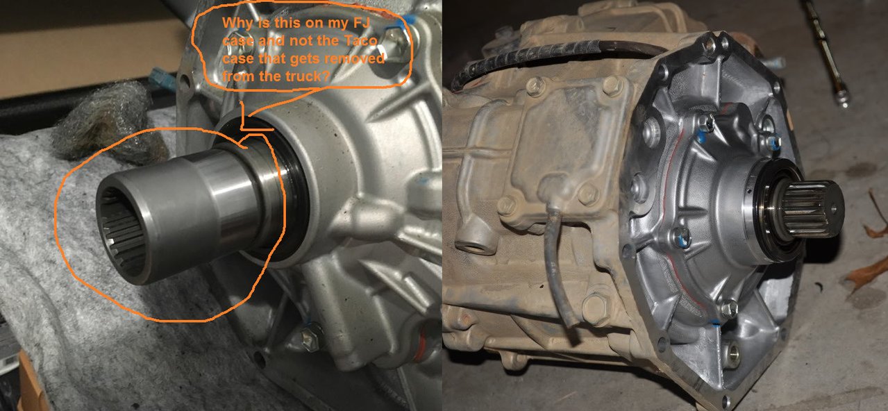

    Excuse my revival of an old thread, but the FJ case I bought seems to have an extra piece at the end of it, whereas the tacoma case that you removed in the pictures here does not have it. Can anyone explain what this is and how to remove it or if I bought the wrong case?
  7. Mar 15, 2018 at 9:06 PM
    #87
    adamw
    adamw Well-Known Member
    Jan 25, 2011
    #49891
    220
    sunnyvale, CA
    06 prerunner-> FJC 4x4 swap
    That input shaft on the fj case mates to an auto trans. you’ll need to split the cases and swap the shafts between your old tacoma case and the fj one.

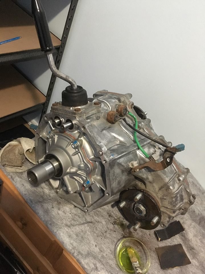

    Im getting really mixed answers from many different people, could possibly be due to confusion.
    I have a (2007 Tacoma 4x4 Automatic Trans)
    I bought a transfer case from a (2010 FJ Cruiser 4x4 Automatic Trans)
    Will the transfer case I purchased work in my truck without any modification to the transfer case itself? I included a picture of the case in this reply. The input shaft on the transfer case I purchased looks different from the transfer case in the original post. Although that could possibly be from OP having a manual trans taco.
  10. Mar 16, 2018 at 3:10 PM
    #90
    vssman
    vssman Rocket Engineer
    Jun 17, 2013
    #106440
    10,000
    Paul
    Naugatuck, CT
    2013 SR5 double cab
    The first post has a great description. The photo you posted above should fit in an automatic Tacoma without having to swap input shafts. Only manual transmission Tacomas should need the input swap due to a different spline count. Now for what it's worth, I haven't done the swap (yet). Just have researched it a bit.

  11. Mar 16, 2018 at 3:13 PM
    #91
    NeonHeights
    NeonHeights Well-Known Member
    Feb 21, 2017
    #211262
    455
    I think so too.
    I believe the confusion came from me sending people half a picture of the t-case I bought, which created some confusion. All good now, Wyatt cleared everything up in an email I just sent him as well.
    Was really getting freaked out at the idea of having an unusable t-case sitting in my house that wont fit my truck haha. Twin Sticks are ordered so should be doing the swap in the next few weeks once it gets warmer
