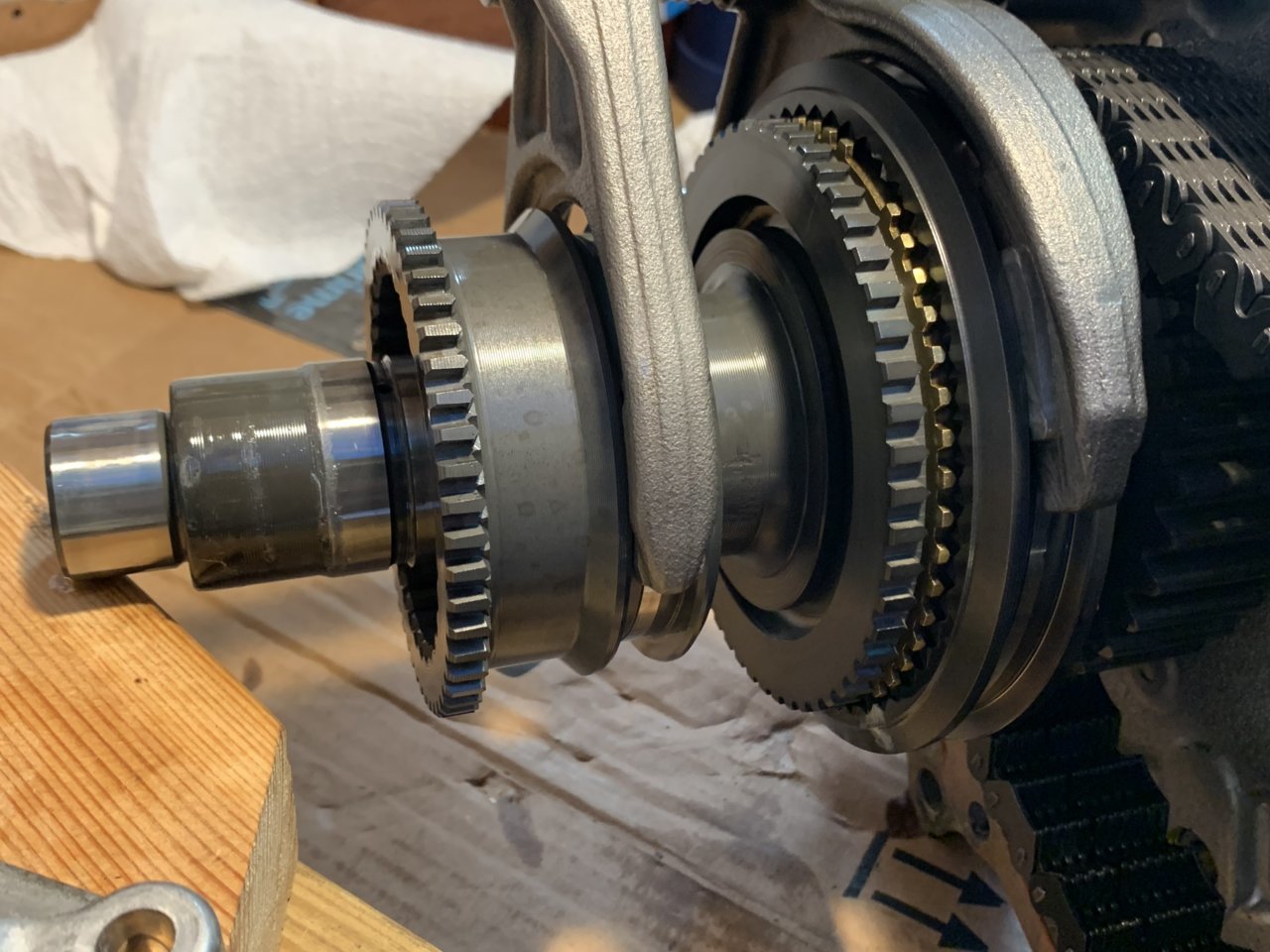

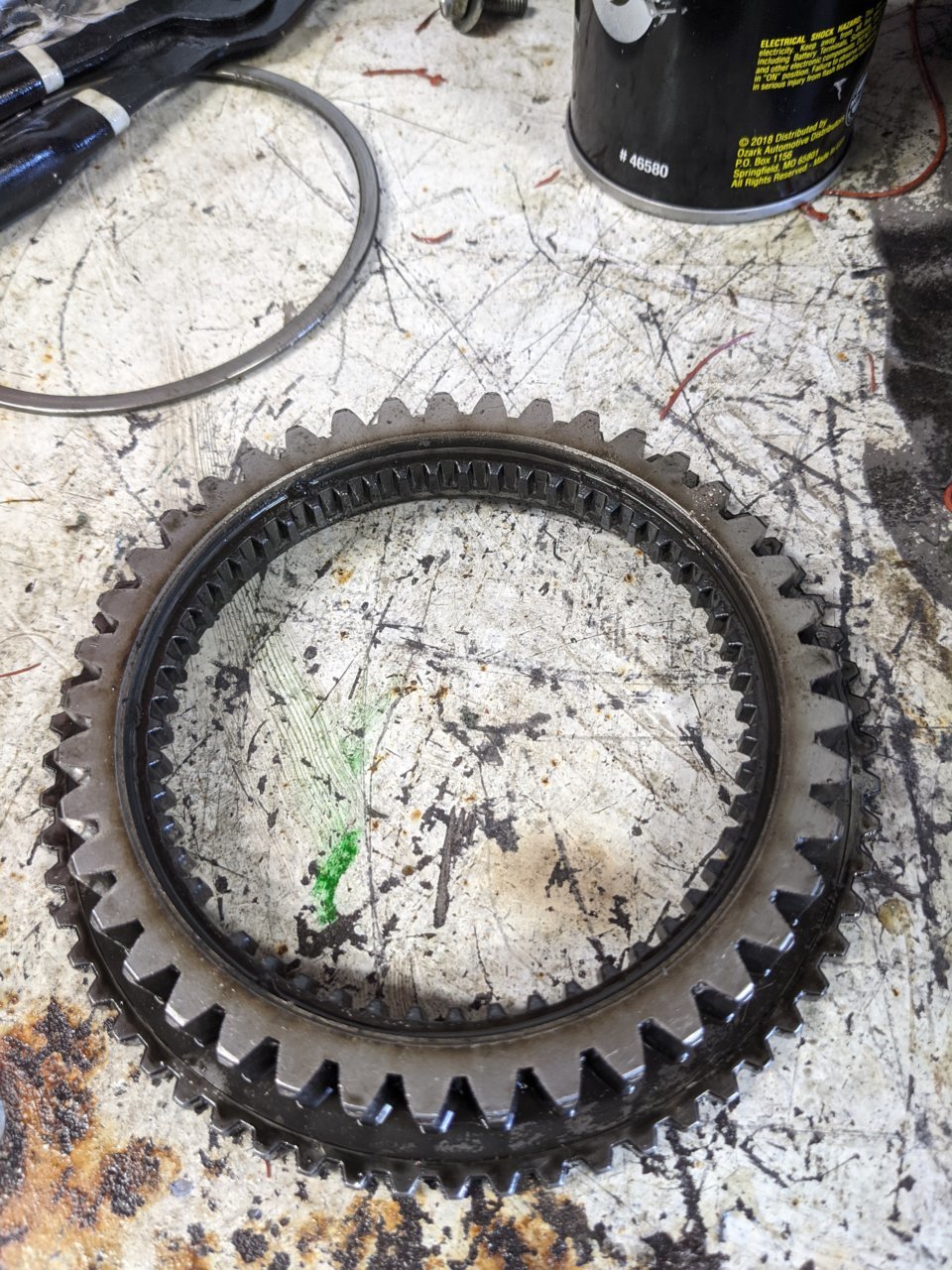

  14. Jul 11, 2021 at 12:19 PM
    #114
    GoogleybearR6
    GoogleybearR6 Well-Known Member
    Aug 16, 2017
    #226991
    104
    Andrew
    Yucaipa, CA
    2010 TRD Sport 4x4 6spd

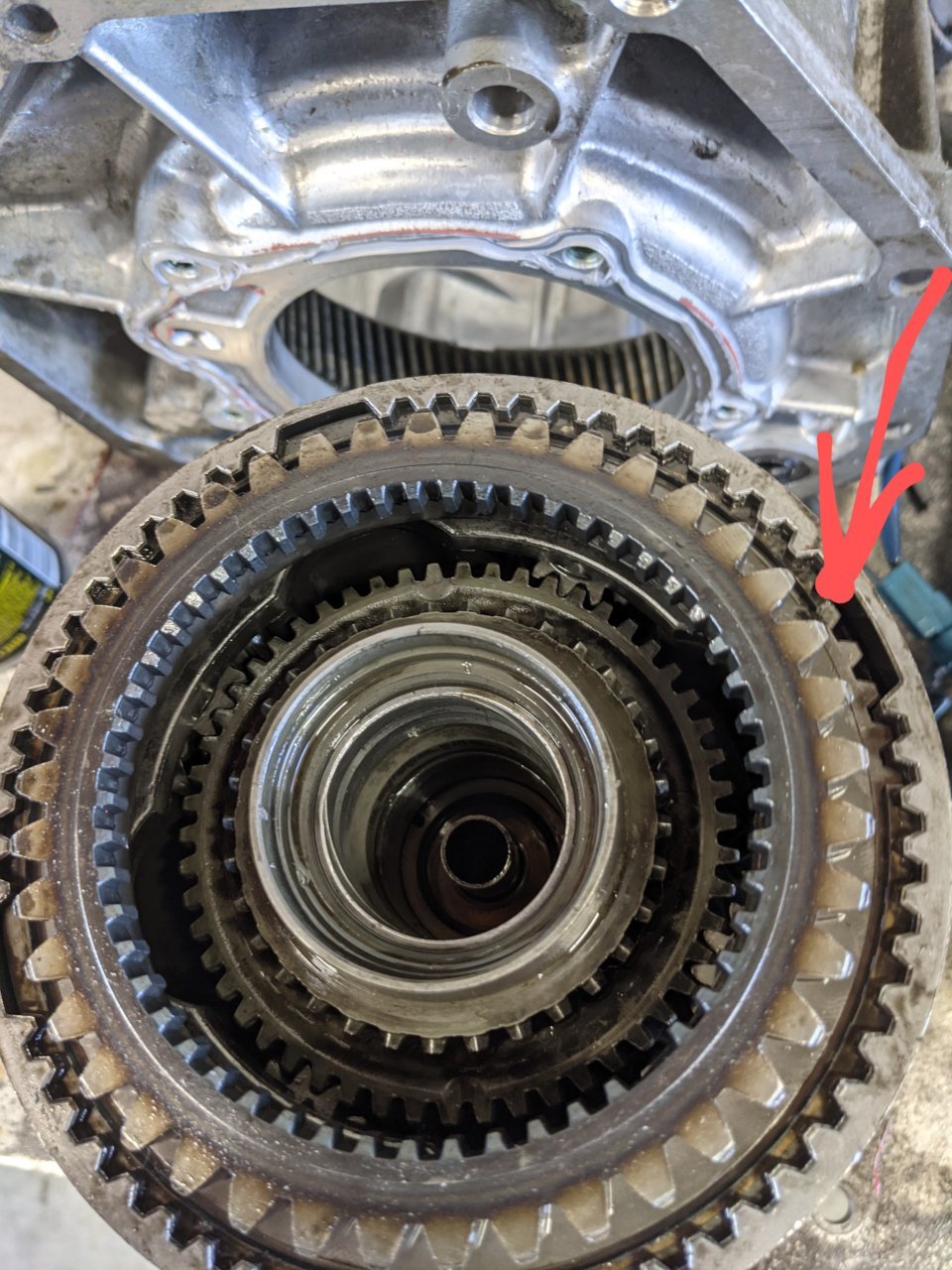

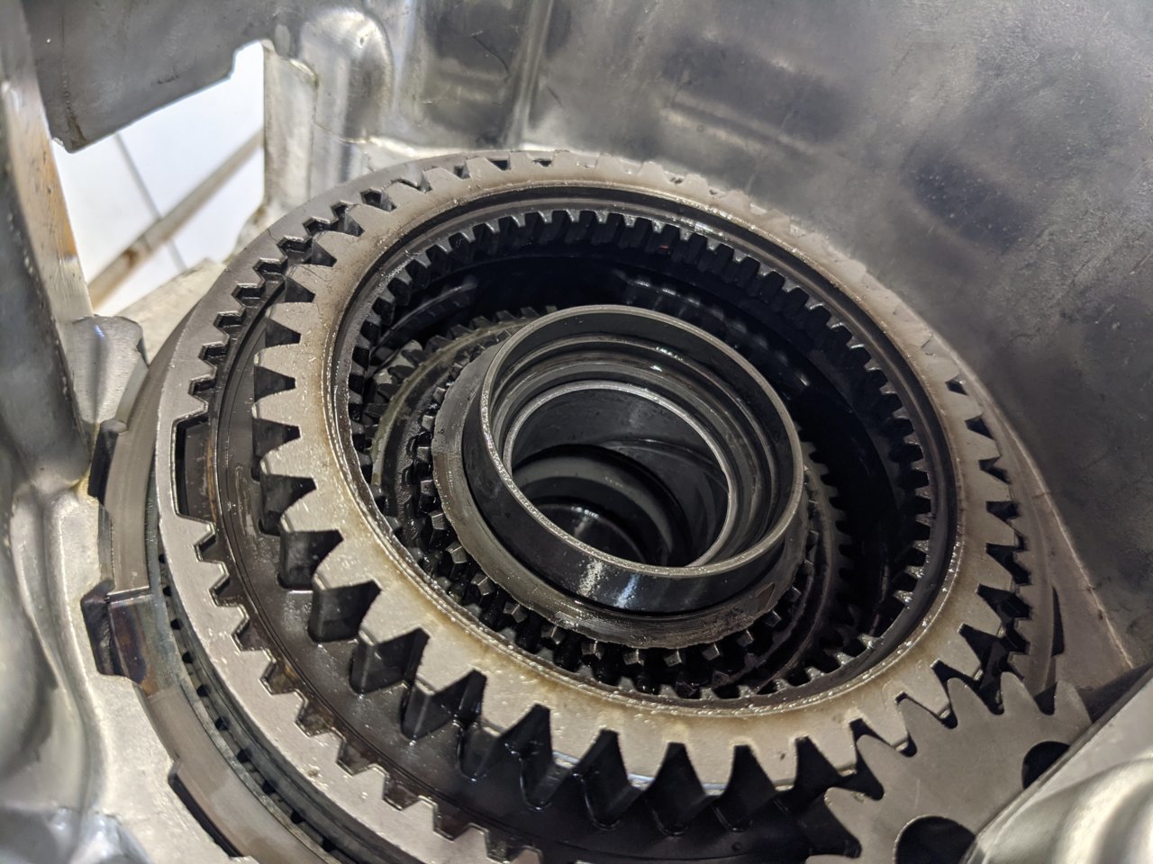

    I just ran into this issue and was looking on this thread and couldn't find anything about it. The flush ring gear from the fj case needs to be swapped on to the 22 spline input gear that will go into your new case. If you were to keep the shallow ring gear from the electronic case you loose the ability to shift into neutral and end up with 2 low range shift points. The first being partial gear engagement to low range (where neutral should be) and the 2nd shift point full engagement to low range.
    Here is the flush ring gear installed. The arrow points to the snap ring that needs to be taken out to remove the ring gear.
    dborrer and BassAckwards like this.

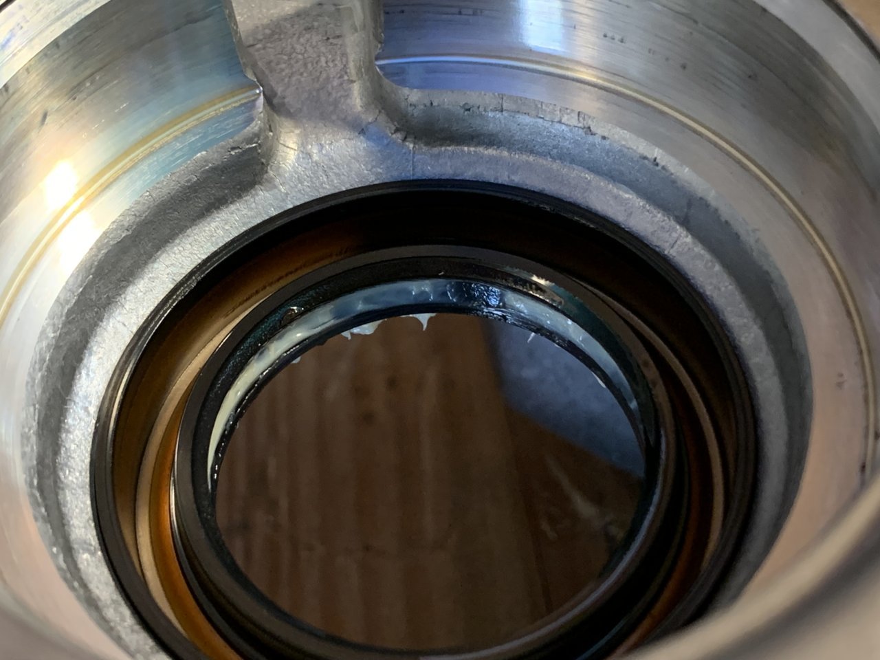

  19. Dec 27, 2022 at 6:50 PM
    #119
    ToyotaRoamer86
    ToyotaRoamer86 Well-Known Member
    Jun 20, 2017
    #221993
    520
    Brandon
    Frisco, CO
    2007 Tacoma TRD Sport
    Why can I not find the correct front-bearing retainer seal? The options Toyota gives do not cover the holes on the stub where the o-ring is. Any ideas people? It just causes a leak of fluid at the pin hole.
