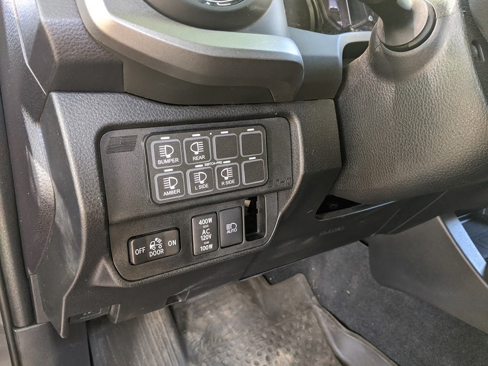

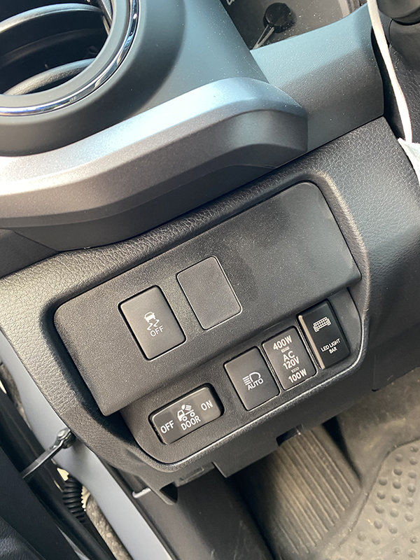

    I am trying to figure out how to get my switch pros 9100 mounted inside my cab. I am probably going to go with the SDHQ mount panel but they are telling me it won't work as the VSC button in the top location cannot be moved. There is a blank "tall" button spot at the bottom. Did some research and found that FJ Cruiser has a tall looking VSC button.
    I was wondering if anyone has done this or know if it'll fit? Size and connector in the back. Thanks guys!
    I need to move the VSC button to where my current LED Light Bar button is (that will be removed)

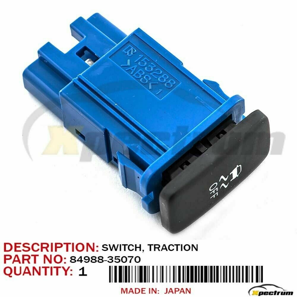

    The button that I found upon research from an FJ Cruiser (PN: 84988-35070)

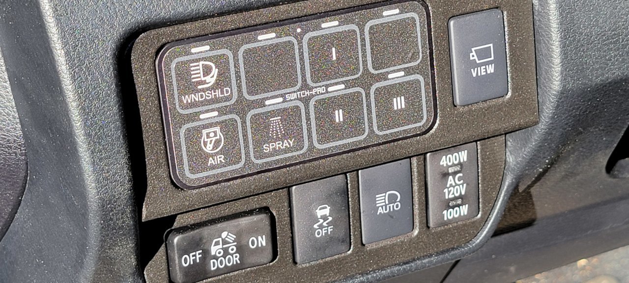

    When I replaced my switch panel, I found an aftermarket option that included short switches only on both rows. The short OEM switches in that panel all have plastic tabs to ensure they can only be put back in their specific holes, but aftermarket ones are all the same shape/size, so the OEM switches can fit into any panel once the plastic tabs are trimmed off with a dremel. So for the scenario, tis would also work with the original button if there's an option that has short switches only on the bottom row

    Buy from @MESO when his panel becomes available. It's fully customizable with the number of buttons, what switch panel (if any), size of switches, etc. You can find it here. I know it sucks to wait, I waited months before finally finishing up my SP installation because I needed this part, but it was completely worth it over running switches to new locations.
