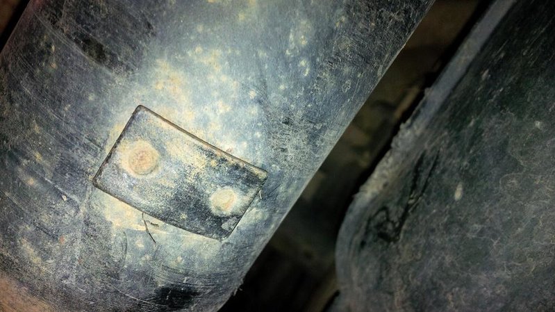

    Not sure of the geometry with your Rear LT, but you may need to slightly trim the gas tank skid if you still have it on. A small weight welded onto the driveshaft for me a few others I know catches when the wheel is fully stuffed (very loud). I have Metaltech's Icon 2.5 rear kit
    Hope the picture worked

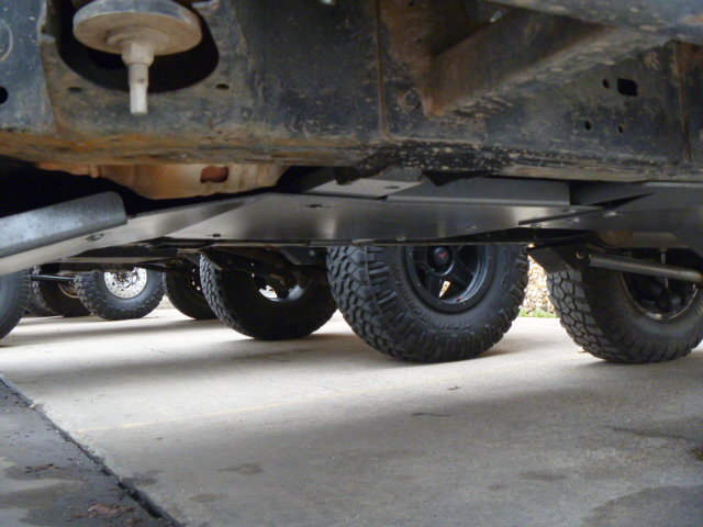

    I run Bud builts tank skid since thats low hanging fruit besides the rear diff. The tummy tuck with Lefty pulled the TC right up to inside the frame
    This is where the FJ used to have that lower crossmember that holds the T/C- mine is cut off and a higher one bolted in
    The gas tank now sit lower
    Never had any issues with the skids on the Drive shaft balance weight. At present- the rear sits more like a 4 1/2" lift with the +2" rear springs and 1.5" spacer. The 3.5" All Pro springs sat higher but would fall out of the buckets when articulating so I got the longer MT springs
