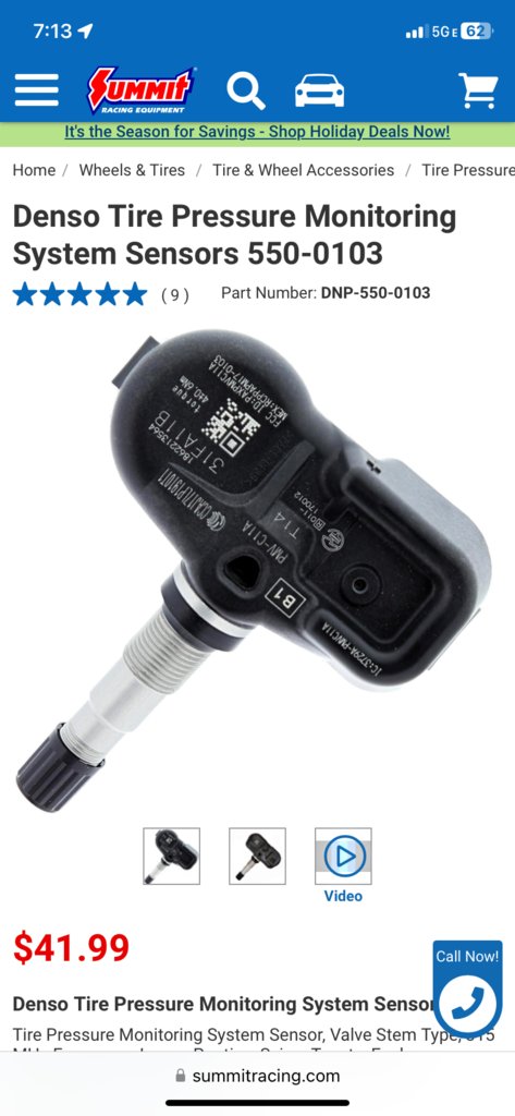

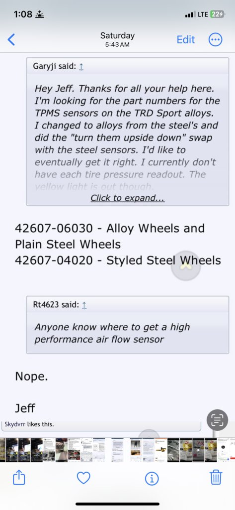

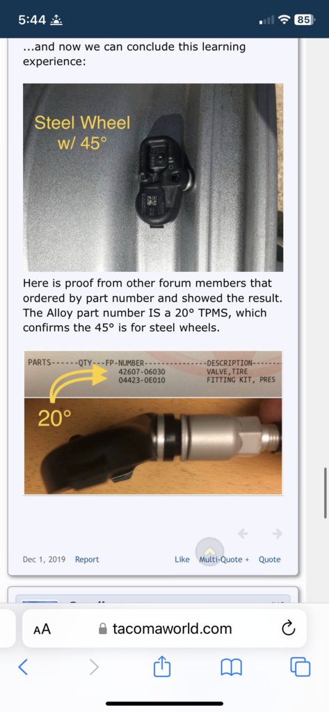

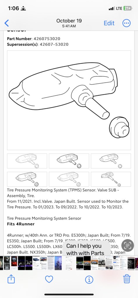

    2012 getting new wheels and figure I would put new sensors in.
    I looked thru a bunch of conflicting info on the 20 or 40 degree tpms sensors for fj type 17 steelies.
    What is the part number?
