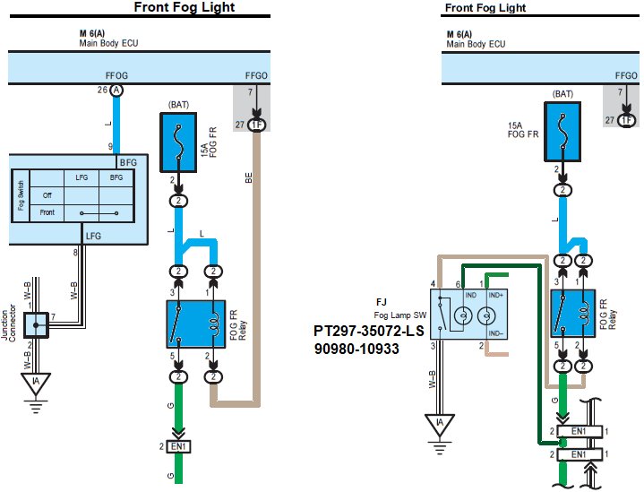

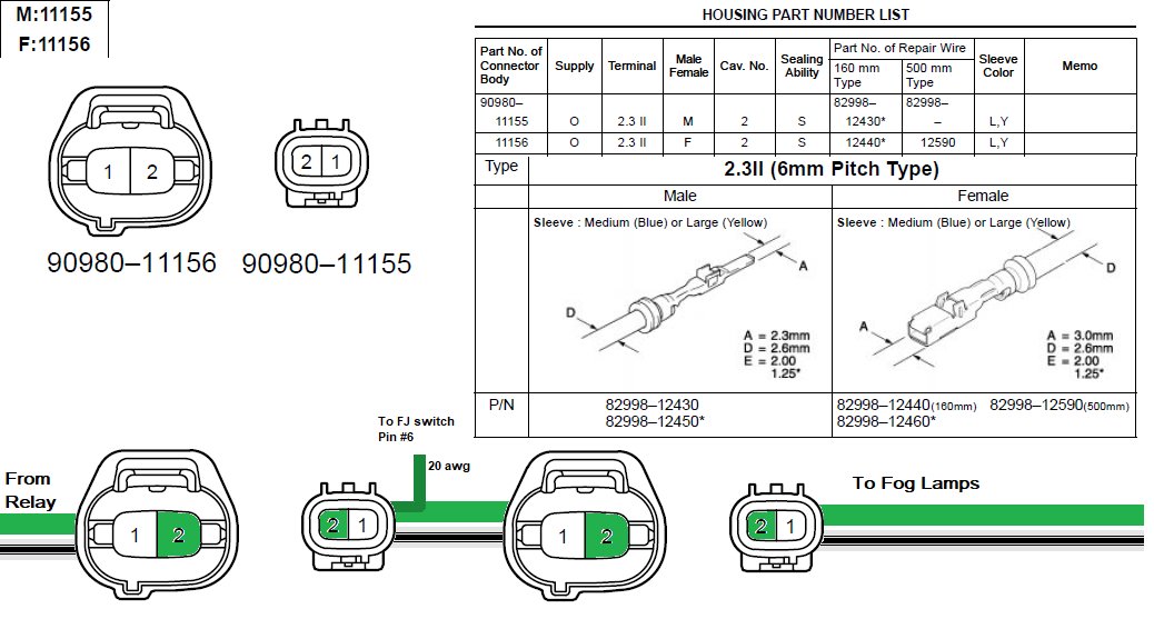

    Connector 90980-10933 uses 090/2.3II female terminals.
    See this for items:
    FJ switch (PT297-35072-LS) to replace Tacoma 2nd Gen Fog switch
    T-harness (itty bitty) for indication lamp on switch.

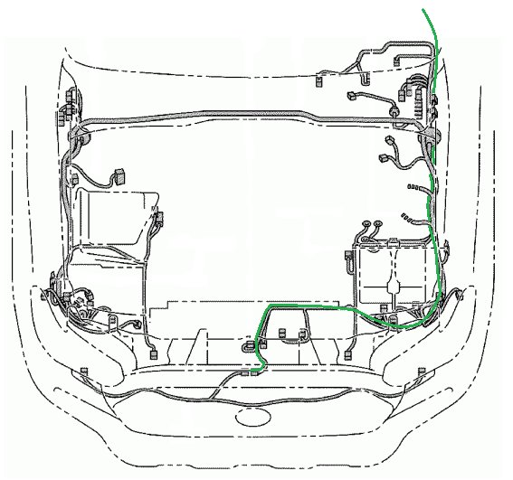

    Routing of loomed and secured 20 awg wire.

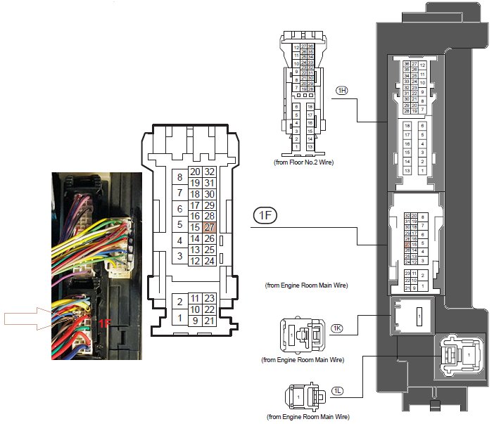

    Identify pin 27 on connector 1F and cut (leave enough wire to crimp a connector to return to OEM...or not)
    Fog will be always available, so don't forget to turn switch OFF.
    Indicator and dash bulbs on the FJ switch can be swapped for your preferred color. (sort of...)
