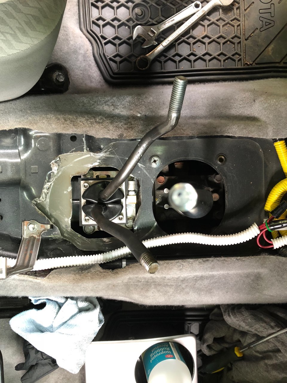

    Now I’m not a mechanic by any means but I was able to do 99% of this install myself. I just needed help from a neighbour to weld an additional piece into one of the shifter handles.

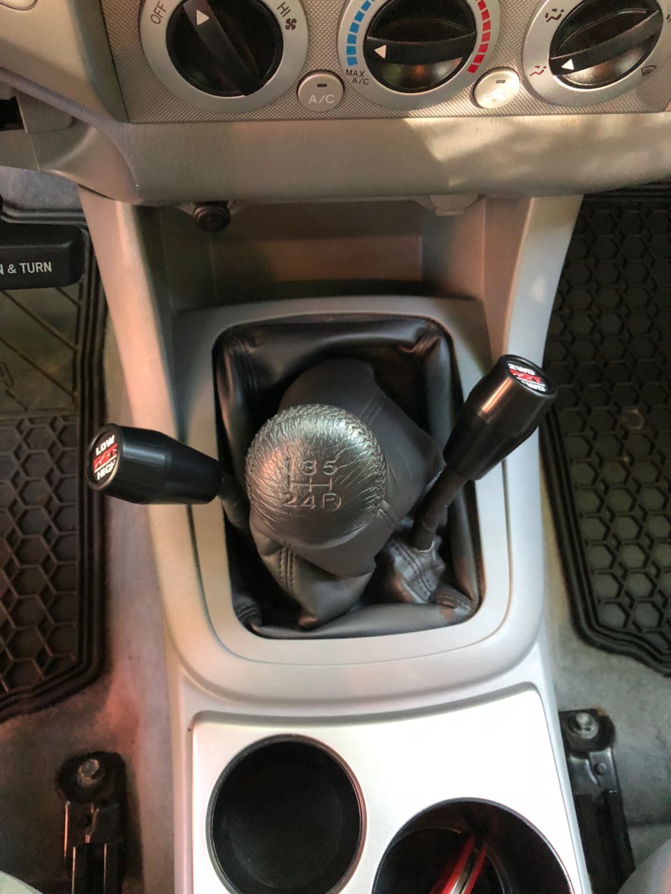

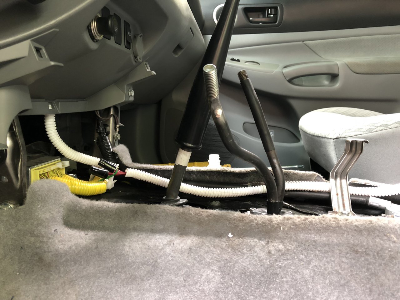

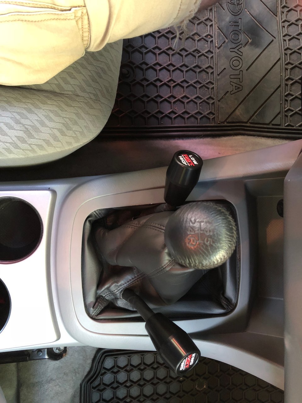

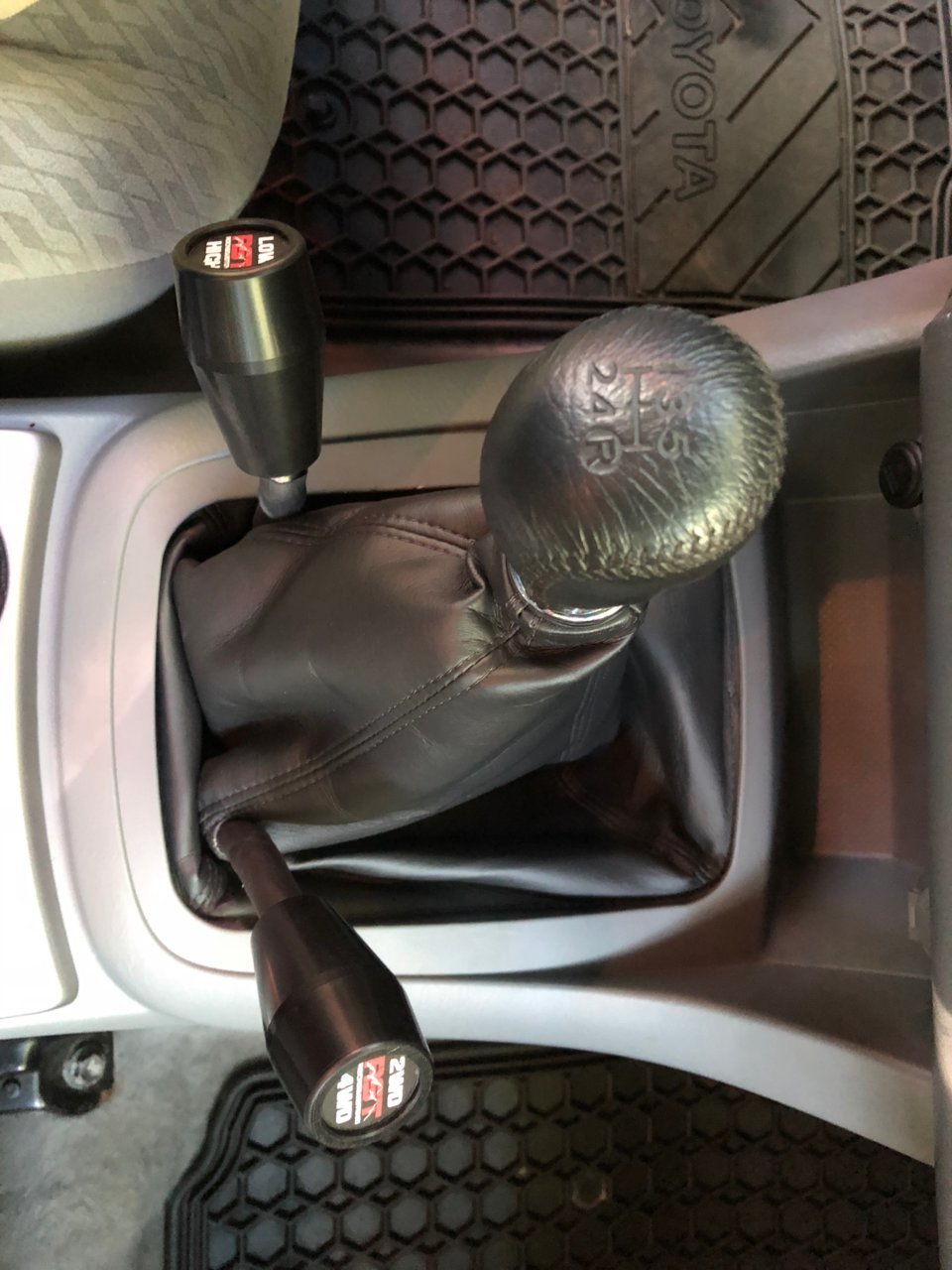

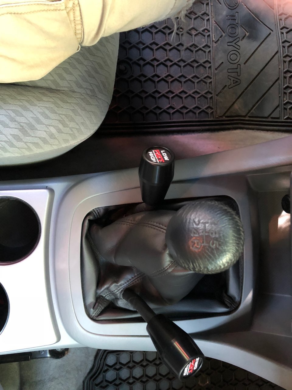

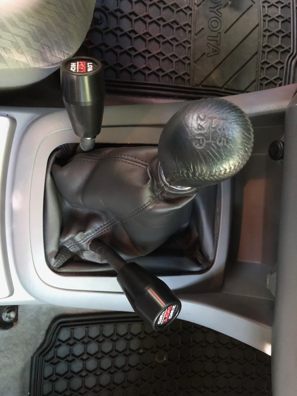

    I’ve included below some pics of the cutaway in the floor and the shifter handles once they were properly bent.
    As the shifter handles come from the factory, they will come up through the opening in the plastic gearshift shroud but you won’t be able to move them. I had to bend the right shifter (2wd-4wd) forward a little bit in order for it to clear and operate within the plastic opening. The left shifter (Lo, N, Hi) is much more complicated. Starting at the bottom of the shifter, you need to bend it to the left so that it will clear the gear shift when in 2nd gear. From there it needs to be bent forward, then come more or less straight up in order to exit the plastic gearshift opening. Then it needs to be angled to the left (and in my case lengthened about one inch) so that Wyatt’s shifter knob doesn’t interfere with the gear shift boot.
    I was able to re-use the factory leather-like shift boot but I had to remove the felt portion that formed the lip around the base of the gearshift opening. Once this felt is removed, you have a much larger shifter boot which allows much more movement. I then put some duct tape on the underside of the shifter boot and punctured two holes for the shifters to come up through. This keeps the gearshift area looking fairly stock, other than the two new sticks!

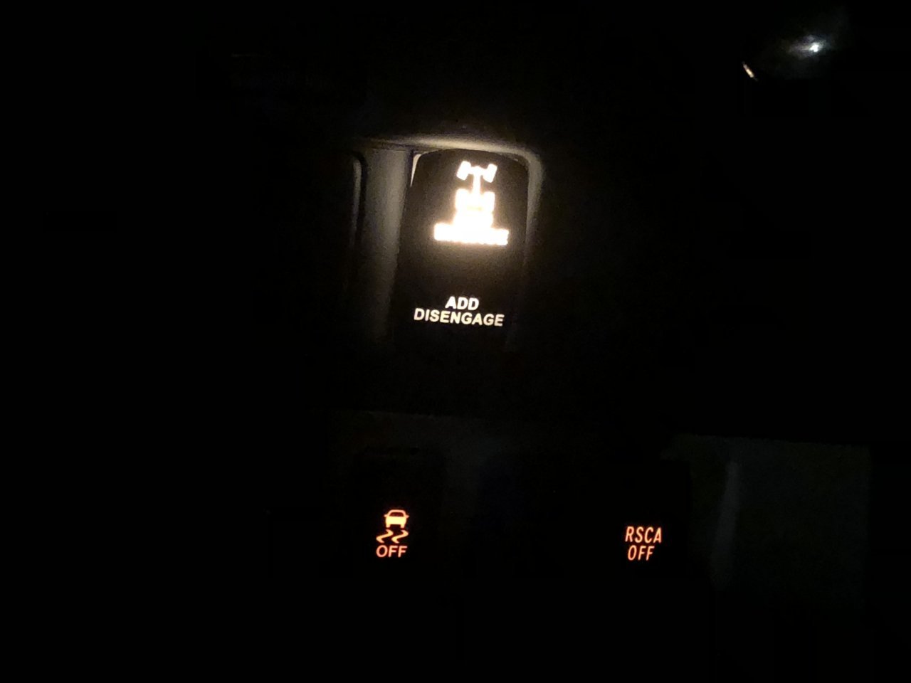

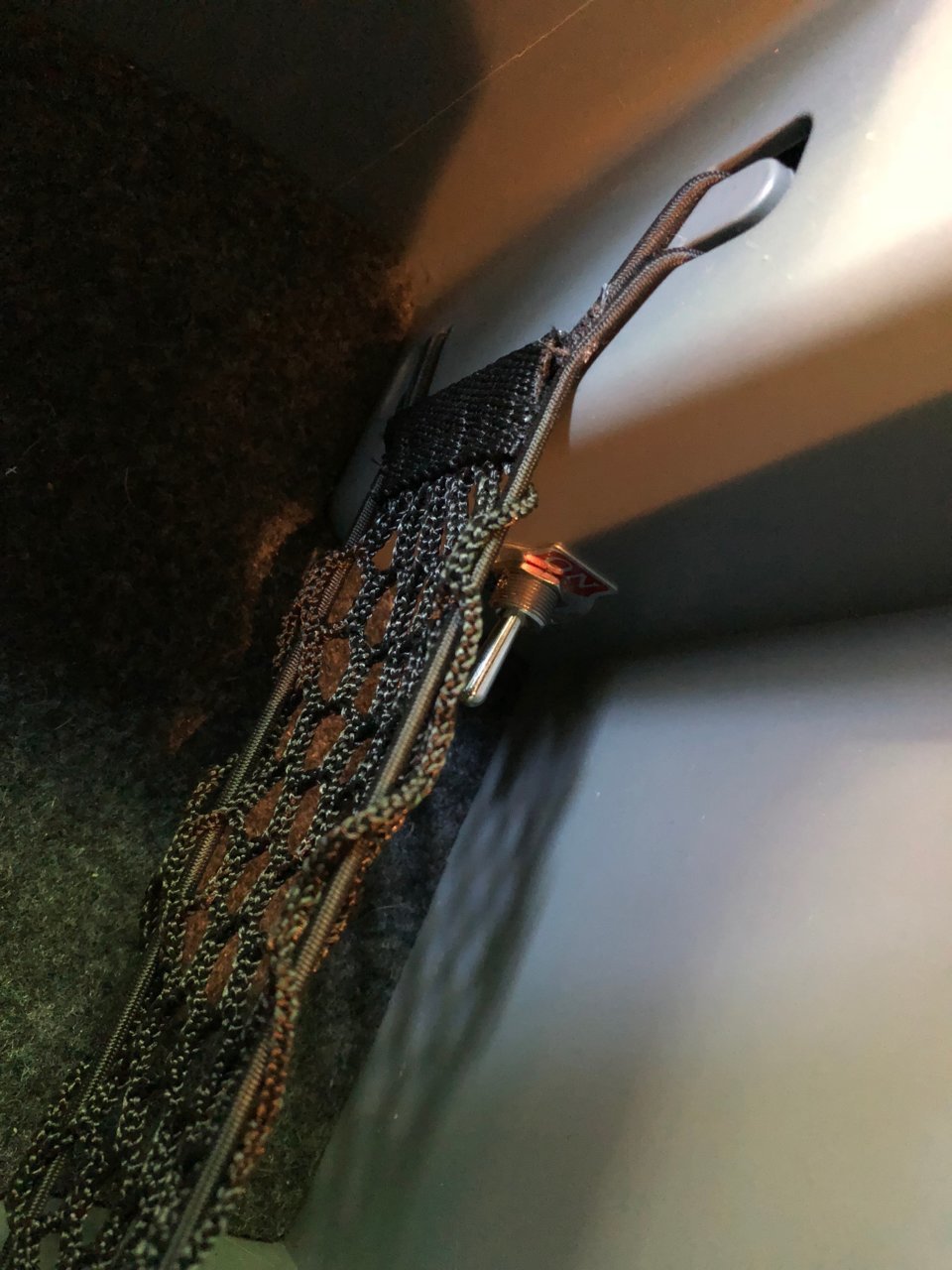

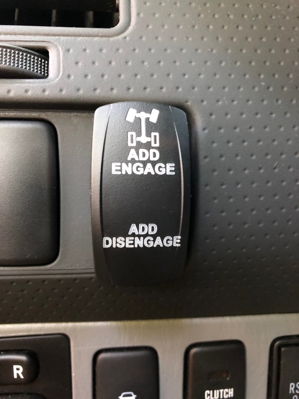

    I ordered a DPDT momentary switch and had RockerSwitch Pros custom make a switch cover for me.
    For the ADD switch, I followed Wyatt’s wiring instructions to a T and it worked almost perfectly. I did need to reverse the polarity at the switch so that the indicator light came on when the switch was toggled upwards, and went off when it was toggled downwards.
    In order to prevent someone from inadvertently sliding the ADD collar without shifting the 2wd-4wd lever first, I added an ADD kill-switch which I hid in the centre console.

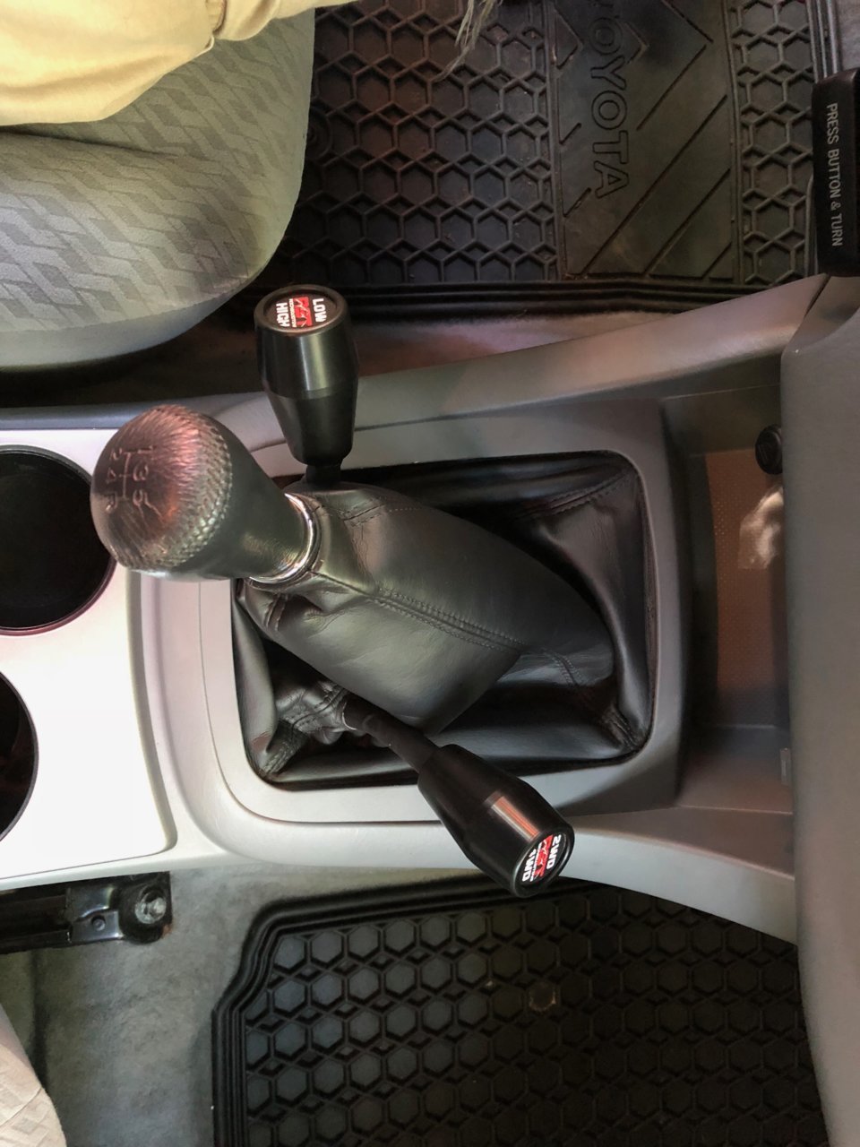

    Some additional pics:
    t-case in neutral and gearshift in neutral, 2wd

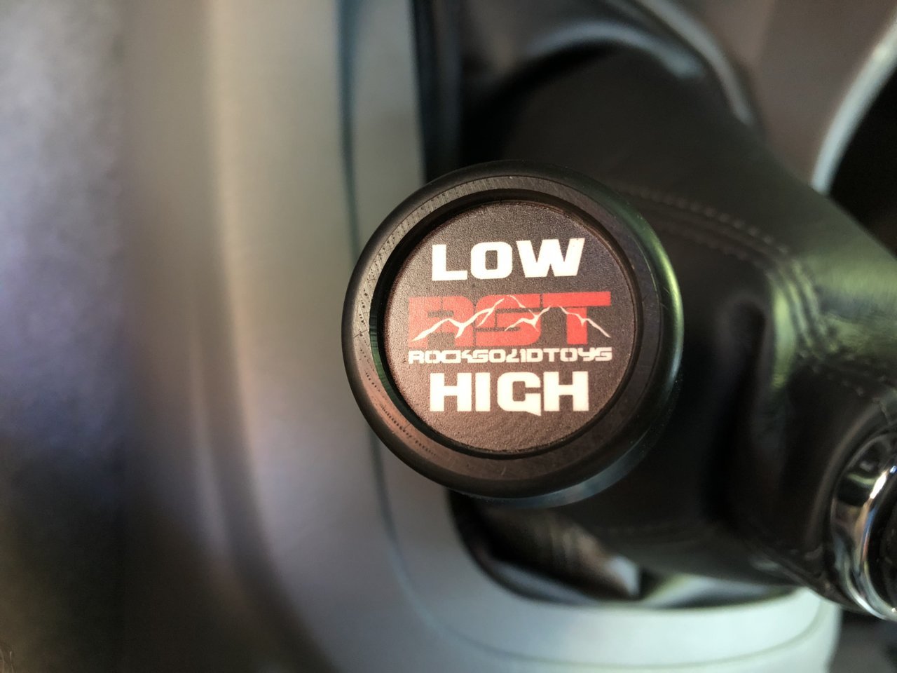

    Range Lever

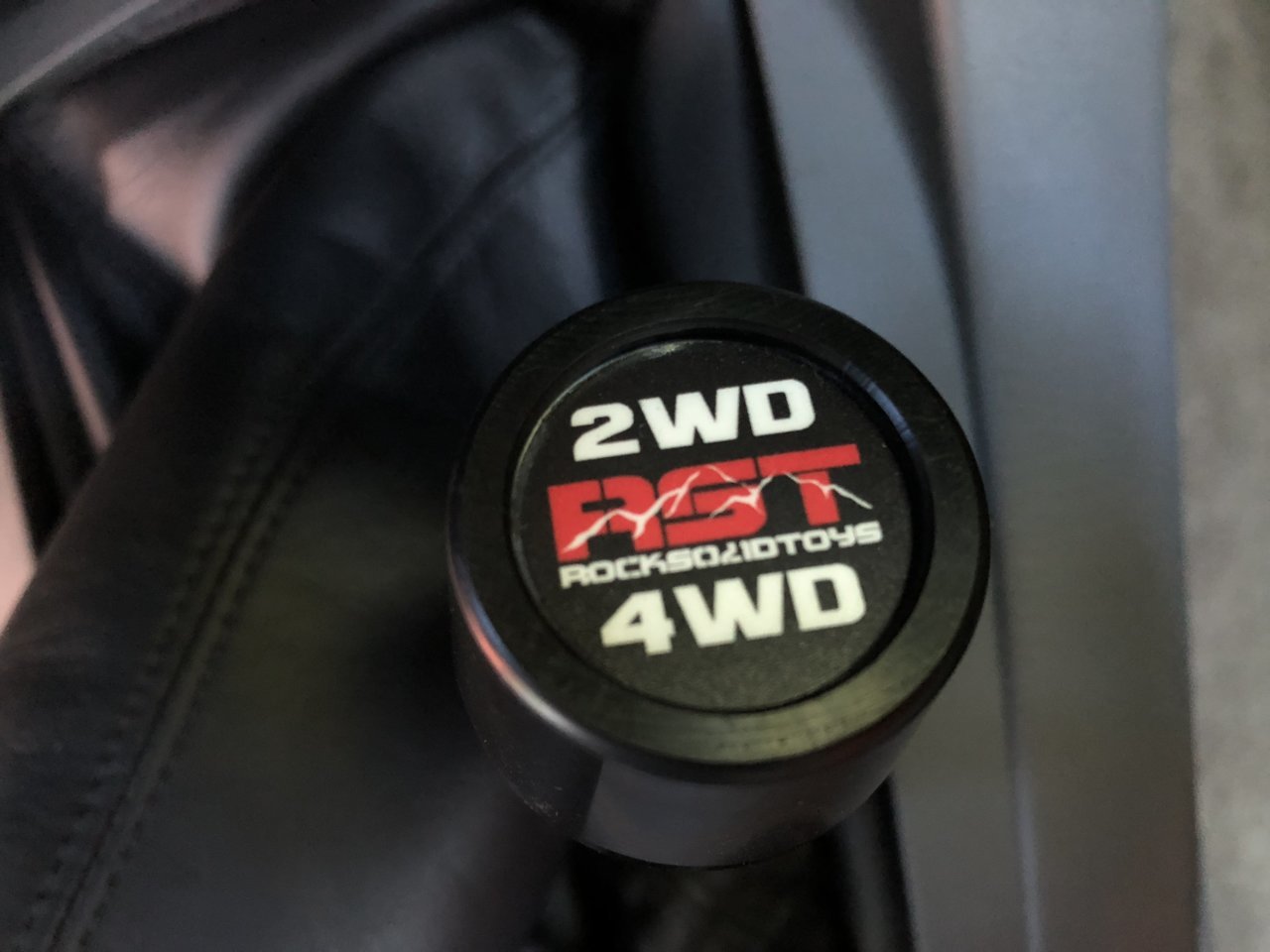

    2wd-4wd Lever
    another view of ADD kill-switch
    normal driving mode, 2wd and high range
    transfer case in neutral, gearshift neutral
    2wd Lo range
    4wd high range

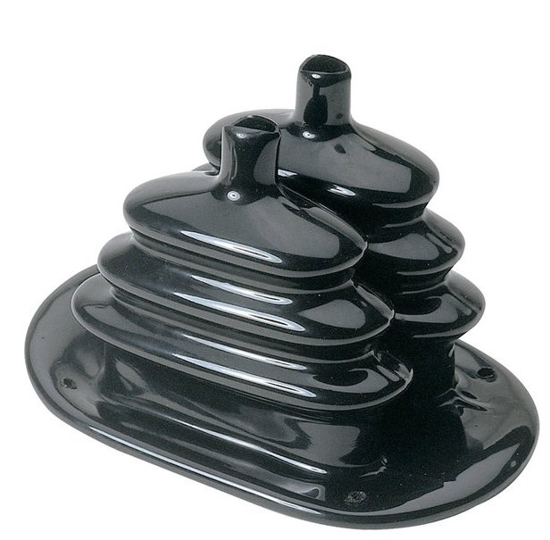

    Here is a pic of the shifter boot I used to cover the hole in the tunnel. I had to put a stiff piece of wire into the bottom lip of the shifter boot in order to expand it outward far enough to cover the hole. I then used 3M double sided adhesive to secure the boot to the tunnel.

    How did you wire up that kill switch for the ADD?
  13. Apr 21, 2021 at 12:20 PM
    Kees
    Kees Active Member
    Mar 8, 2009
    #14464
    40
    Kees
    Southwestern Ontario, Canada
    2009 4x4 Access Cab 4 cyl 5 speed manual
    FJ case swap, twin stick conversion

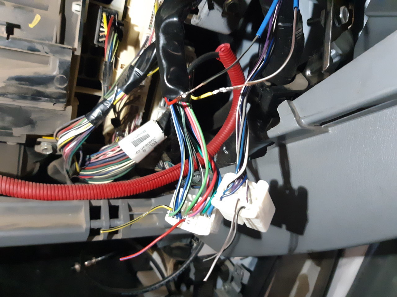

    It’s been a while since I did this swap so I’m just going by memory. Near or above the glovebox there is an electronic module which controls the transfer case. This module is unplugged and no longer used after the swap. Some of the wires going to/from this module are spliced together in order to get the dash lights to work and in order to run wires to/from the ADD switch. I simply spliced in a kill switch to the hot wire that ran from the module (now disconnected) to the ADD switch. Hope this makes sense. My ADD switch is on my dash and my ADD kill-switch is inside my centre console.

    I’m not sure. I got a harness from 12th state for the add. It plugs right into it and I follow it through my fire wall. Has the switch wired to it. I should be able to wire a kill switch to that harness, yeah?
    to my understanding the 4wd ecu is just for the dash lights after the swap basically
