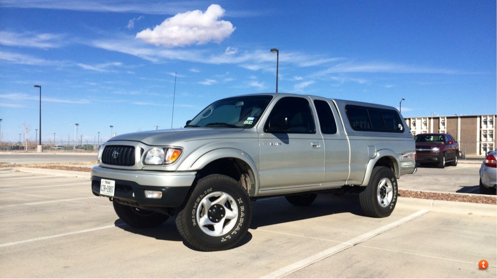

    Are you taking about these wheels?

    You are talking FJ Cruiser Trail Teams wheels??
    Pretty much same offset and back spacing as those stocks wheels you are running now.
    Even with around 3" of lift with ICONs upf front I rub a bit with 285's.
    Forgot to mention, running SpiderTrax all the way around too.

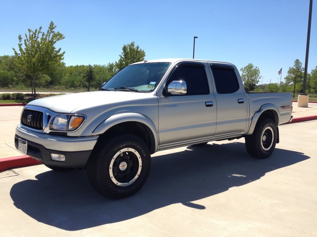

    I'm actually picking up a set of the BLACK TT wheels this weekend from a local Toyota dealer at $648 out the door. I'm going to be mounting them on 265/70/16 Duelers for now as those tires are fairly new. Will update with pics when mounted and give feedback as to any rubbing issues, if any. Bone stock White 02 Double Cab, btw.

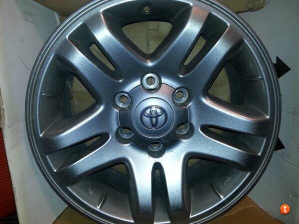

    I'm thinking this may be a better option if I want to stay with a Toyota wheel. Anyone know the backspacing/offset on it? It's an 03-06 Tundra 17x7.5

    they will fit just fine....the backspacing on the newer alloys is about 5", but will work on the 1st gens, which have a 4.5" backspacing on the alloys....if you want, 3/4" bora hubcentric spacers will bring the backspace back to stock,.....265's work fine, 285's will rub without a lift and possibly some trimming...

    Those tundra wheels look really good on silver Tacomas. I believe that they have the same backspacing as the first gen wheels.
