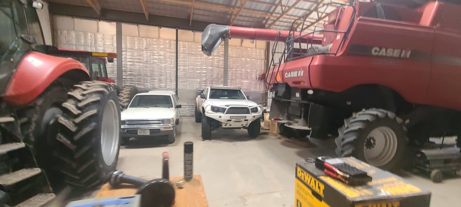

    Looking to regear or get an FJ transfer case so the wife can drive my taco easier. 06 6spd boosted on 35s with heavy armour, light weight fly wheel and racing clutch.... she struggles to get it moving. Curious how easy the fj transfer case shifts from 2low to 2hi while moving. I do this on my 87 yota no problem. Pic for attention.
