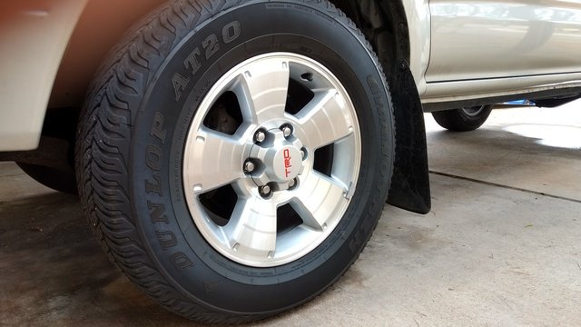

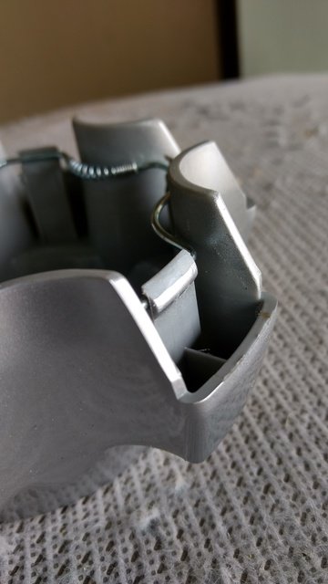

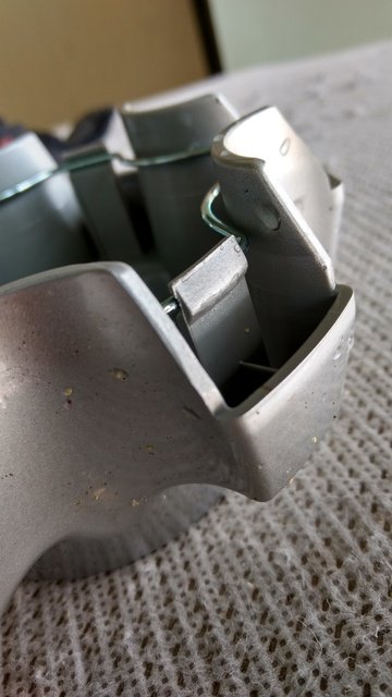

    The caps came in the other day and I snapped them on right away. They seemed to fit okay but it I thought they could fit a little better. It was like they didn't really snap snap in place, almost like they were pushing back a little, if that makes sense.
    So, I took one of the wheels off and took a closer looks at what was going on. It appeared that the tabs on the cap weren't quite seating in the detent in the wheel.
    What I did was file the end of the tabs so they were less of a "wedge" and more rounded on the ends. This seemed to help quite a bit. When I put them back on they snapped in with a bit more positive lock and no push back.
    Before:
    After filing:
    And back on the wheel:

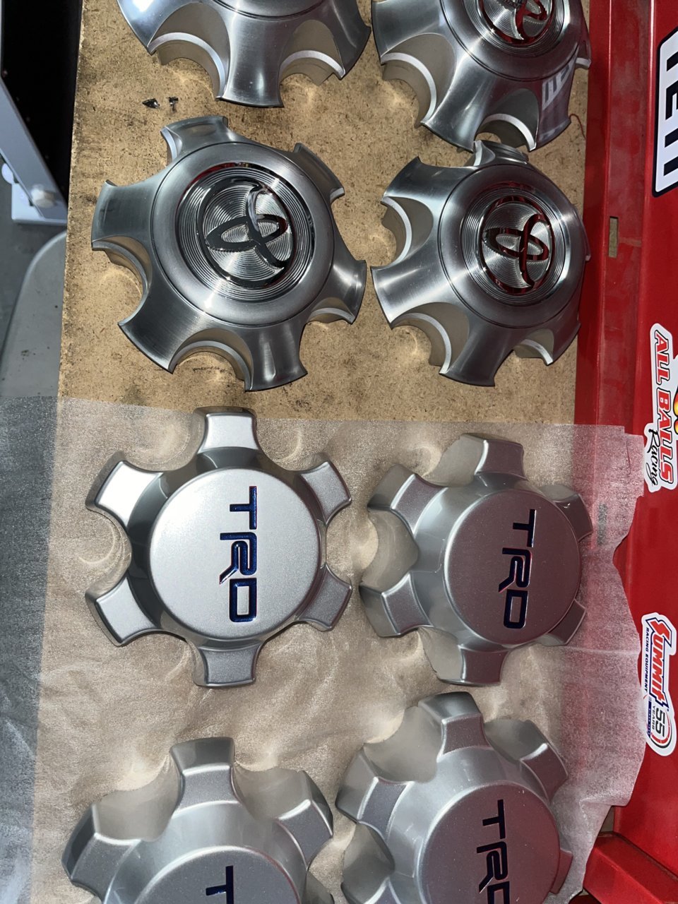

    Just came across this mod and ordered a set of these caps for my Taco. Also, for those interested, TVDVinylDecals.com has colored insert letters for these caps! I ordered a set of dark blue so it matches my truck.

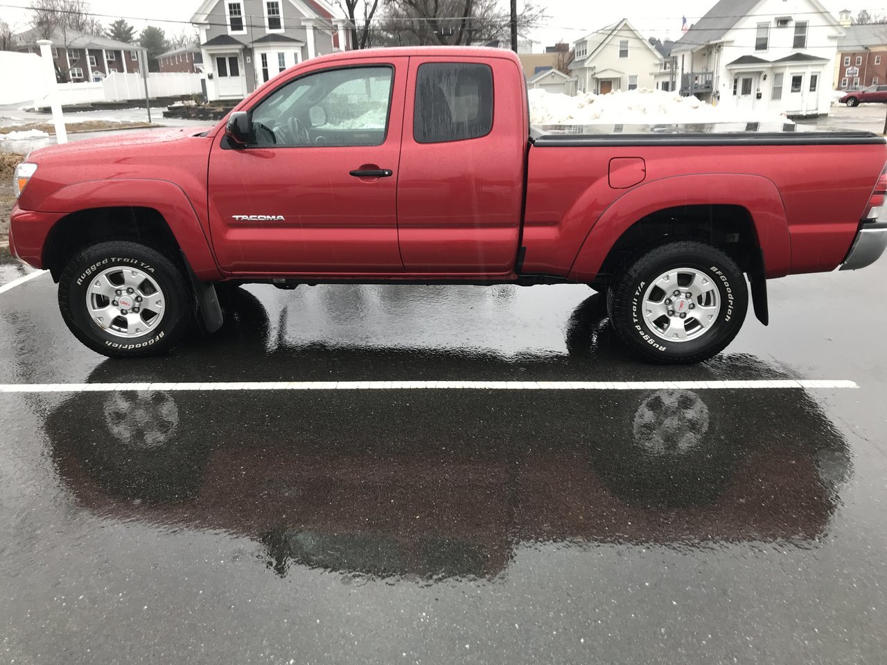

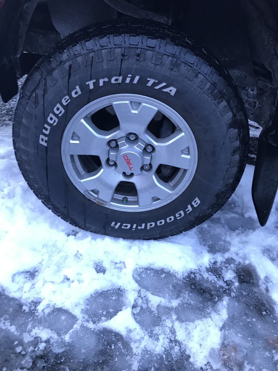

    I have the FJ TRD Centercaps on my 2010 Taco - see photo. The unmodified FJ caps have been on my Taco about 13 years and no issues - until.
    About a couple weeks ago, a couple days after a slight snow storm the right rear cap popped off when rounding a right turn corner snow bank. I did not notice it missing at that time, just a very slight wheel bump on the snow bank in the right turn. Several hours after arriving home, I noticed the right rear FJ Centercap was missing. Took me some time to come to the conclusion that the cap bumped the snow bank in the turn, causing it to pop off. Needless to say the next day I stopped by the local dealer, Bristol Toyota and ordered two new FJ Caps. (You gotta have a spare.) The parts manager commented on how inexpensive they were. Needless to say, years ago I recall the unmodified FJ caps did not fit as snugly as the OEM caps. But, lazy me, I thought it was "good enough". Now I will modify all four as you described. Lesson learned! - JB
