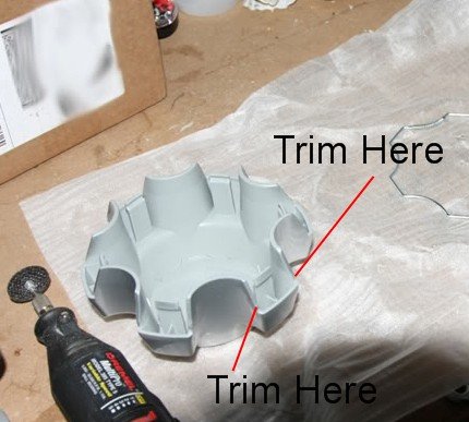

    I find that with the 17" sport rims it is true that you do not have to do the cutting. I did find that they fit better if you trim a little off the edges shown in the picture. Do it for all 12 edges.
    When you test fit the cap before you cut you will see where the edge hits.
