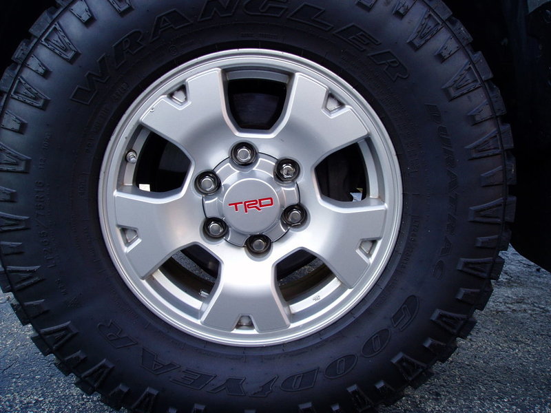

    Well i got my 4 today and spent 2 hours messing with one . cannot get it to fit,no matter what . I have 3 still wrapped any takers?

    How much material did you cut off with the dremel tool, maybe you need to cut a little more.

    Ay chance you can show a picture of them AFTER you cut off the pieces that have to be cut? They can be a bitch to get on the first time.

    my wheels look just like yours but i have already broken one tab. Im gonna take a rest and try again tomorrow. maybe grease them up a bit i will let you know and post some pics

    Hope this helps you out on the install. I used the spring retainer from my old caps in the FJ ones because they are thinner, I also left the spring retainer loose inside the cap and they pushed in pretty easily, after they were in place I reached in from the back side to pull the retainer in the lock tabs.

    When I was installing mine for the first time, I kept a thin straight screwdriver handy. I used it to press a few of the tabs in to where they cleared the machined boss inside the rim. I also used a bit of dry slide lube. I broke 1 tab on 2 different caps. But they haven't caused any problems once in place. Since then, I've had the caps off and back on 3 times. By the second time, they would almost fall in place. Once you have 'em on, you'll forget all about the difficulties. They look so damn good! A little secret for anyone else thinking of ordering these.....Buy 5, and don't panic when one breaks. And now I have a spare.

    Try warming up the tabs a little with a hair dryer. It should make them a little more flexible and less likely to break.

    Well I tried it again this morning after reading some of the rips you guys gave me and success! At least with the first one . I have to go get some more dremel discs but the hairdryer and the small screwdriver really did the trickimage.jpg
