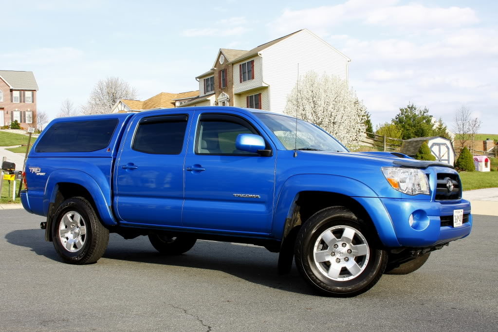

    I just put a set of FJ's on my Taco with the 265/70R17 Dunlop stock tires still on them. They were a direct bolt on, no lift or trimming required, and they used the stock Taco lug nuts.
    Here's a pic:

    Did you get your set from the dealership? I was hoping the Gunmetal set would come with matching lug nuts if I can order them from the dealership.

    Nope. Won them on ebay. Tires and wheels were $112. :) No center caps though, and I had to drive 6 hours each way to pick them up. It was all good though. In the end, I sold my OEM Sport rims and actually made almost $200 on the deal after all expenses were covered. :D
