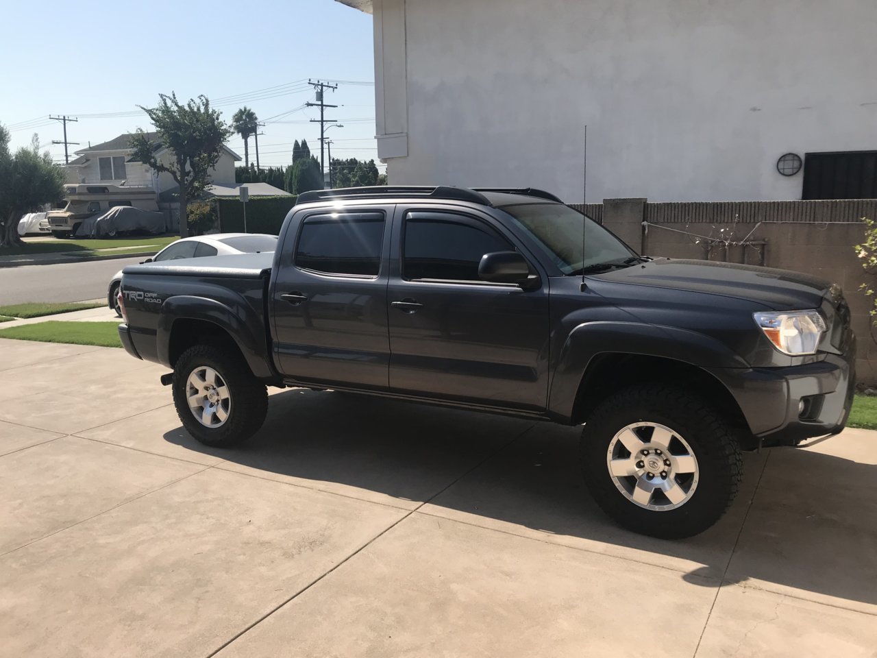

    They fit with zero rubbing. TPMS swap right over too, but do require a rebuild kit.
    DANGERMONEY[OP] and BassAckwards like this.

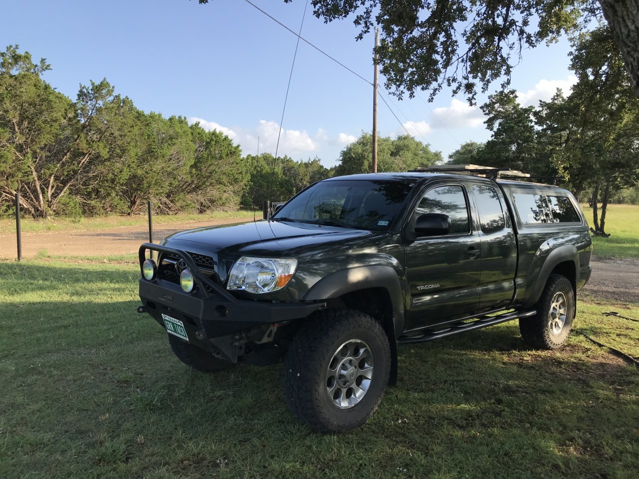

    Im running FJ 17s as well and i havent had any issues. Like others have said, they are a +15mm offset, but they work great. Same lug nuts as TRD OR and TRD sport wheels on mine
    SocalTaco15 and DANGERMONEY[OP] like this.

    Thank you for the replys and great pics!
    BassAckwards likes this.
