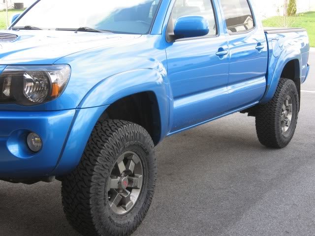

    I think Delmarva is sporting FJ wheels

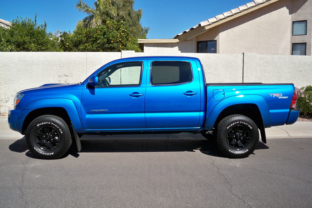

    here are a black set on my truck;

    They are nice!

    they might be...
    I know there was a set of these (rugged trail black bajas w/ ruggedfails) on an FJ at the dealer when I went and drove one.

    I'm digging these...
