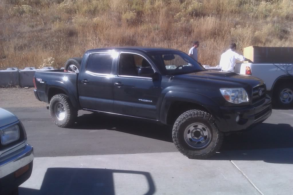

    There is one guy on here running older 15" wheels on a 2nd gen. He had to use a spacer.... let me see if I can find it

    I will also point out that those wheels are only 6 inches wide, kinda limits tire selection and as Troy pointed out, you need a spacer to clear the caliper...seems like a lot of trouble to make it work. Do you just like the look? Why not get the same style in a size more appropriate for the truck?
    The fj wheels are also 3.25" bs if that means anything to ya
