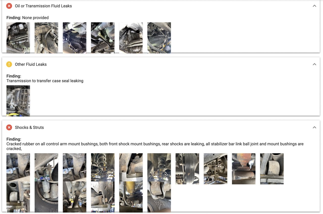

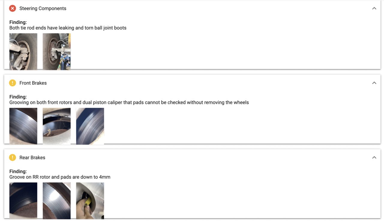

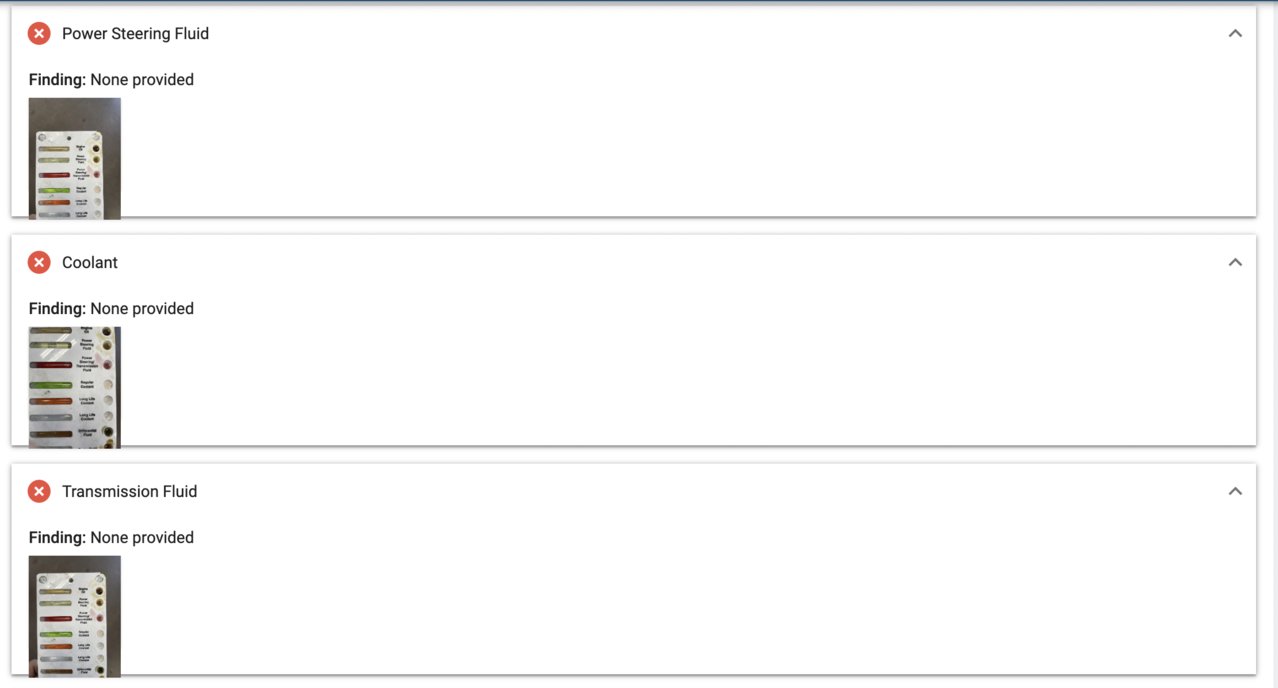

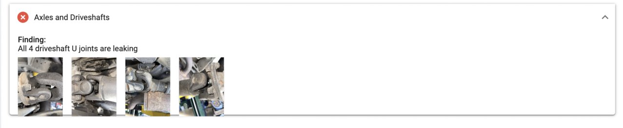

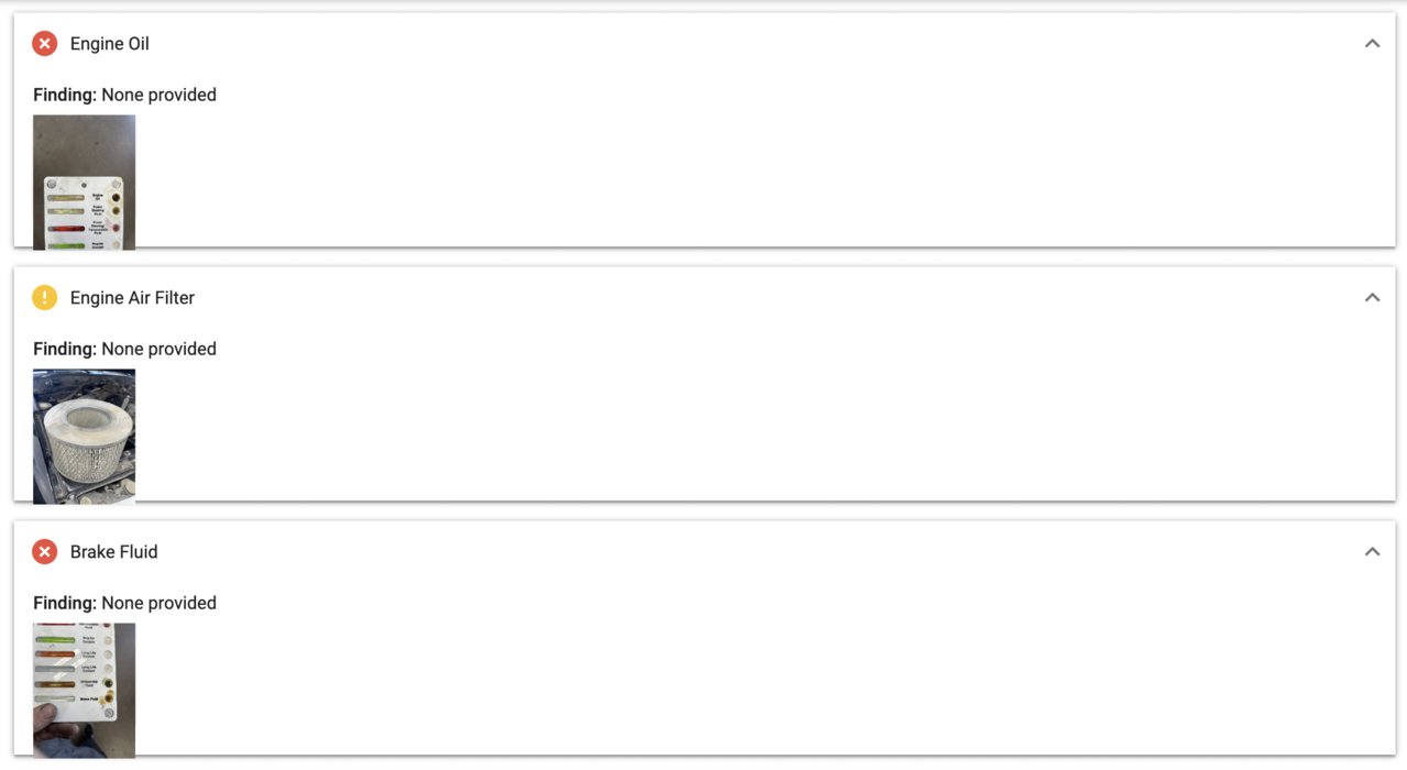

    Ok below is a better organized view of all the issues they found. Sorry for the repeat.
    Oil:BrakeFluid.jpg Ps:Coolant:TransFluid.jpg Leaks:Bushings.jpg Steer:Brakes.jpg UJoints.jpg

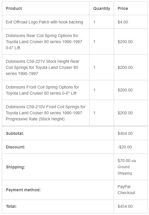

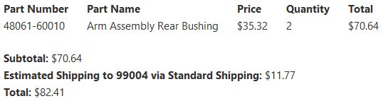

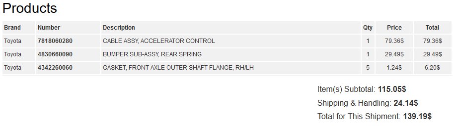

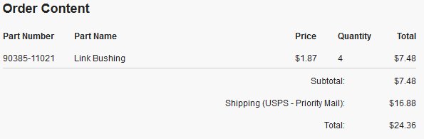

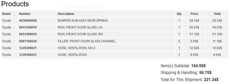

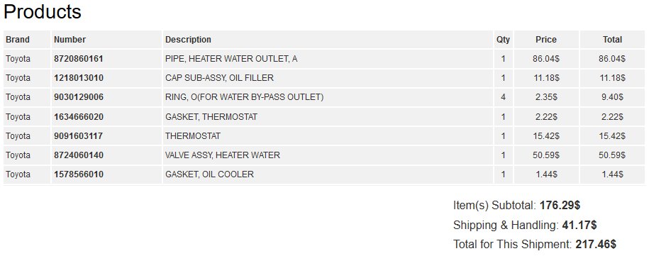

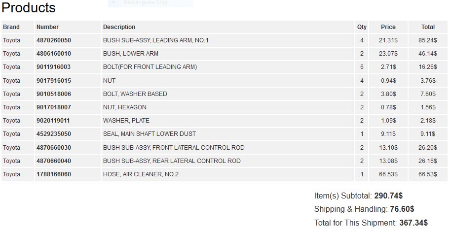

    @Ozark_RegCab I don't always throw in maintenance (fluids, brake pads, and whatnot) But these are receipts for parts I've purchased for general upkeep in the past year. Every other year follows a similar trend just different parts obviously. There are places you could skimp or just not fix, but I choose to keep everything as nice and new as possible.
    I can't find the receipt but I know my steering joints cost $95 shipped all together and the new steering stabilizer was $85. The new shocks all around were $30 a piece.

    Hmm ok so it looks like around $1500 in parts if I wanted to tackle it all at once. I'd probably start with the engine/cooling related PM first and leave the suspension and brakes for later. It wouldn't be a bad idea to change the fluids for the diffs and transfer case either I imagine..
    Also none of the installs seem that hard with basic tools, except fot maybe the spring install.. are there any on there you'd say are a big PITA?

    Just out of curiosity, do you think FZJ80s will keep appreciating like over the past two years, or will it go down with the rest of the used car prices? Some people over on Mud told me the whole LC market is a passing fad, especially for >200k mile examples. Not that I'm seeing it primarily as an investment, but it'd still be good to know.

    Why was the radiator replaced? It could be that there was an overheating event and this may have caused a head gasket failure.

    Apparently their mechanic just told them it was in bad shape and would have to be replaced.

    So despite discretion being the better part of valor, I did in fact end up getting the truck..
    I hear all the warnings about getting into a moneypit, and maybe I overpaid at 8k, but I felt like this was my one chance to own a solid axle LC, and I'll just have to live with the consequences of my decision.
    I picked up an extra shift as a research assistant, and I plan to use that extra 500 a month solely for PM and "restoration." I'll start with the brakes and cooling system and go from there.

    Good luck with it and welcome to the club! Brakes just use blanks and good pads, flush with high temp synthetic fluid. Get the best aluminum radiator you can afford and use Toyota red fluid, new hoses, OEM thermostat. Download the FSM from the Mud forums. It will prevent guessing. Search a lot on the Mud forums, it will save time posting something new.

    It's less Tacoma and more mod
