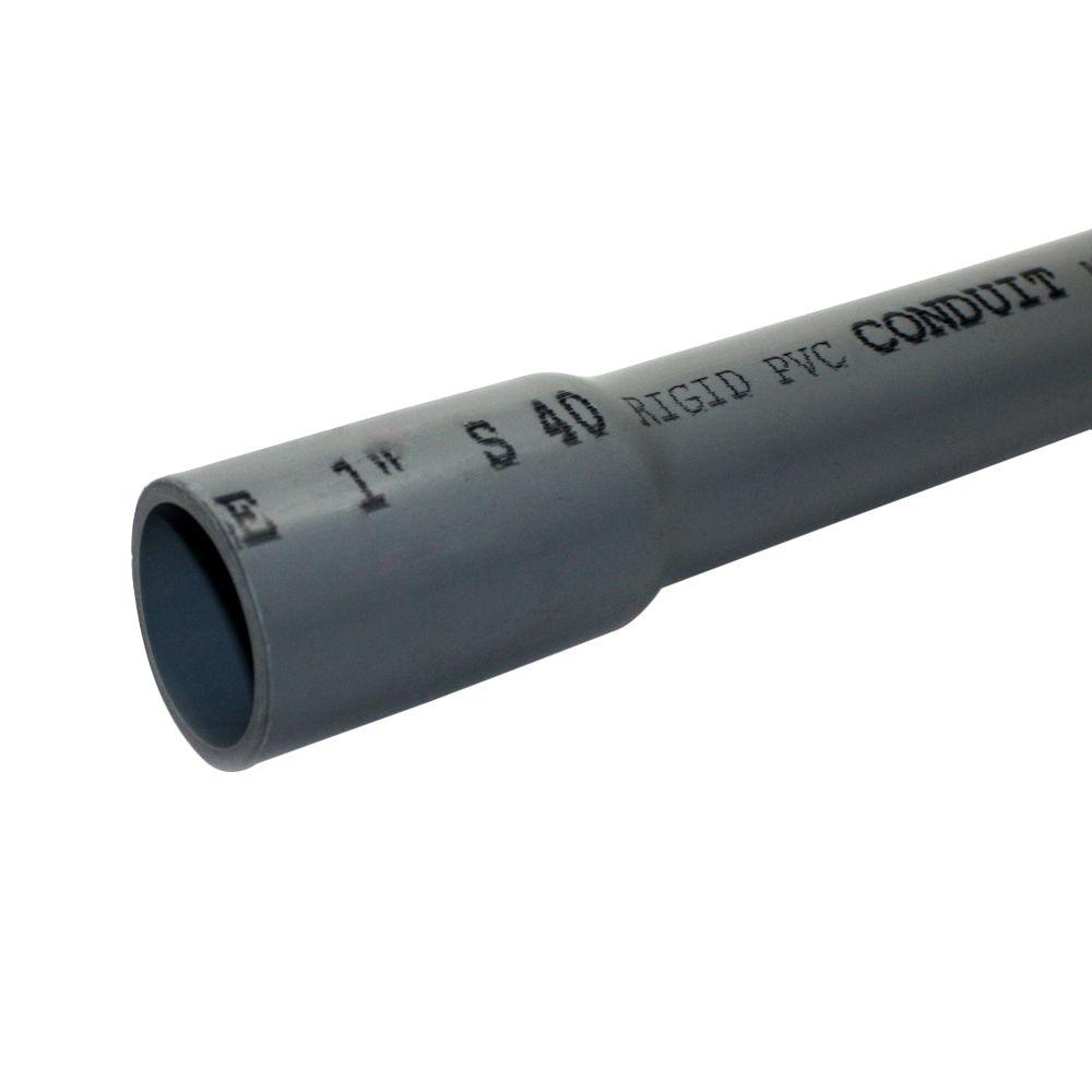

    Where the pole meets the concrete has a flare like this.

    Is the pole flared, or is it a cover. If the cover pops up, there may be a pin or bolt under it to lock the pole in place.

    Flared. No flashing plate or anything to obscure a cross pin, etc.
    Looks exactly like this, except vertical. Goes to almost flush with the concrete. It is in a ground sleeve, but I can't tell of there is a threaded base potion of pole or something inside of said sleeve.
