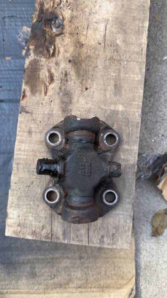

    guys was doing my driveshaft today hitting out the u joints and the hub thingy cracked i can’t find any part number anywhere at toyota or anything. if anyone can please locate a flange yoke spicer that goes to the diff in a 2006 tacoma 4x4 it would really help.
    toyota said i have to buy the whole shaft for $1800….

    Drive Train America Toyota Dana Spicer 1330 $58 bucks. You can find it cheaper most likely but don't get some off brand POS either.

    says out of stock man fk how would i be able to tell if it’s an off brand pos

    Just make sure it's an actual Dana Spicer manufactured one, not one made by ChingShung plastics, chemicals, twine, and metal company.
    One of the bigger companies like Summit Racing will have one, Rock Auto might but you also need to be careful about who made the part. You can do well there or get burned.
