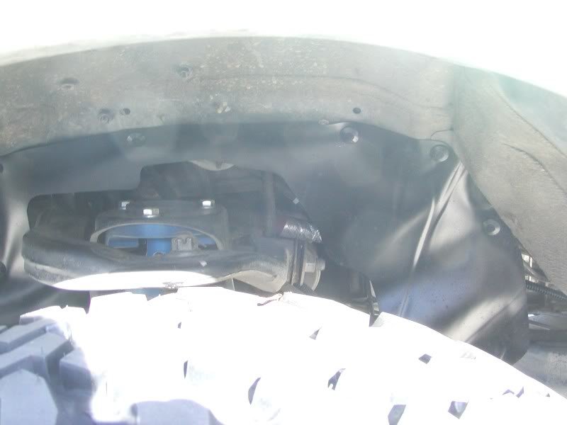

    There is a flap in the front wheel wells, that I'm assuming is to protect the engine compartment from debris kicked up by the tires. How important is this flap, what is it actually called and where can I find another? I've attached a picture of what I am talking about. Any input would be greatly appreciated! Thank you!

    Doesnt look like you need a new one so much, just another clip to hold it in place.

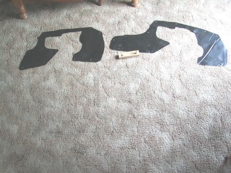

    After installing a 1" BL... all my engine bay liners came up short...
    so I got some Pond Liner from Home Depot... and made my own

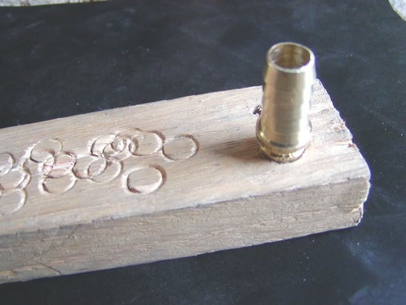

    a hole punch and a block of hardwood comes in handy...

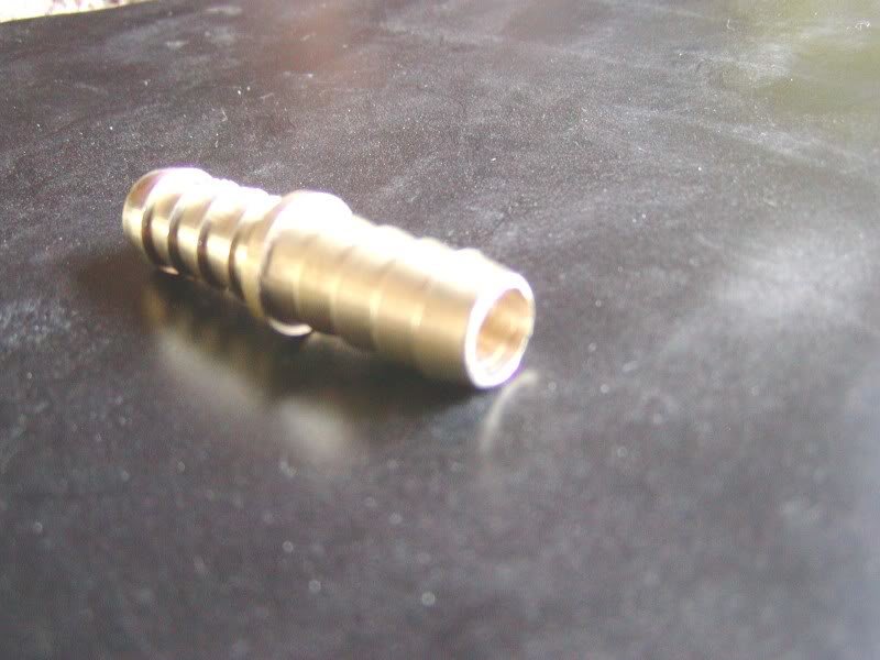

    I made my own hole punch from a brass fitting I had laying around

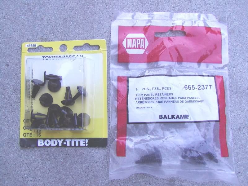

    can pick up the retainers at any parts store. i sell them at carquest/advanced auto parts for like 20 cents a retainer.
